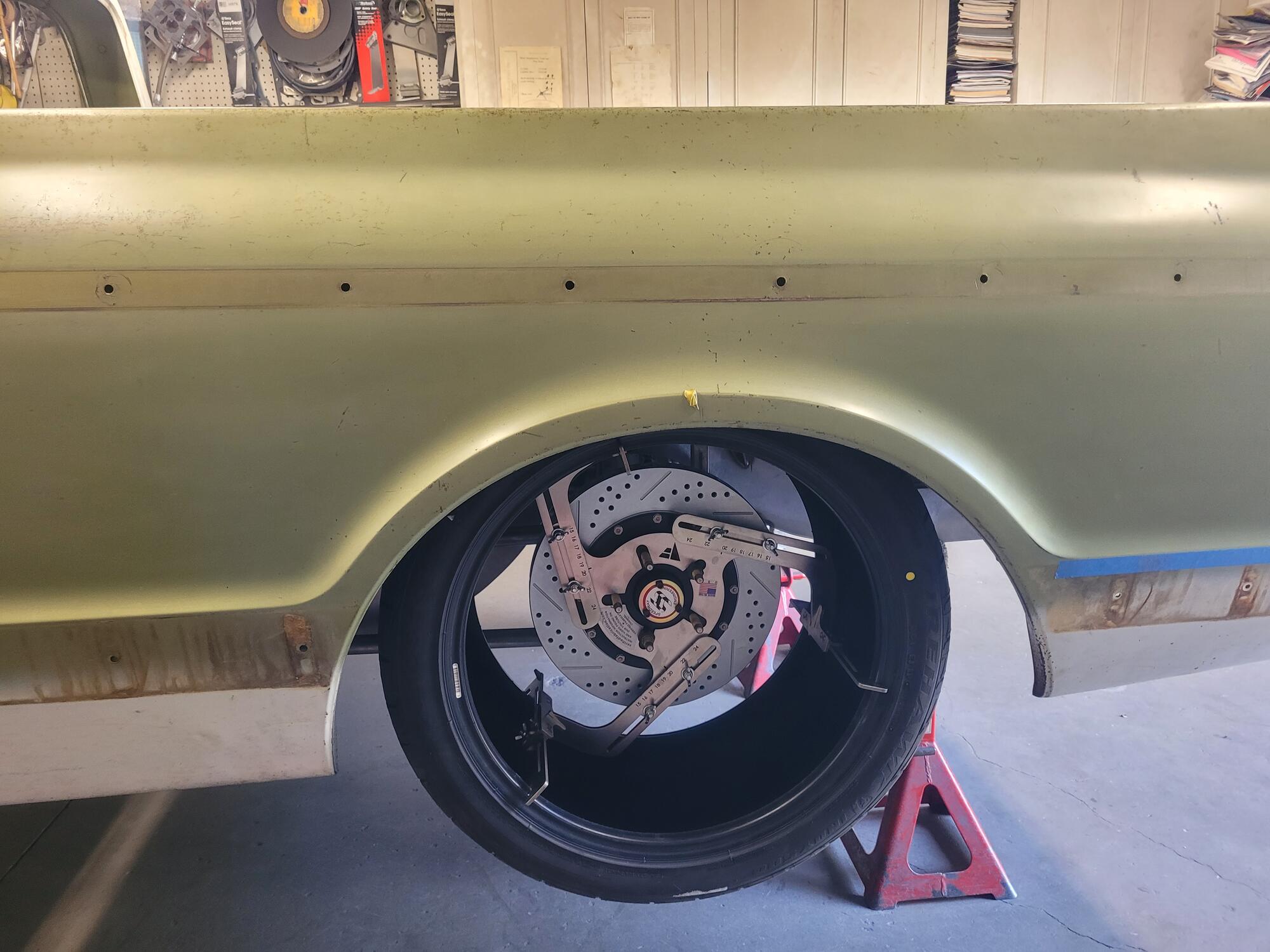

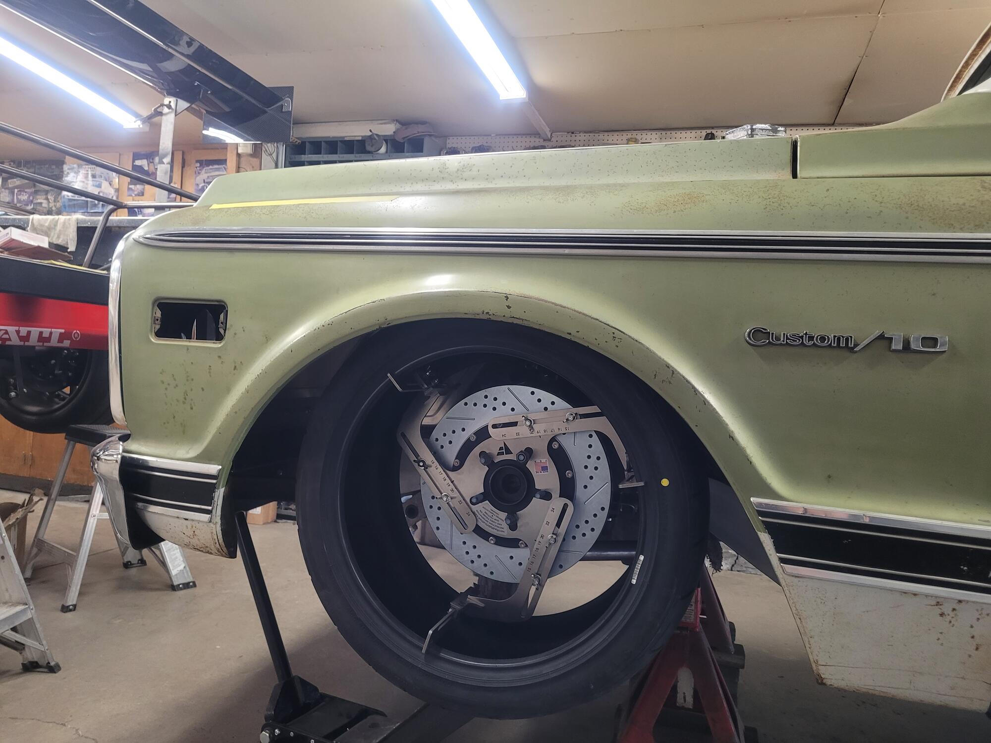

      Wheel Fitment
      Nice and Low, 5 inches at cab to ground. Name:  20220902_091544.jpg
Size:  236.5 KBName:  20220902_093729.jpg
Size:  265.5 KBName:  20220902_093736.jpg

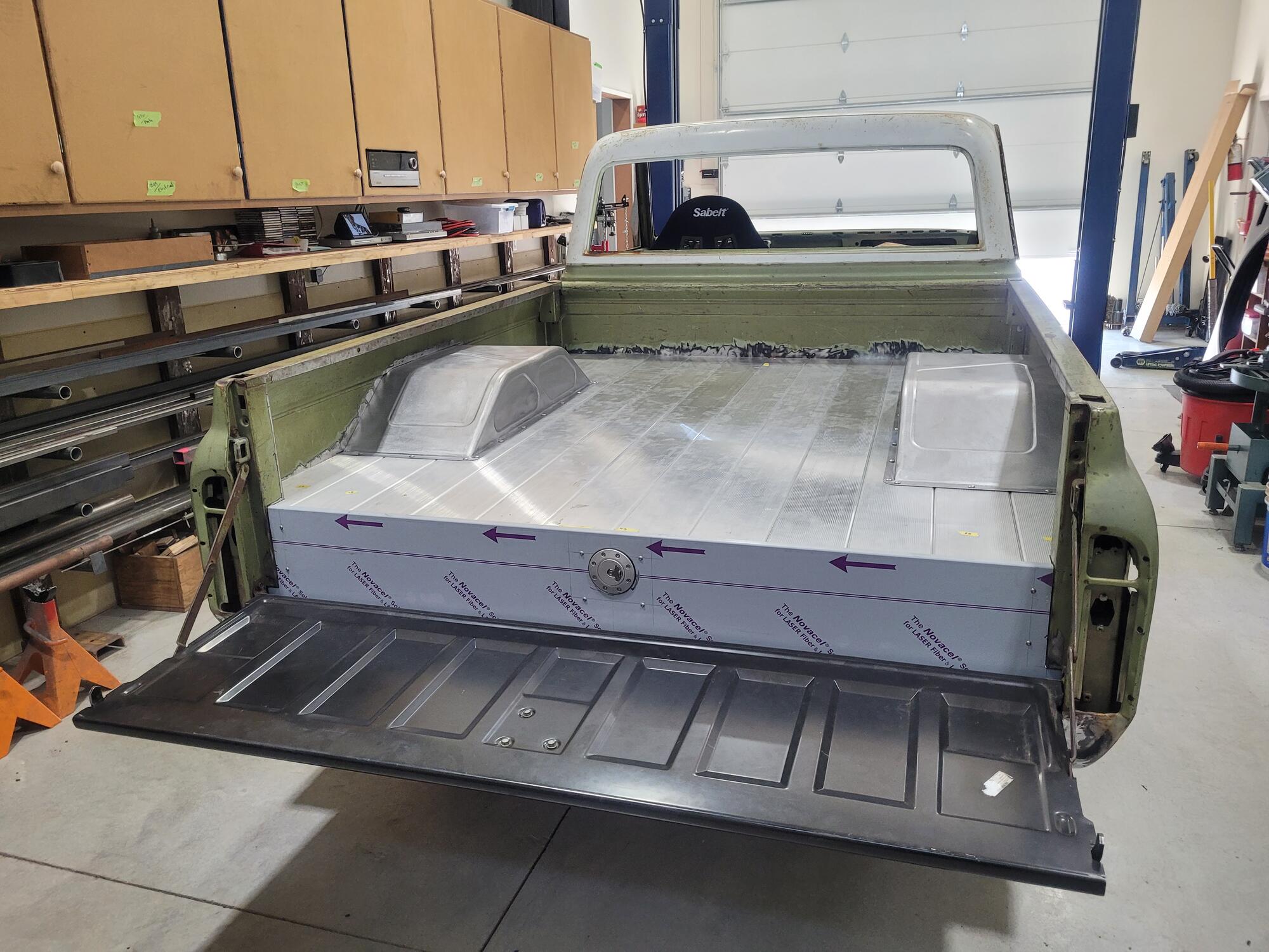

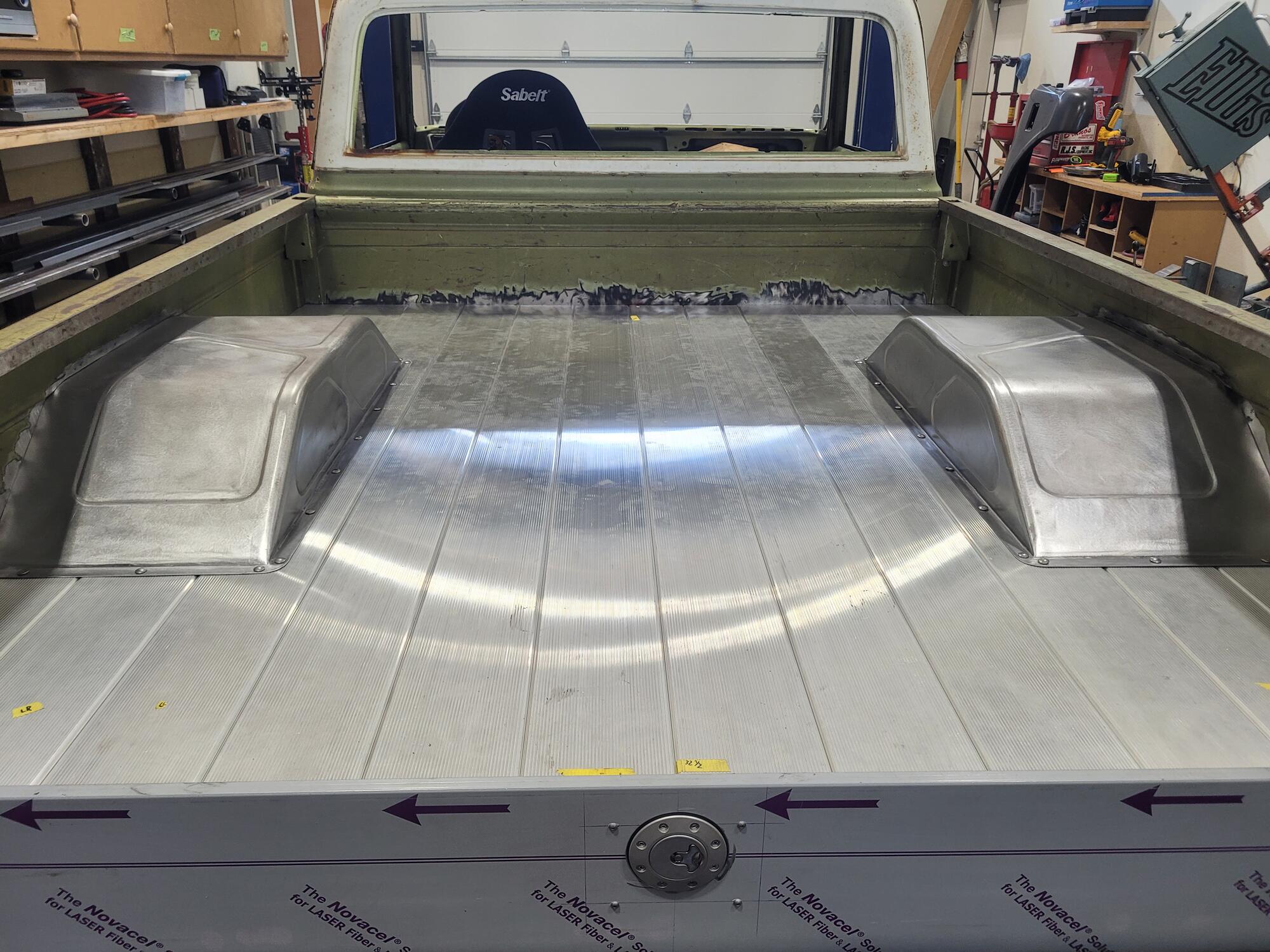

      Bed Wrap Up
      I think it turned out pretty sweet. Will powder coat decking down the road.
Size:  340.3 KBName:  20220902_122815.jpg
    4. #44
      Mountain Springs, Texas
      4,865
      Awesome. What is that you are using for the bed?
      Don
      1957 Buick Estate Wagon
      1959 Apache Fleetside
    5. #45
      Apr 2019
      Louisville, Kentucky
      23
      Same question, what did you use to make the bed floor? I raised my bed floor 4” and also used stainless for the filler area below the tailgate. You do have an awesome build!
    6. #46
      Oct 2017
      Oregon
      154
      Bed Material
      The bed is Aluminum Bed Decking, mostly used in enclosed trailers. The attachment is all blind underneath. Kind of pricey and a bunch of hours but it turned out pretty cool.

      Oct 2017
      Oregon

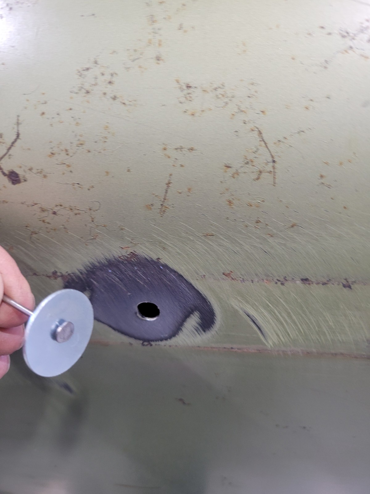

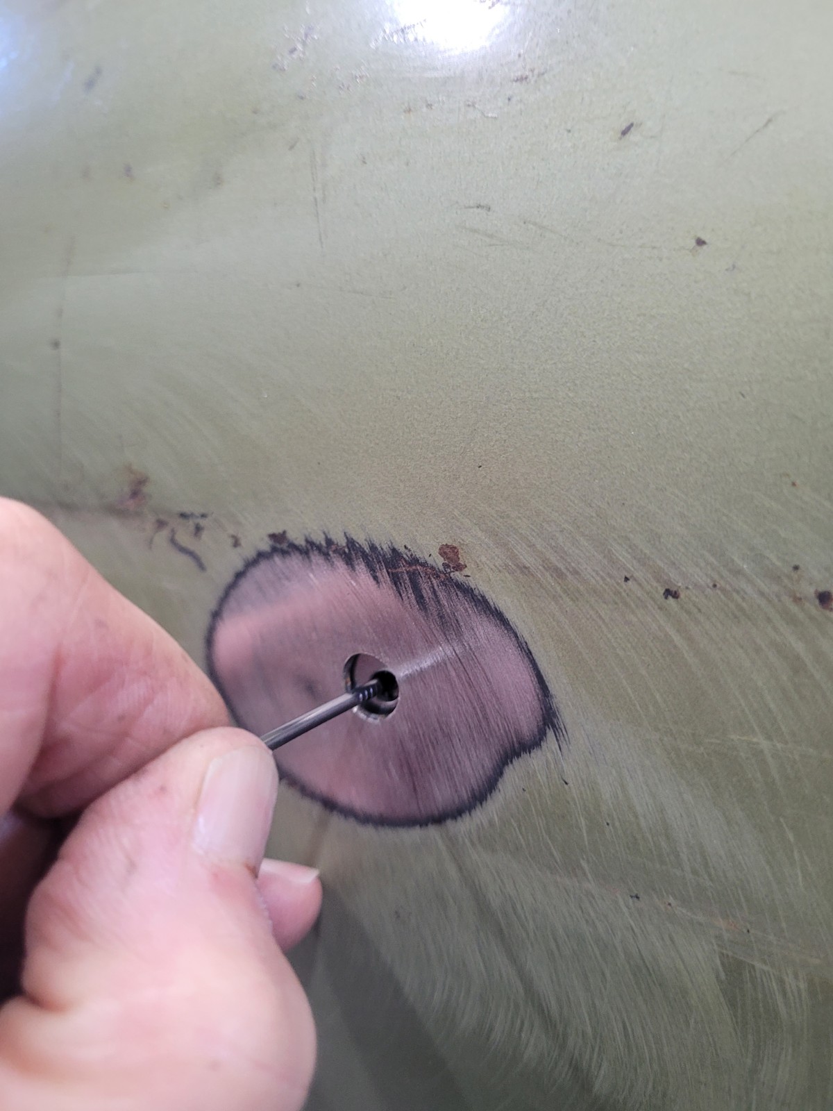

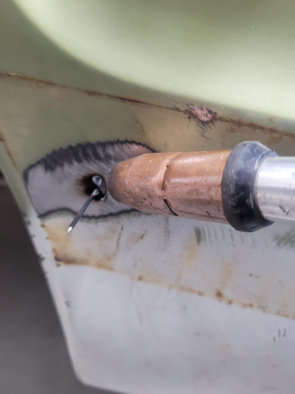

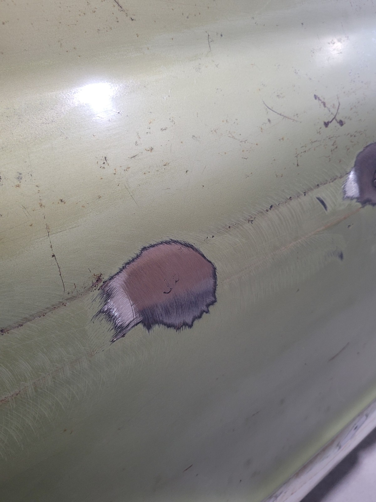

      Molding Hole Patching
      I saw this trick on You Tube. Really cuts down on heat needed.

    8. #48
      16,126
      Nice! Then use a slide hammer?
    9. #49
      4,865
      I would be concerned about moisture collecting between washer and body panel. I make an exact size plug and attach a stud to it with a stud welder. Or just use one of these as a backer and weld it up.
      https://www.ebay.com/itm/15301073625...Bk9SR8jok-HnYA
      Sorry if I misunderstood your method.
      Don

    11. #51
      Oct 2017
      Oregon
      154
      Quote Originally Posted by dhutton View Post
      Don
      I thought about that and see your point. I didn't see how this would act any different then the multiple overlapping seems with spot welds on the pickup, besides my cars never see the rain Anyone who has worked on C10's knows what factory rust buckets they are.

      Quote Originally Posted by jschmidt97306 View Post
      I thought it was material from bleachers. Looks like the seating at a high school football game. Not trying to offend but, that may be the same material.

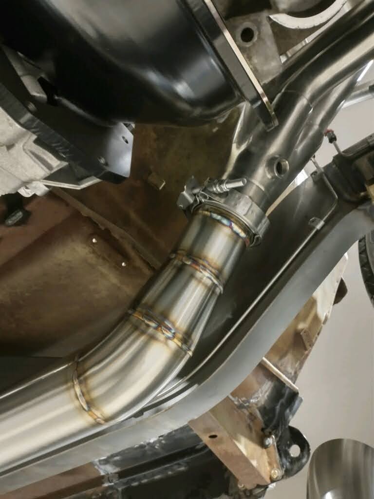

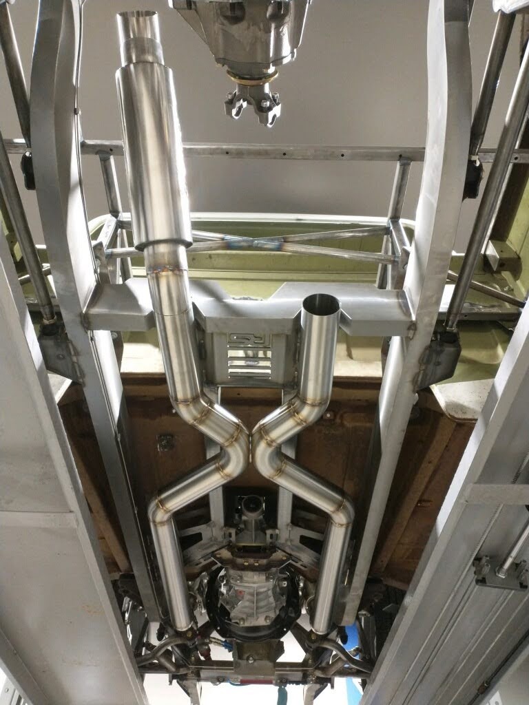

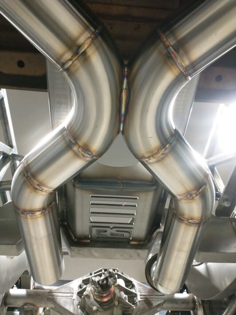

      Stainless Exhaust
      Some beautiful work by Derrick on the 3 1/2" system. #Dimestack_Derek He can stack dimes!Name:  imagejpeg_0009.jpg
Size:  82.6 KBName:  imagejpeg_0010.jpg
Size:  120.2 KBName:  imagejpeg_0011.jpg
Size:  72.4 KBName:  imagejpeg_0012.jpg
Size:  136.5 KBName:  IMG_20221123_145057116.jpg
    14. #54
      16,126
      That's a beautiful exhaust system!

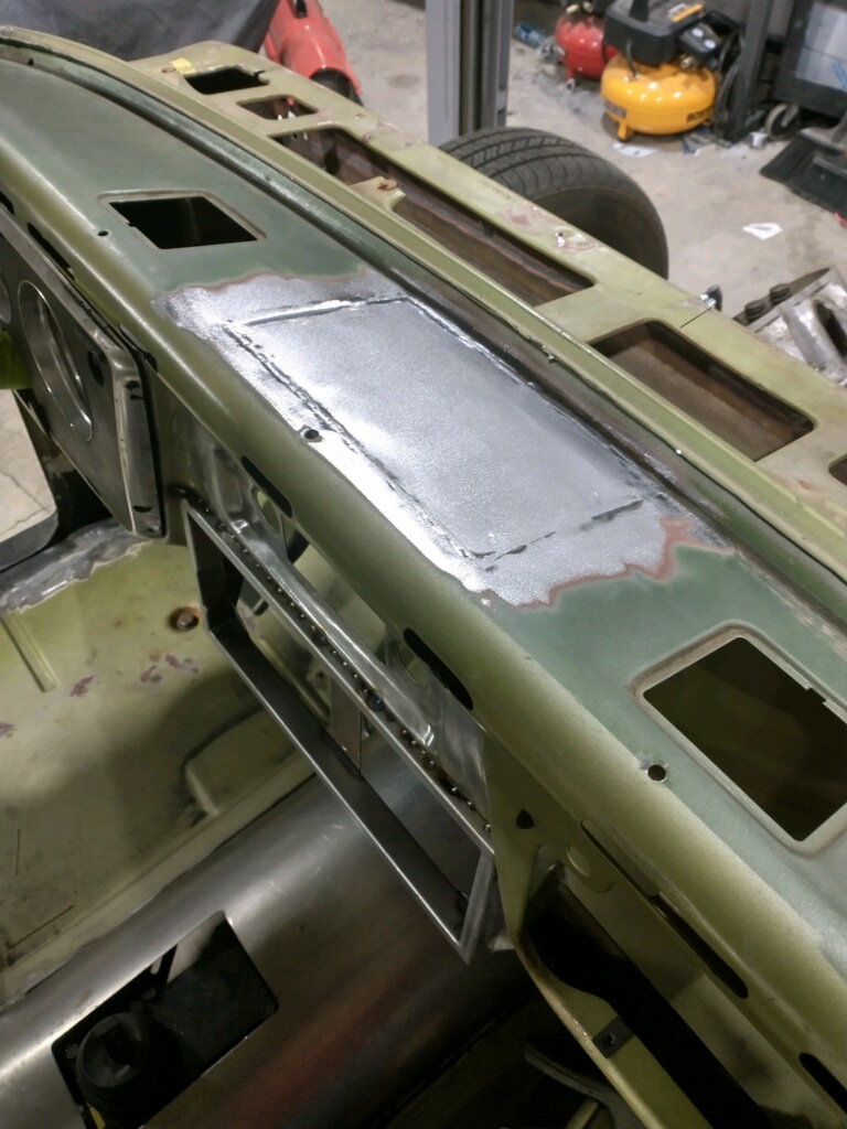

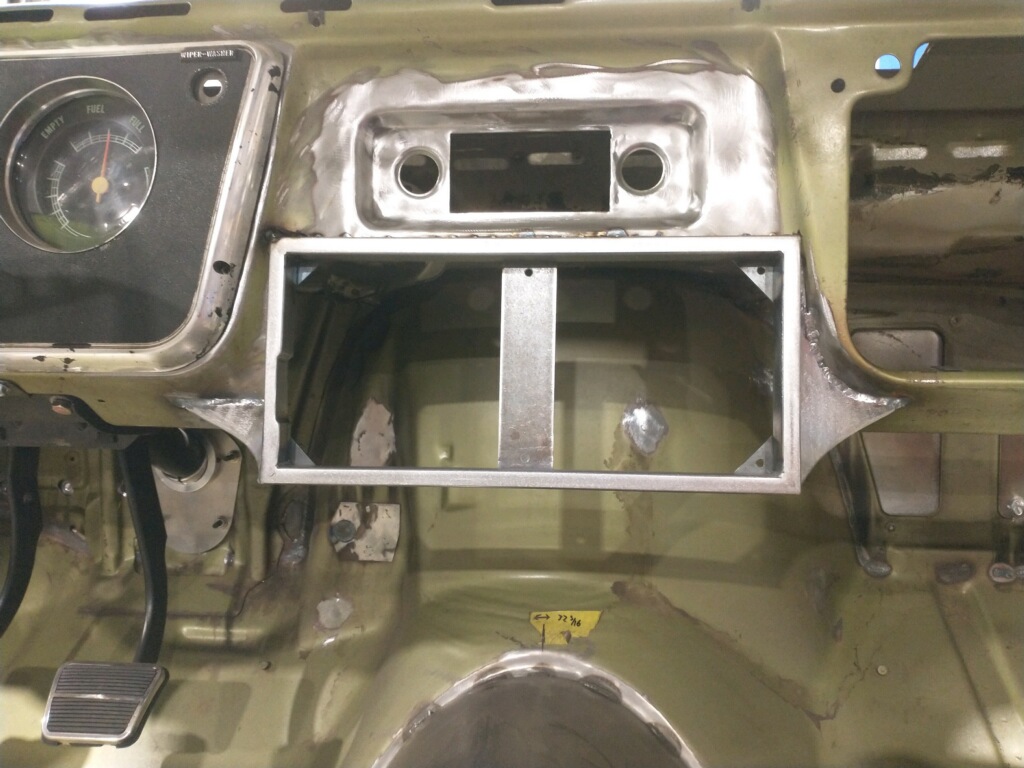

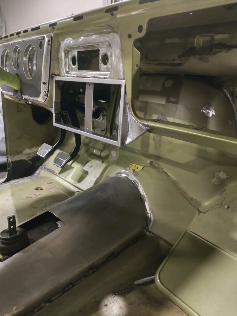

      Dash Modifications
      Including a mount area for Holley 12.3 flush. Name:  imagejpeg_0(7).jpg
Size:  187.4 KBName:  imagejpeg_0(5).jpg
Size:  152.0 KBName:  imagejpeg_0(6).jpg
    16. #56
      16,126
      Is the plan to have gauges in the stock location as well as the dash?
    17. #57
      Oct 2017
      Oregon
      154
      The 12.3 can display all gauges but I will run a 4.5" Speedo and Tach on the Munsey Speed blank dash bezel.
    18. #58
      16,126
      I plan to do the same, but using the smaller dash for the auxiliary gauges.

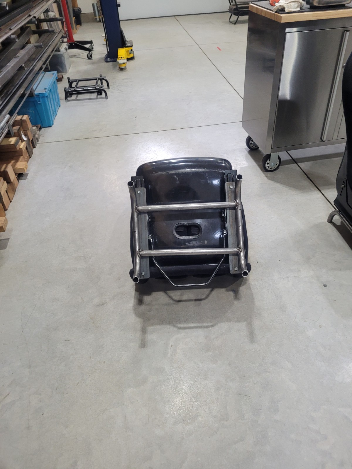

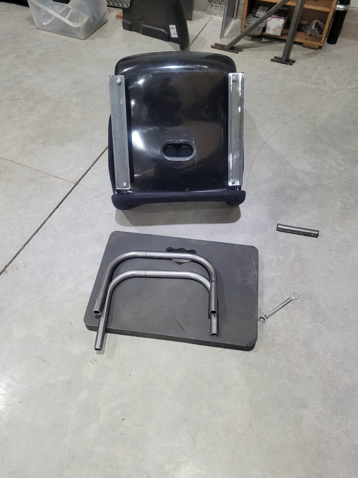

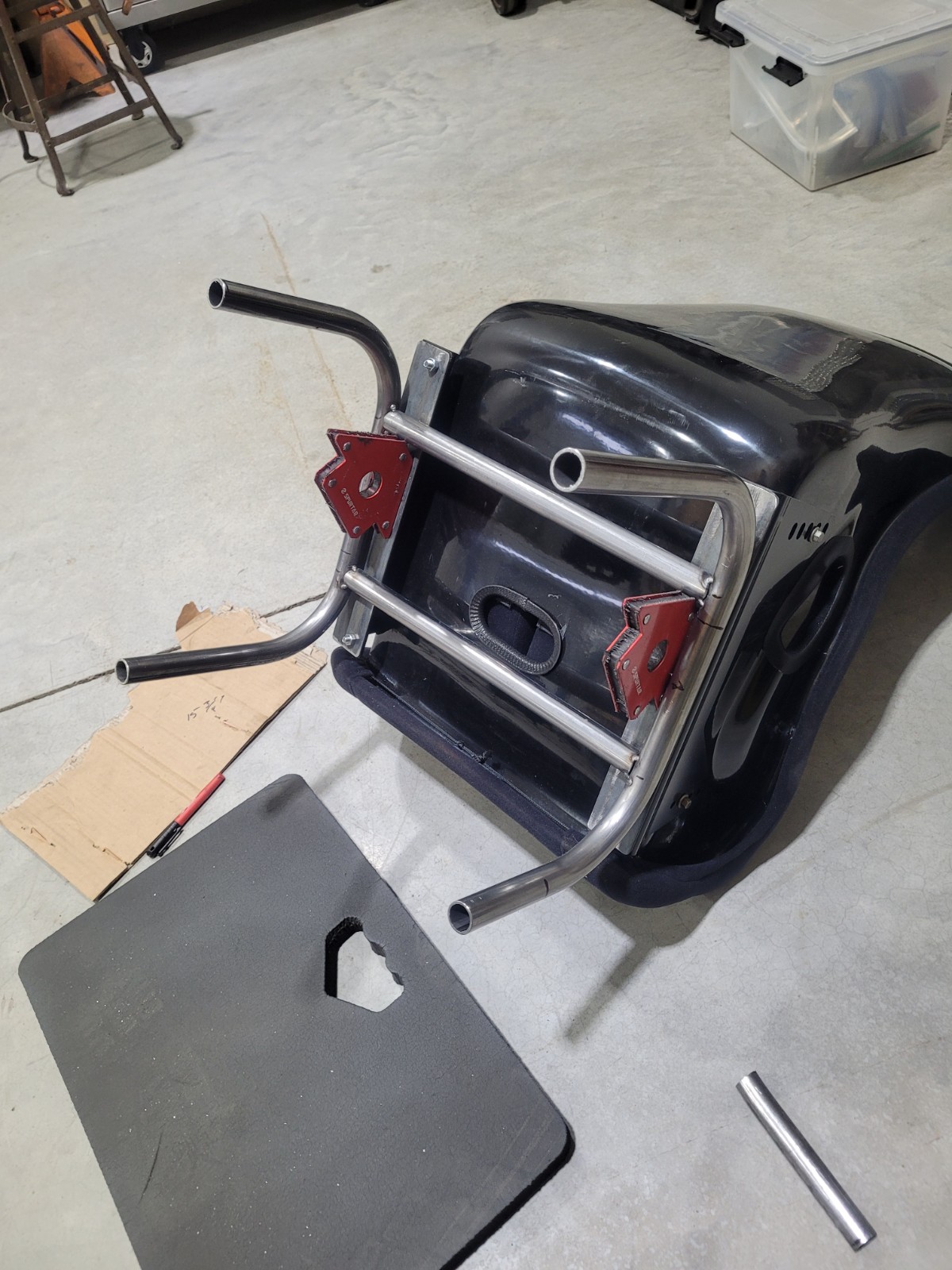

      Seat Mounts
Size:  372.0 KBName:  20221130_120528.jpg
Size:  367.3 KBName:  20221130_122232.jpg
Size:  329.2 KBName:  20221130_122017.jpg
