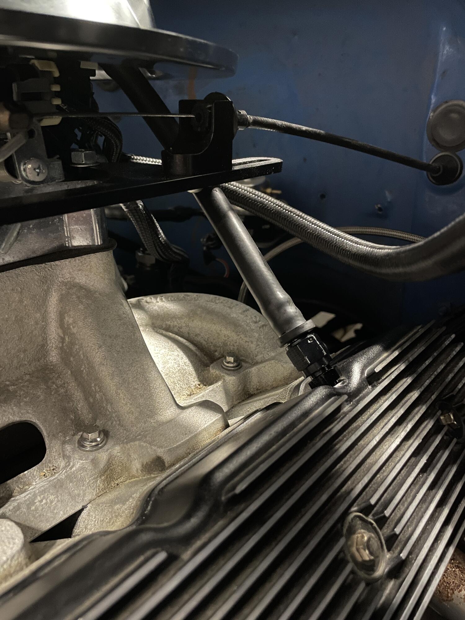

      Andrew, FWIW, those hose barb fittings in the Holley valve covers pull right out. The hole is the exact size needed for a 1/8 NPT tap. I tapped the holes in mine, then used 1/8 NPT to -6 fittings in the valve covers. Completely unnecessary, I just hate hose clamps.

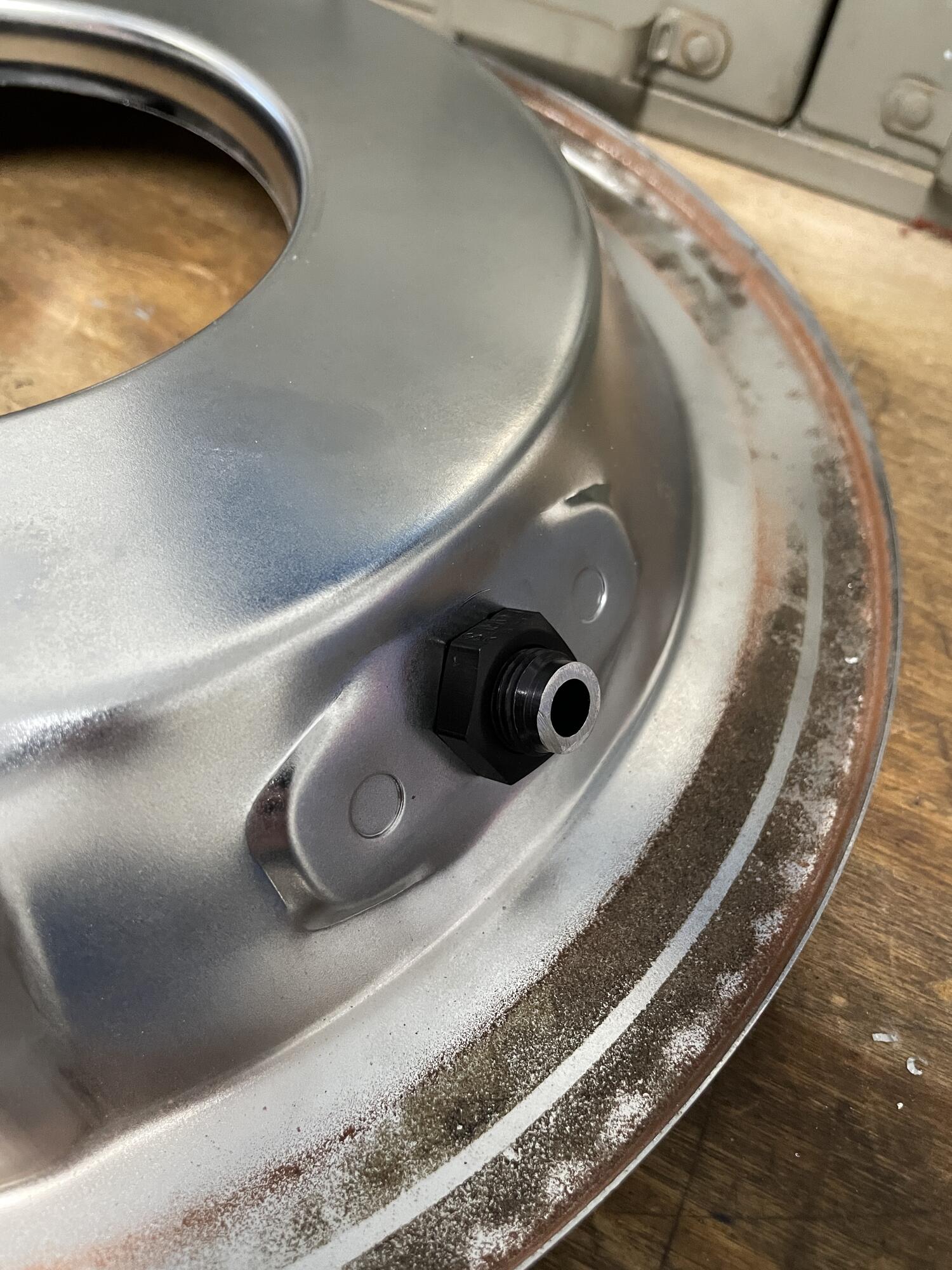

      Thanks for the tip! One of those will stay capped off and the other will go to the air filter base. It's just a fresh air intake into the crank case, so there isn't a lot of pressure on those hoses. A 3/8" hose fits pretty snug over those nipples, and a clamp is generally not required.

      yea, completely unnecessary, but I had the fittings so I figured why not...it also allowed me to turn the fitting on the passenger side cover to face aft which cleaned it up a bit.
