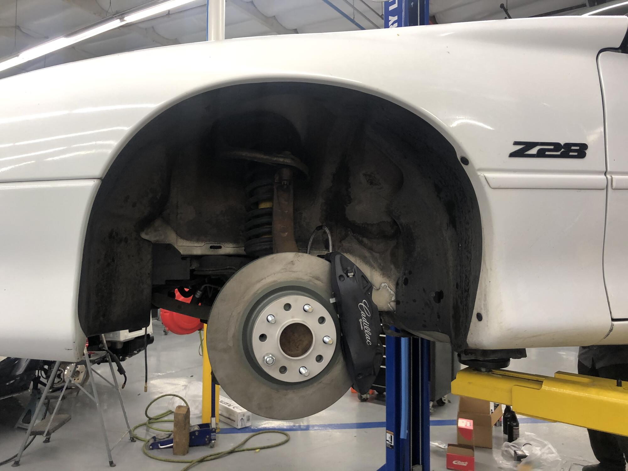

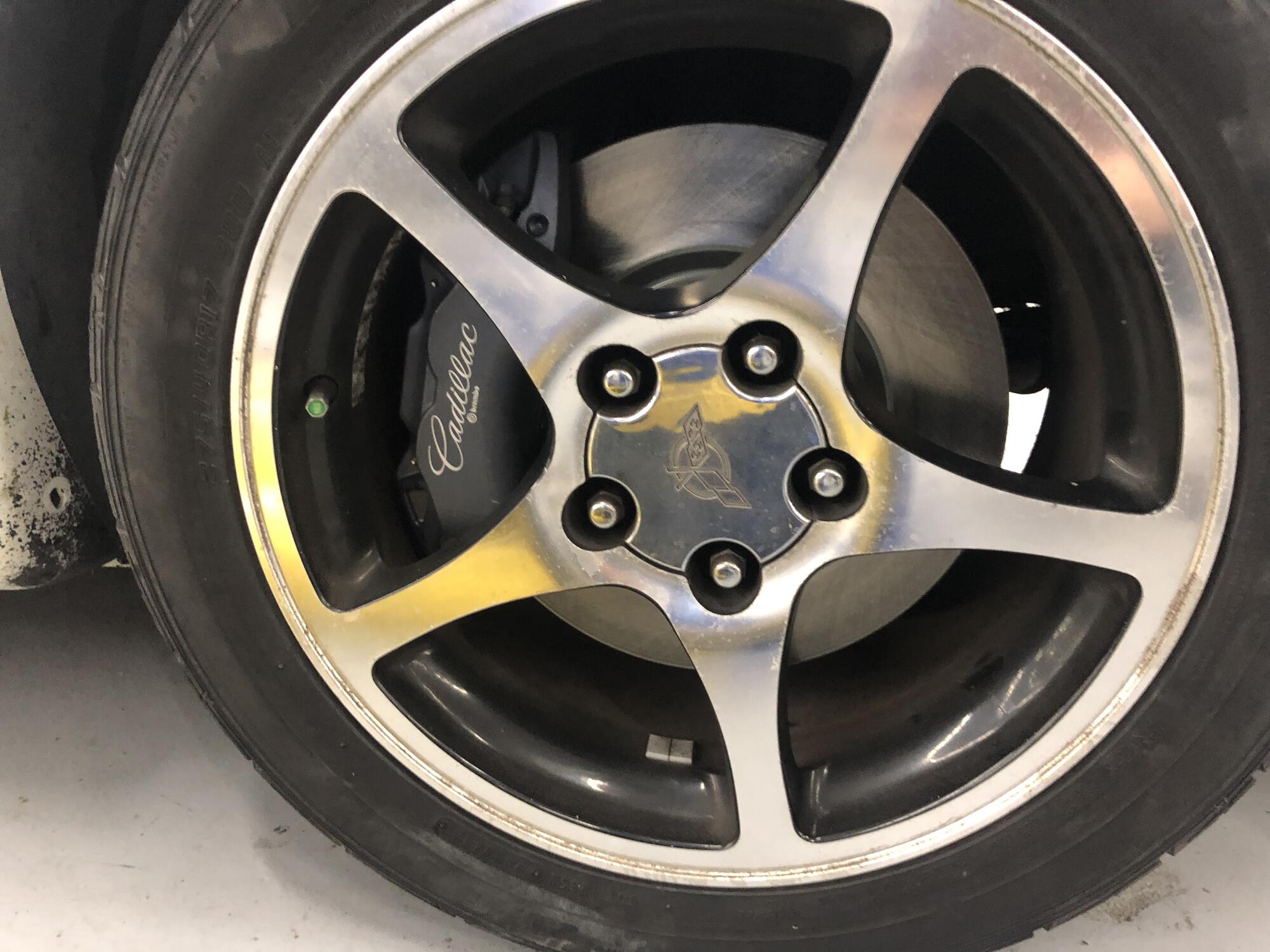

      I completed the swap this weekend along with kore 3 braided hoses(great quality). Much better than the stock single piston brakes, and the swap was straight forward. Only issue is a defective caliper from Amazon, I get the replacement this week so Il swap and re bled the brakes. I did notice that if I slam on the brakes the trac light turns on I’m not sure if that is normal?Name:  810B6288-C31F-4736-9E94-4C5CFC38EE85.jpg
