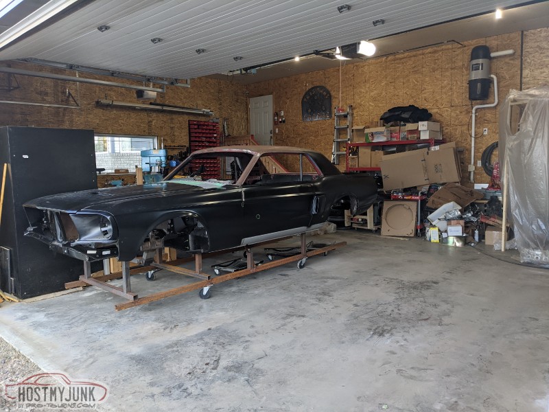

      Well not much to update, got the car into the garage last weekend. So spent a couple evenings with my new best friend the mangle grinder removing surface rust. Tried POR 15 metal prep, but .. meh.. I think good ol' mechanical action works better TBH. No word back yet from the machine shop on the heads. And also still waiting on brake calipers to arrive. I'll get the rotors, bearings, etc when I order the engine parts. I have to get a few more measurements of the Nissan 300ZX IRS unit, but it's uh... illegal... to go to someone's house right now in Alberta. (1984?) So that may have to wait for a bit.
      Here she is in her home for the next who knows how long.

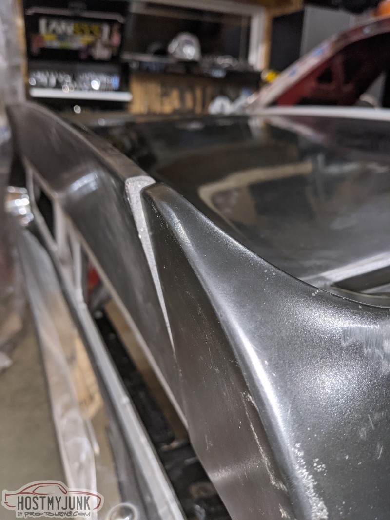

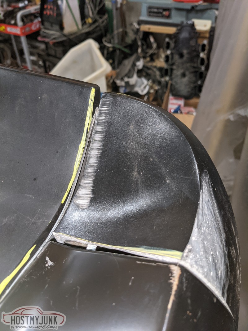

      Started looking at bodywork, most of it is really good, but there are some areas that need work. These 'glass pieces that cap off the rear quarter panels need some fitment work. Can someone tell me what these are called?? haha Anyway, my plan is to bolt and epoxy glue them in place, then add glass filler and shape to fit. Seems to me they are just off in too many different angles to take a different approach, but I'd like to hear y'all's suggestions.
