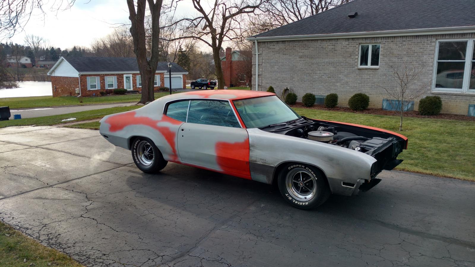

      Don's advice is the right way to do it for sure, but that's further than I'd want to go on a $3500 car. For low budget drivers, I like Summit's paint line. Depending on the condition of your scuffed paint, if you're doing a color change, etc, you may or may not need primer/sealer prior to color. I like their single stage urethanes for DIY jobs. Single stage = less coats (vs base/clear), so less opportunity for trash to get into your wet paint if you're painting outside or in a garage. If you pick a non-metallic color it's easy to color sand and buff. Make sure you wear a legit respirator any time you're spraying "real" car paint.
      Link to paint: https://www.summitracing.com/search?...single%20stage
      I painted this car in a garage with Summit paint. I had about $250 into the paint and primer. Even with a basic paint gun, water separator, respirator, body filler, sand paper, blocks, etc, I was into it for well under $500 total. I've had plenty of cars with nicer paint, but it gets to the point where you're afraid to drive them.

      this is the info I am looking for I have a car that is top notch and scared to drive it. So want a driver quality paint but also want something that will hold up in the weather for a while.

      It's held up well for the past 4 years for me. It may chip slightly easier than the high dollar paint, or maybe I just notice more chips since it gets driven more frequently. As long as you stick with catalyzed (2 component) automotive grade paint (Summit, Kirker, Eastwood, etc) durability should be okay. I'm sure it gets a incrementally better as you move up in quality/price.

      Your car looks really good! I like the color too!

      Thanks for the kind words. The paint and body work was a very time consuming but rewarding project. In retrospect, I kind of wish I would have taken the usual advice to pay more for a nicer car to start with.
