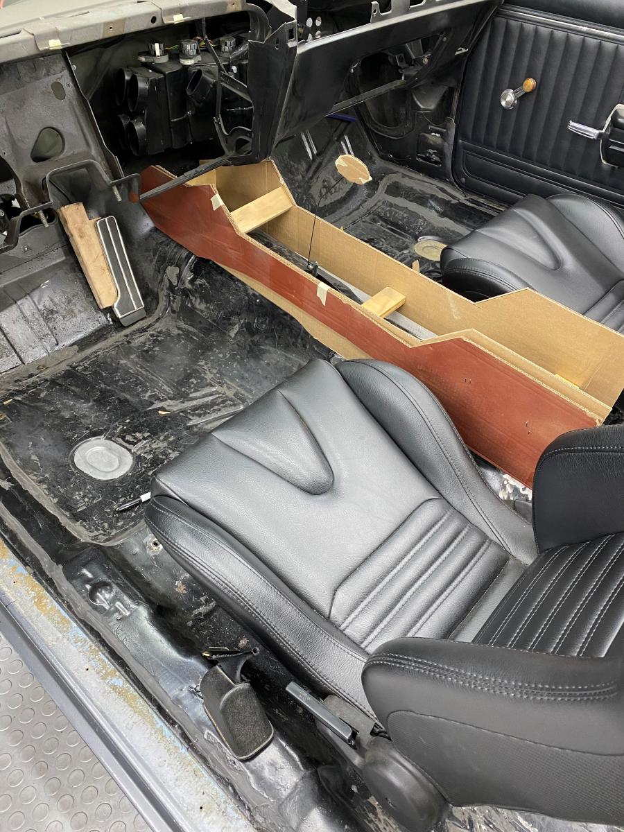

      I roughed in a cutout for a console this afternoon and need to pick a direction. If I make it an actual, functional armrest and not what came in these cars, it will be about 2" taller than what's sitting in there. Thoughts?
      Also need to integrate the parking brake lever.

      That looks awfully tall already. Put an EStopp in it and install the button in the console, you lose the lever and then you have a hidden anti-theft too.

      I think part of what's making it look tall is what would be the armrest. It's probably 8" further forward than what it would actually be.
      The EStopp is an option I've looked at. I'm just on the fence about "adding complexity" to the car. Agreed it is a clean solution if I can hide it somewhere.

      Im gathering carpet will also add at least 1" to the current height also....

      Taking that into account. Already cut it down somewhat over lunch.
      As a separate issue, and I know this doesn't come up for everyone, I have so much room between the seats I can rest the rear part of the console flat on the floor and still see daylight in the gap between the seat. Right now the gap is about the same as what's at the door so there's some symmetry to it, I just don't know if changing that would look odd once you were sitting in the car.

      I prefer a functional armrest that also flips up for some light storage. I think what matters most is if your arm rest comfortably at that height while cruising, as well as not interfering with shifter work. I agree that it's set forward probly a good 8'' too far forward.
      could you contour the e-handle over to the passenger side?
      As far as the gap, contours and other features that help break up the long flat panels always look more custom to me, but they also are much harder to fab(especially symmetric). Below was my very first attempt at a prototype, didn't fiberglass very well, but the armrest height worked pretty good.

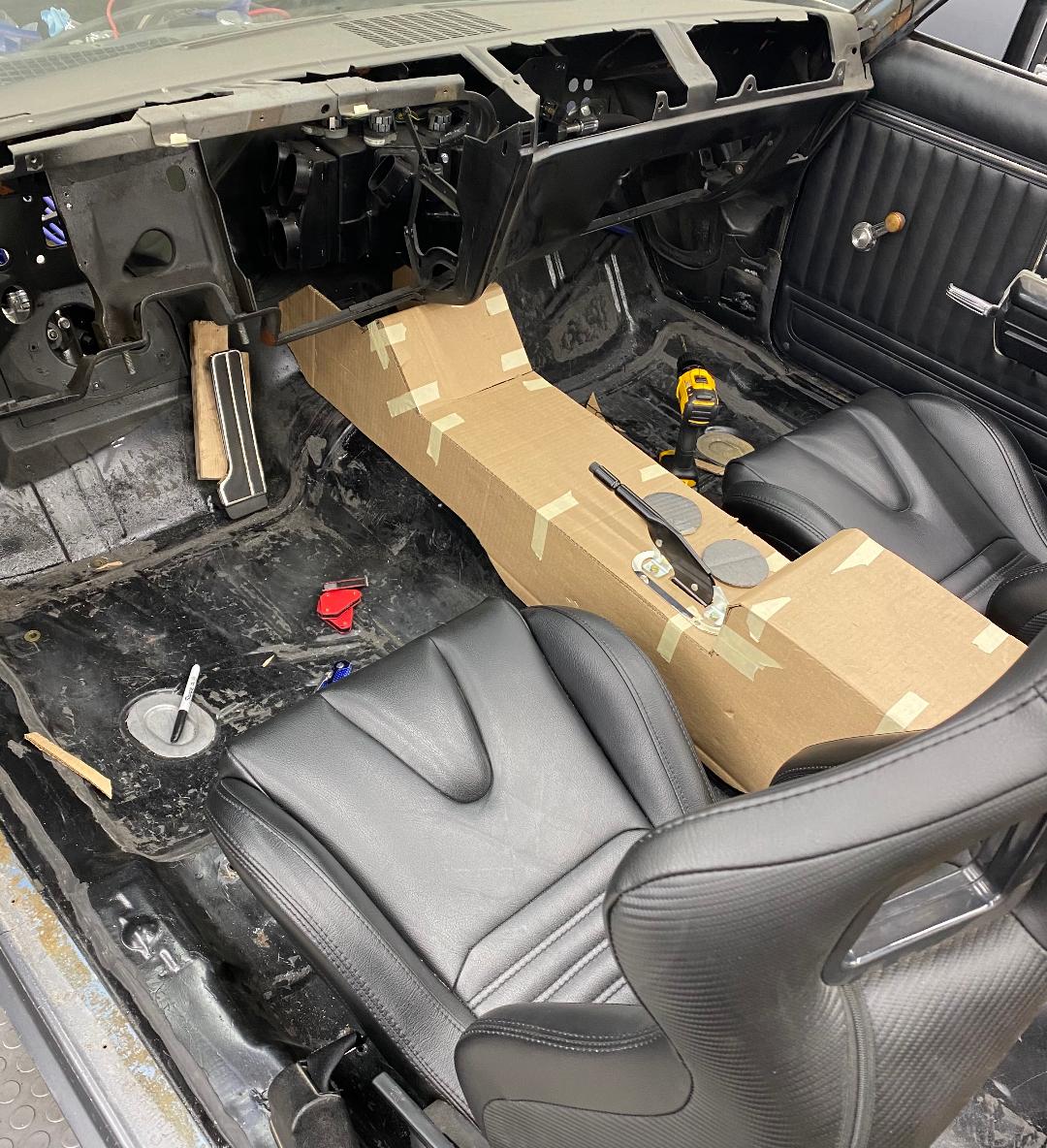

      Started on a second mock up with cardboard. Space is never a limiting factor on this car but I think I'm firmly against an electric e-brake. I just don't like introducing additional complexity for some things. Need to step it up a bit as the paint appointment is looming and I don't want to be welding after it's done. Means I have to pick a brake lever and fix attachment points.

      Getting closer to a basic shape on the 2nd effort plus I thought to look at shifter position. I may try to add a layer on the finished console that mimics the body lines, we'll see how that goes.
      Other trim inserts will be brushed stainless so the goal (I think) is to bend a sheet of brushed ss to shape as the top surface.
      Where are people getting the piano hinge and lid catch for these?

      build it and sit it in feel where your leg hit is. feel where your arm is. it takes time... if you don't like a section cut it out and glass it in.
      you can make changes. as you go. build a base that is low and mountable. then you can add a top section simular to how the factory did a 2 piece. sandable foam glued together makes quick changes easy. messy.... but easy. glass over it and you have a solid foundation.

      I'm with you on electric ebrakes. I've had one on one car and it was terrible. A manual hand brake is much easier to use in an emergency.
      Piano hinges are quite common, and can be found at any hardware store. The salvage yard will also have them, and more likely in the size you need. The OEMs riveted them into place so drill the rivets and there you have it.
      There's no reason the console can't go wide at the seats if it looks strange being narrow. A wider console will give you more storage and will allow the passenger to share the armrest.
      An important consideration, especially if you're tall - no sharp edges on the console where your knee would rest, and not too tall. Personally I like the console to go really low where my leg goes so there's no contact at all but if you like your leg on the console, a sharp edge gets sharper and sharper the longer you're leg is on it. Making it smooth and rounded through that area is best as it doesn't press in on your leg even if you adjust how your leg lays on it.
