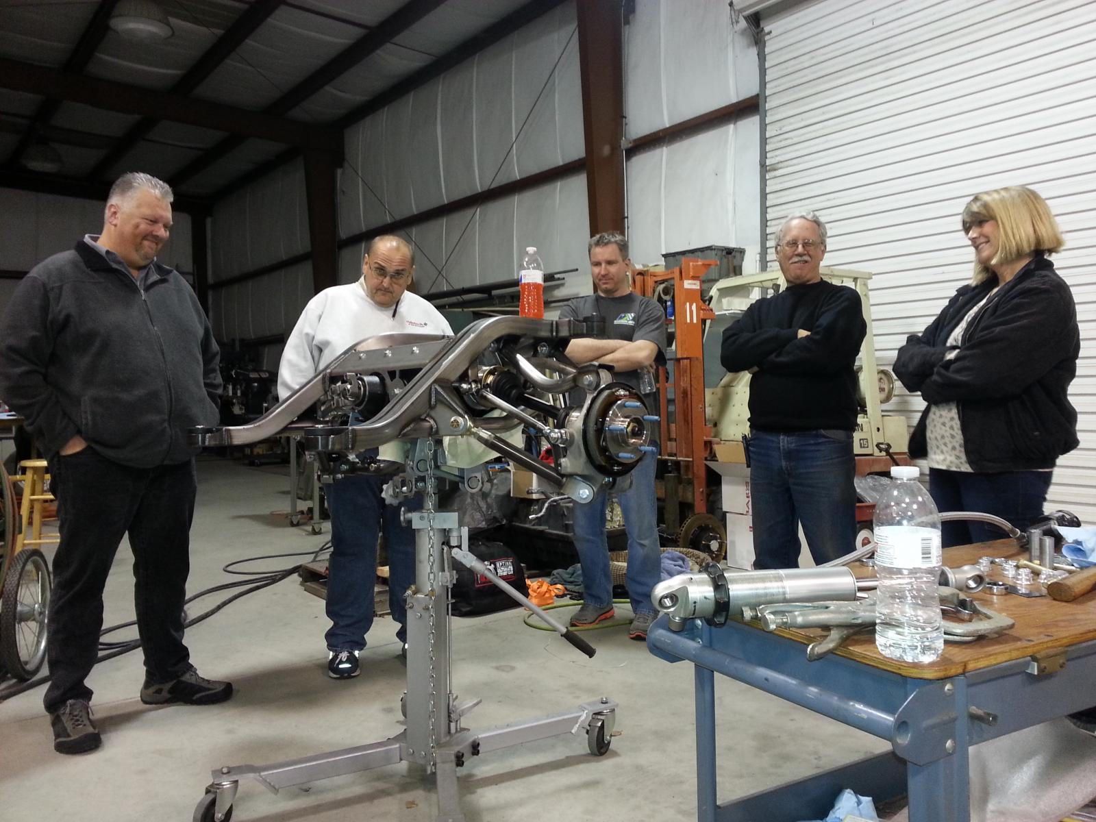

      Here i took a shot of all of us many many years ago in David and Mary's shop, with Bret Vokel (ridetechs owner) Larry Callahan (owner of this very forum) along with Mary Pozzi (fastest lady I know), David Pozzi and James Shipka (owner of one lap camaro), as we talk about the new Morrison IRS rear that David and I just drove to pleasanton california to pick up from Craig Morrison for his 68 camaro, this is how we spent our evenings
