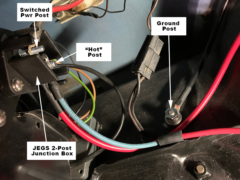

      Since I'm in the final wiring phase myself I am curious about the heft LOL of all that wire. I decided on 2 AWG for the main wire from the battery + to the starter, 2 AWG from the battery - to the engine ground. From the alternator to the battery + terminal I'm using a 4 AWG wire with a fusible link at the terminal end. I also added a dual post Jegs junction block where the OEM one was, will run an 8 AWG from the battery + terminal to the lower (hot) post on the junction block. Another addition was a single post body ground which I located on the apron section just in front of the PS inner fender well. Ground down the paint to bare metal before installing. I will run a 8 AWG wire from the battery - terminal to the new body ground. I _could_ run a piece of 4 AWG from that - terminal to the body ground... you think that's necessary? I have a braided ground strap at the rear of the engine to the chassis. I was told that since the alternator is mounted to the engine, grounding it to the block is overkill.

      And while I am running dual eFans (controlled by Carl's pwm) and Vintage Air, I have no radio and that's the last thing on my list. And if I ever do install one, it'll be just for the handsfree phone use, nothing much more. I do have a FiTech 600 sitting on the shelf but whether or not I install it is also way down on my list. So I was wondering if all that heavy wire you used was because of an ECU, a Stereo, or whatever. I went over all my stuff with Tony at CE Autoelectric and went with his recommendations. I haven't decided how I'm going to switch on that upper post yet. I may simply run a line from the fuse panel tab IGN to a dash mounted junction block (the old OEM one) and then run a wire to the post. Another approach would be to put a relay up there in the front and trigger a IGN-ON power draw from the lower post to the upper using 8 AWG. I'd use that upper post to power the SS module that controls the RS headlight doors.
