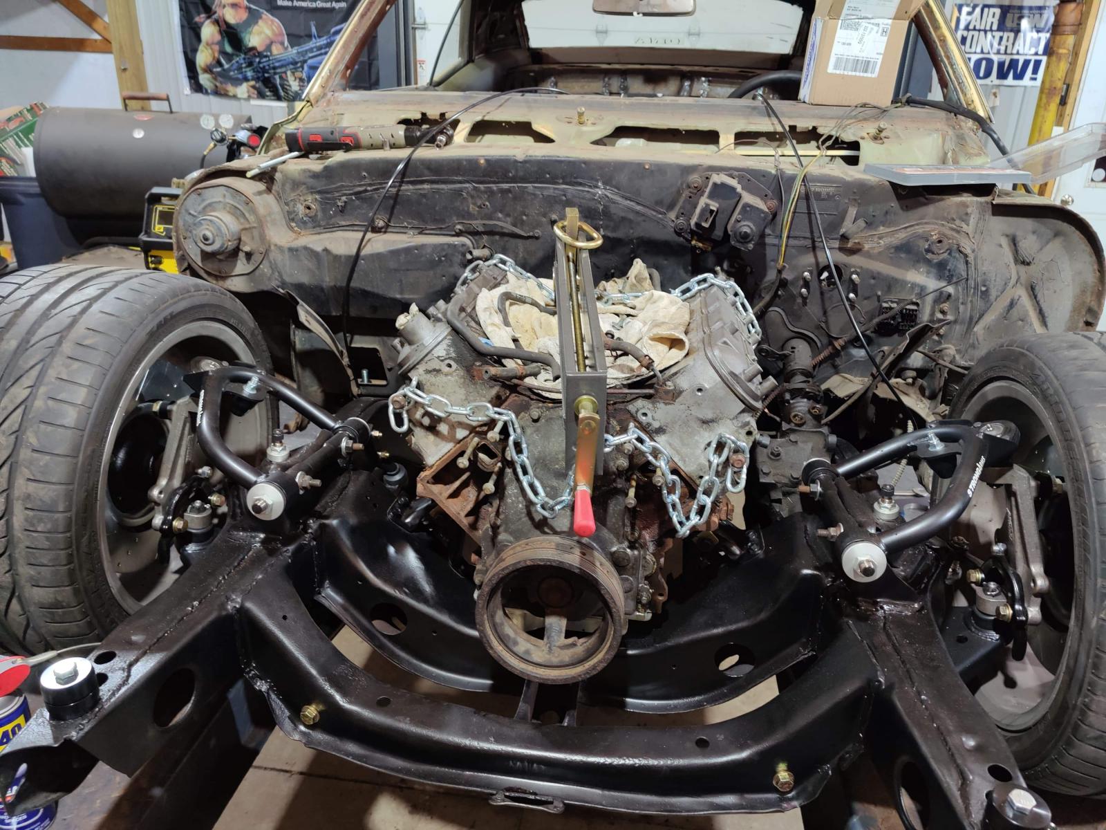

      Is the type 2 PS pump better that the old school saginaw pump?
      I have a LQ4 I'm swapping into my 69 Camaro. Old PS pump is wasted. I was going to buy a truck pump to replace my van style pump. But thought I'd look into the type 2 pumps and ask for anyone that has travelled this road. They're smaller but are they just as reliable or run any cooler? I see the 4th gen Z28s run the type 2 pump.
      The car is running ridetech airride with the truturn option. Original power steering box for now. Until a proper quick ratio box can be obtained.

      Old pump will work, just get a cooler on the return line. I'm running a stock LQ4 pump with 2002 S10 ZQ8 steering box and 2005 tahoe hydroboost with no problems other than needing a cooler on the return line.
      The pump internals are the same, just different bodies/reservoirs. LS3 use truck spacing on their accessories, you could look into a GM type 2 pump if you wanted. (I'm running an LS3 water pump on my LQ4, had better upper hose routing for my setup)
      For bracketry you got Goatbuilt, Dirty Dingo, ICT, etc. Seems like everyone is making brackets for the LS accessories now.

      The P-pump, the original type for your car and used in a bazillion other GM and Chrysler products, can be modified to run dry. That is, without the integral reservoir, hence requiring a remote reservoir. I ran this setup, with modifications made by Lee's Power Steering, for many years and track days without issue.
      Another key ingredient with this setup is to only use the real GM power steering fluid. No other fluid even comes close to working as well with the P-pump especially from a de-airing and heat standpoint. It worked so well that even now though the car has been converted to a CB pump (a non-roller bearing small pump similar to the TC) the GM fluid is all that it used.
