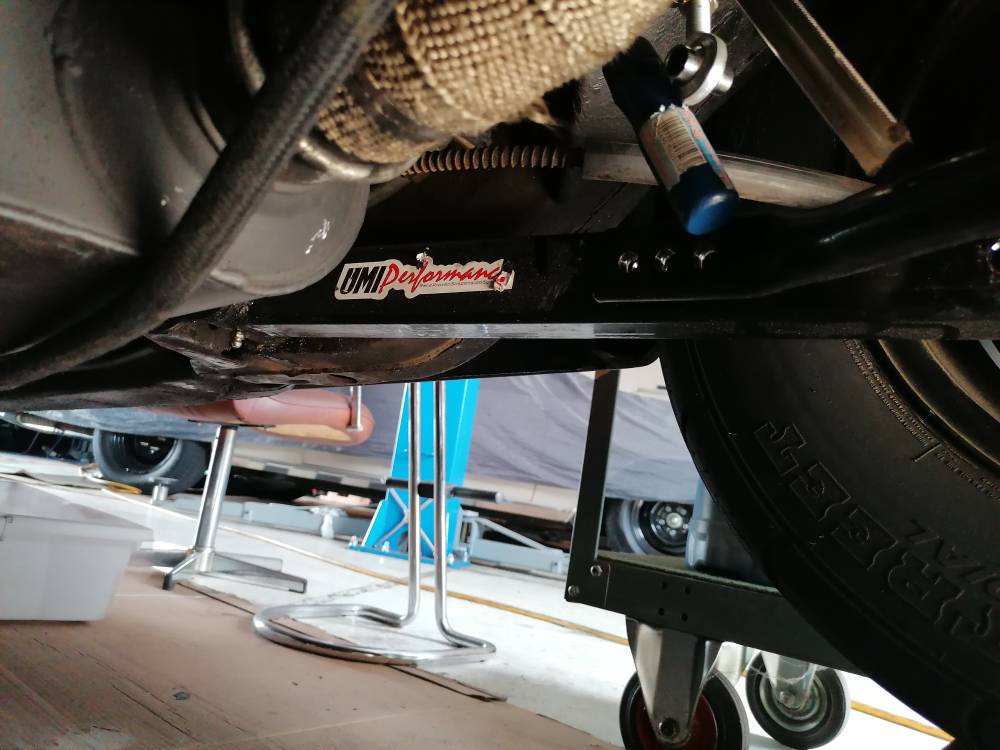

      I have rear sway which hit the diff cover if bolt on with existing parts. Think I must use a block and longer end like in pic to get the bar away from cover.... Is this correct?
      Must the sway bar be parallel with the arms?
      ThanksName:  IMG_20200910_121658.jpeg
Size:  97.2 KBName:  IMG_20200910_121707.jpeg

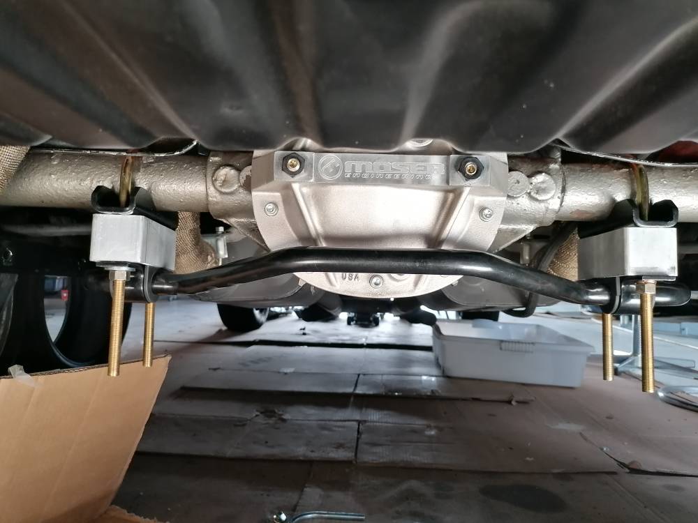

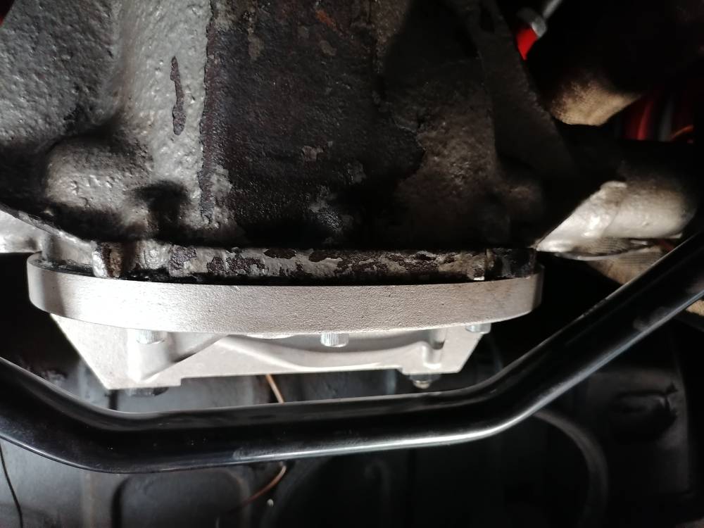

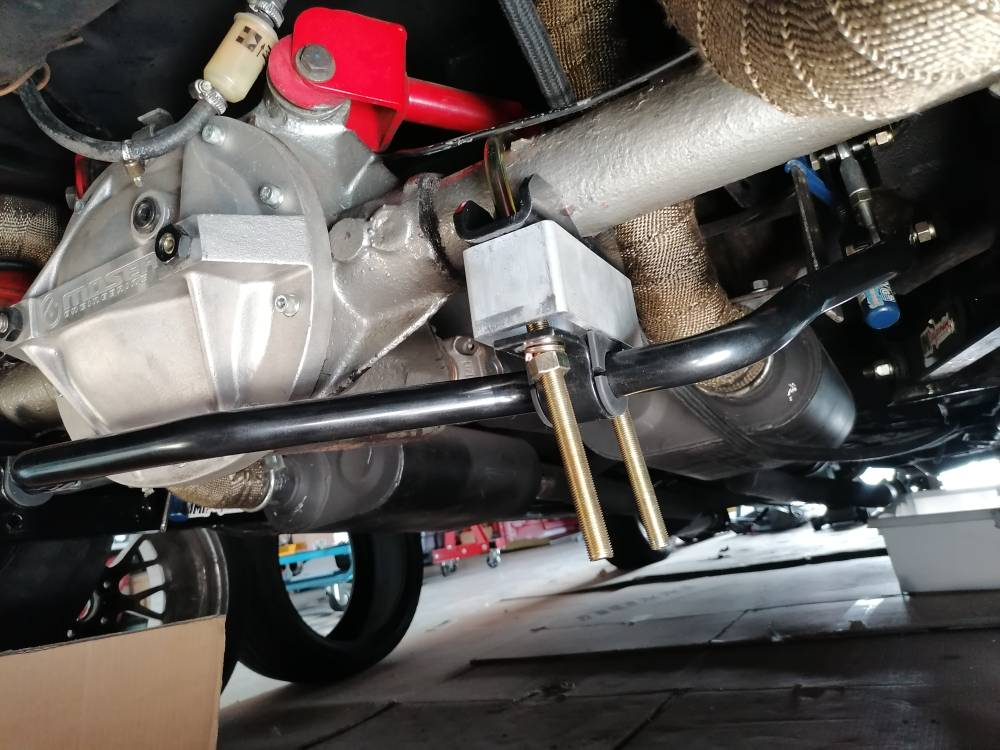

      These pics are if the sway bar is parallel to the arms....
      What you guys think... Is this the way to go? Name:  IMG_20200910_130212.jpeg
Size:  72.3 KBName:  IMG_20200910_130246.jpeg
Size:  79.1 KBName:  Image.jpeg
Size:  88.8 KBName:  IMG_20200910_130231.jpeg
Size:  72.3 KBName:  Image%20(1).jpeg

      if we were sitting around having a beer and you asked me this, I'd say "it's fine bud". The forces for torsion are generated at the pickup points, so the orientation shouldn't have negative effect.

      The the sway bar swing arms do not need to be parallel to the lower control arms, just try to get everything in a place where they all play nice together. You can even rotate the axle tube clamps back a little to gain a bit more space as well. Might need tack welds to hold everything in place once you find your spots though as they will try to twixt under duress.
