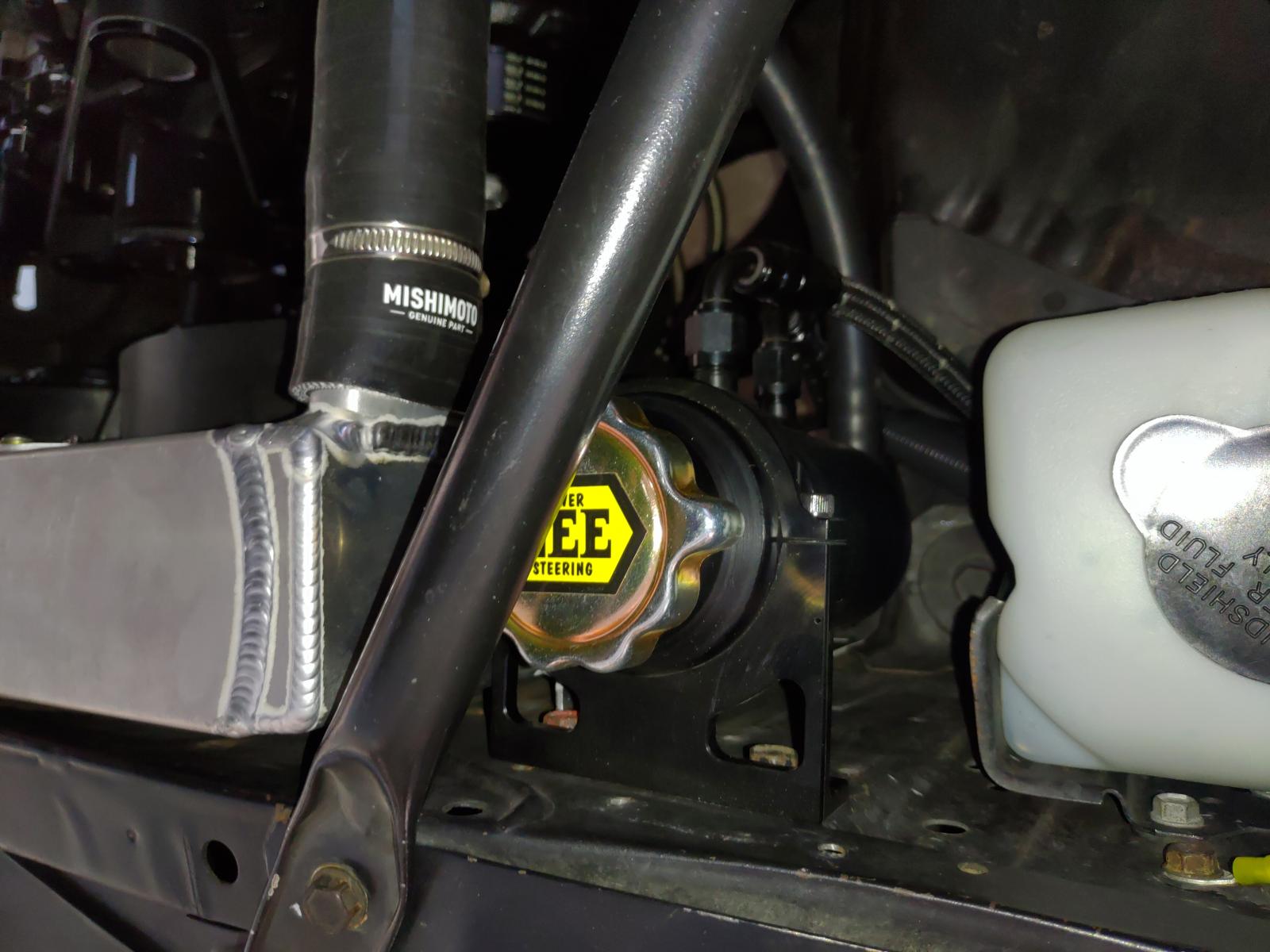

      Quote Originally Posted by anguilla1980 View Post
      Here are a couple I just took for you...
      .Attachment 181130Attachment 181131
      Thank you, so much... what would you change or do differently if you were to do it again?

      Awesome, thanks again... Do you have a lee's steering box or just running the reservoir? If you are running the steering box, can you comment on which ratio you have and your thoughts on the system
    4. #24
      Sep 2016
      Bakersfield, CA
      600
      Quote Originally Posted by 1320str8liner View Post
      I have a TurnOne SB2 600 series box that's 10:1 with the 235 (aka 35lb) t-bar I'm running with the Lee pump kit. I like the 235 t-bar for road racing but a 225 would be more appropriate for auto-x.
