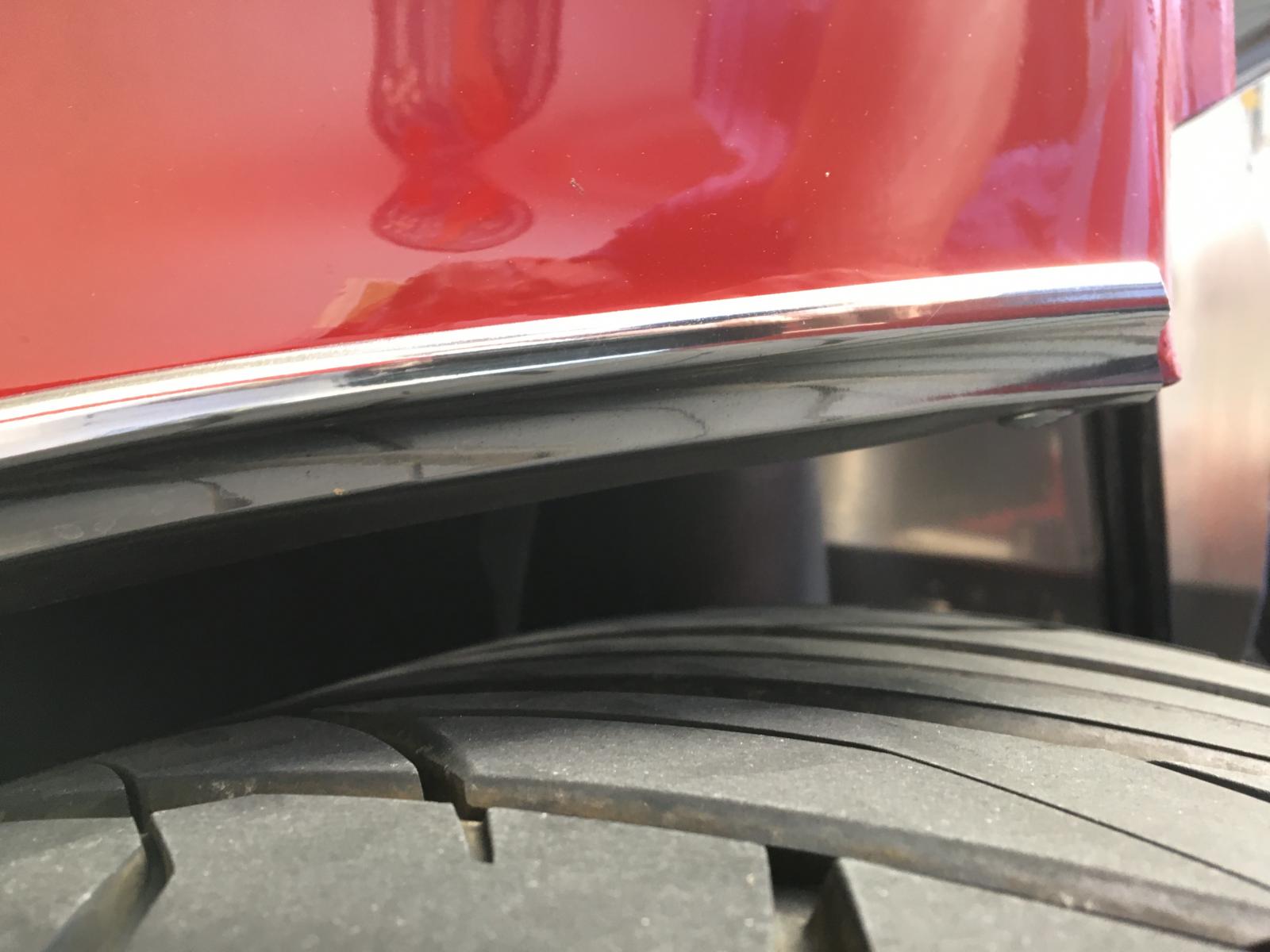

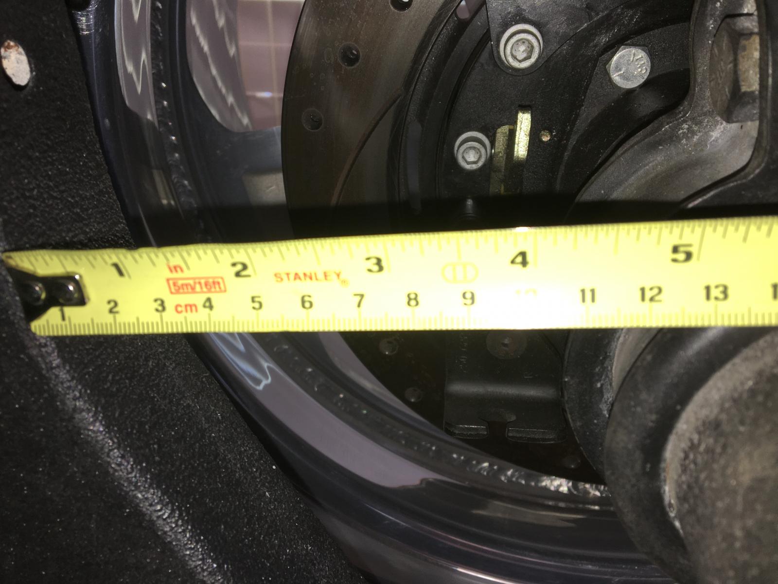

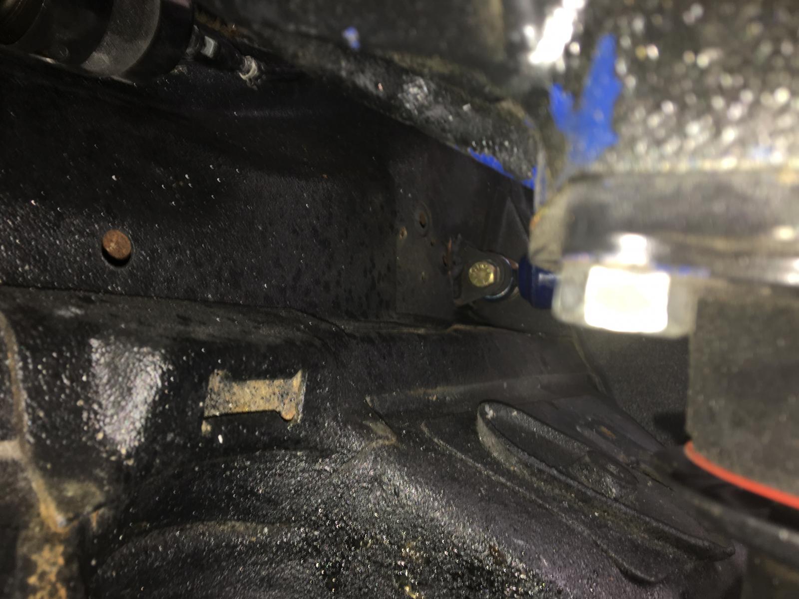

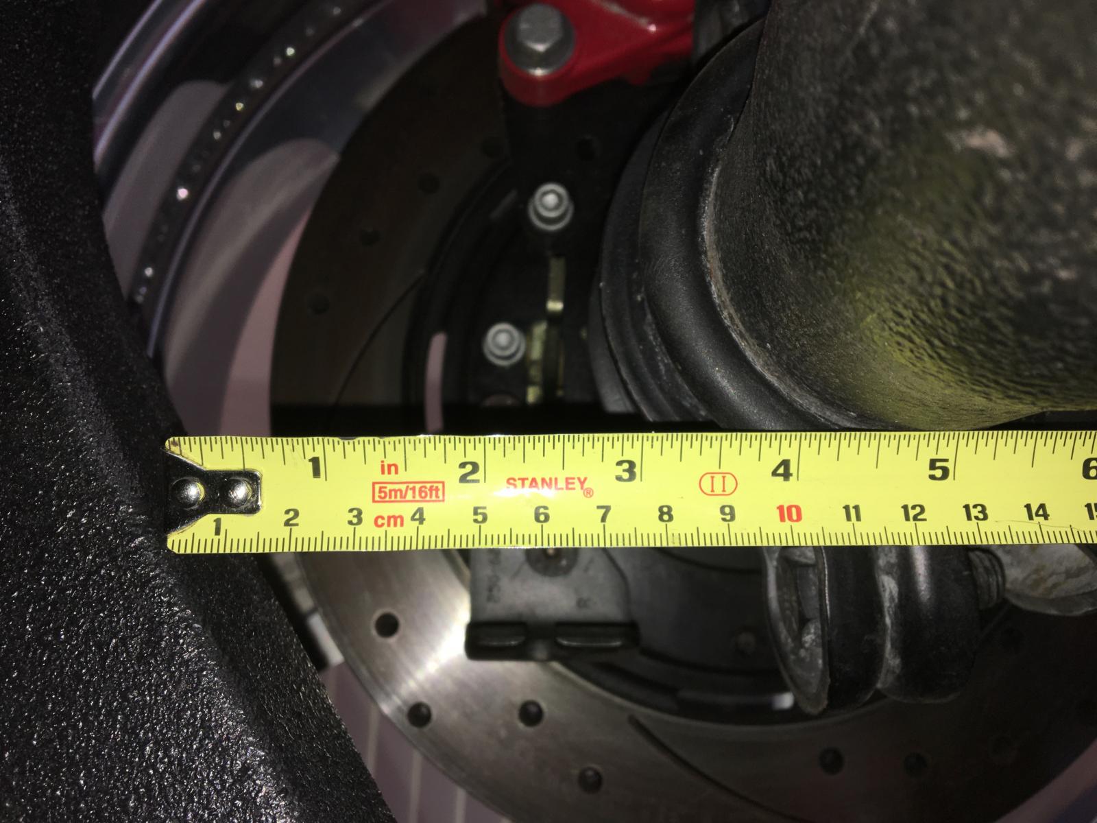

      I have a 68 Camaro that has been mini tubbed with Ford 9" rear end.
      Attached are pics of my rear wheel clearance and frame to axle space.
      What would be the best option for axle bump stops and pinion stop?Click image for larger version.

      Have a look through what Summit offers in microcellular urethane (foam). They have several sizes and shapes that should fit.
