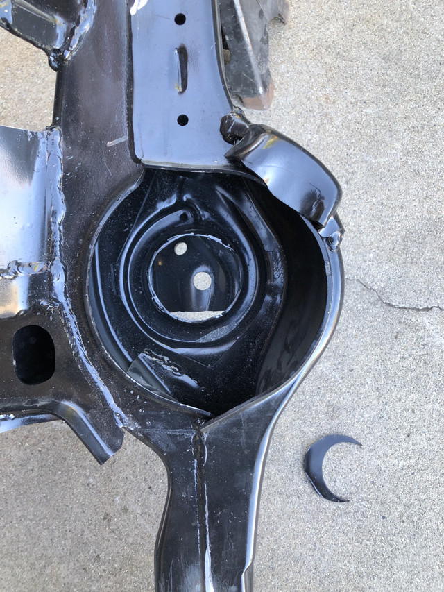

      I am prepping the stock frame for the DSE JRi Coilover setup and I ran into an issue or concern.
      Per the instruction on installing the setup in a 69 Camaro the top shock hole was enlarged to 1" using a uni bit. The problem I am running into is the actual bushing install and how it sits on the bottom side of the frame. In the instructions I see the bushing should sit almost flush but when I install the bushing it sits closer to a 30 deg angle. Even with the shock in place and snug it down the shock rests at an angle. I can force it straight but then I am putting quite a bit of side load on the shock shaft. The outer edge of the bushing is pushing up against the frame not letting it bottom out.
      This seems like a rather easy fix, but I wanted to get others opinions on this. It seems the resolution is to weld up the hole and re-drill closer to center or inward. I could also trim the bushing and black washer to accommodate the angle of the frame. None of this is in the instructions so my question is what do you guys do? I have 3 subframes sitting here in my storage. I measured the center of the shock mounts and all three and they all seem to be within 1/8" at 35 1/2. I do not see this is related to a bad frame. Possibly just a variance in the bends, maybe...
      I sent this exact question to DSE and waiting for the reply. What would you do?

      Called DSE this morning and got the following response.
      - I should relieve the bushing to sit flush. Basically cut an angle on the bushing.
      - Cut and weld a flat patch for the bushing to sit flush.
      Overall the bushing seems to be to big. they said they has not seen this before... I find this very hard to believe, but whatever. It's part of building/assembling cars.

      I went ahead and just modified the bushing per DSE recommendation.
      I used a razor blade to get a rough cut of the angle then used a belt sander to finish the fit. It now sits flush in the pocket. and there is just a 1/16 to 1 1/32nd of clearance around the cut side to the frame.
