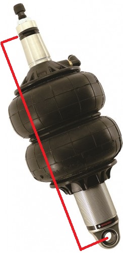

      I can see that it has one of our extended stud tops on it. If you get a chance, measure from these points and I'll be able to help you figure out what shock you have exactly.

      14 in extended. Stud is 2 5/8s. Should for for a F body GM. Only have the front and compressor. Will be adding the rear also.
      Feb 2013
      1,542
      You have a 3.6" stroke shock w/ our 2.75" stud top.
      Here are the dimensions:
      Collapsed: 11.05"
      Ride Height: 12.83"
      Extended: 14.05"
