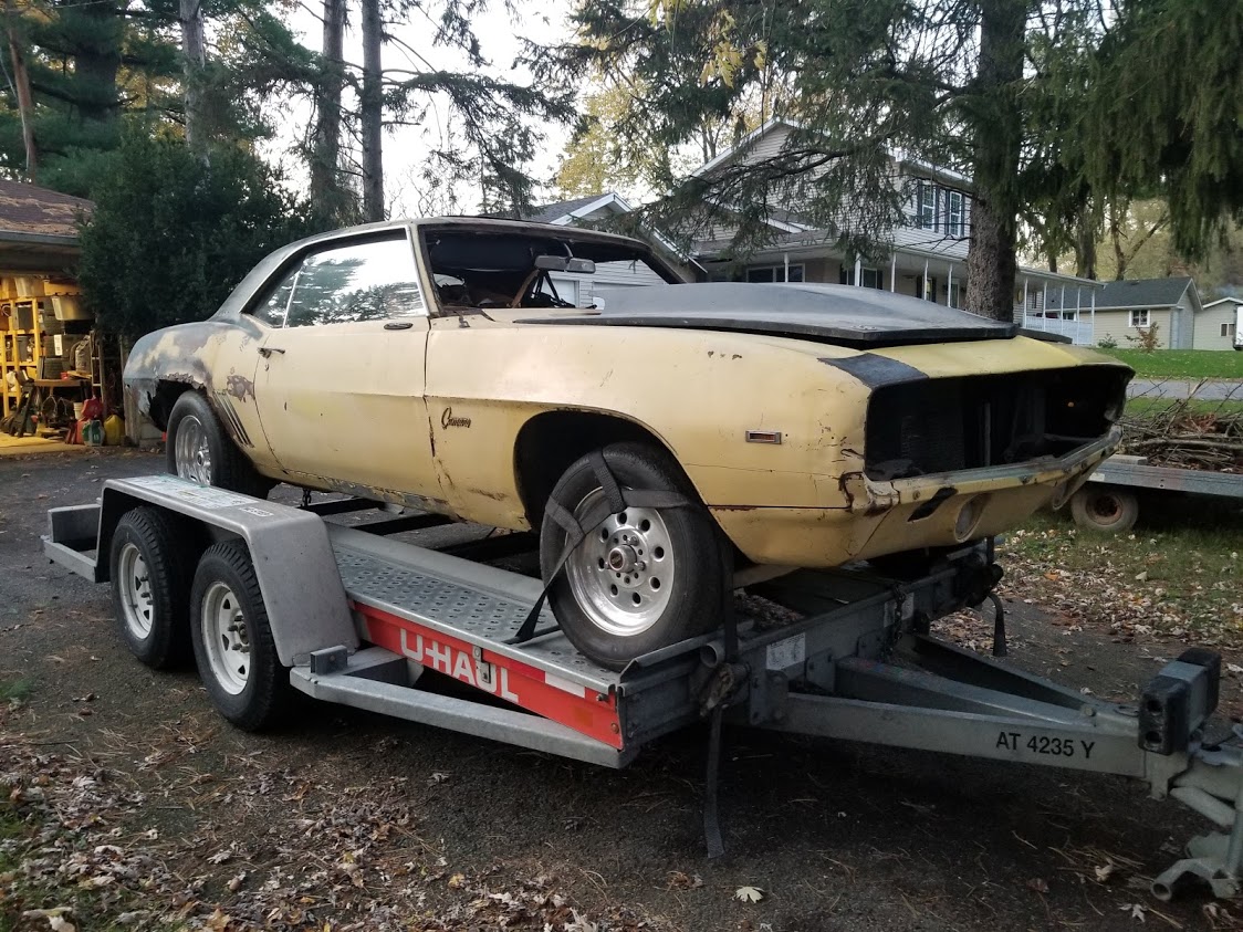

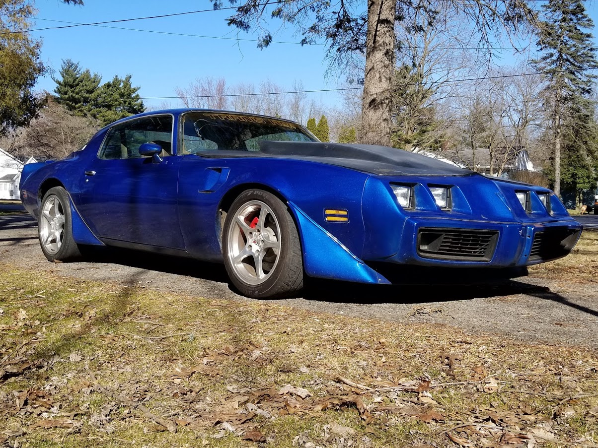

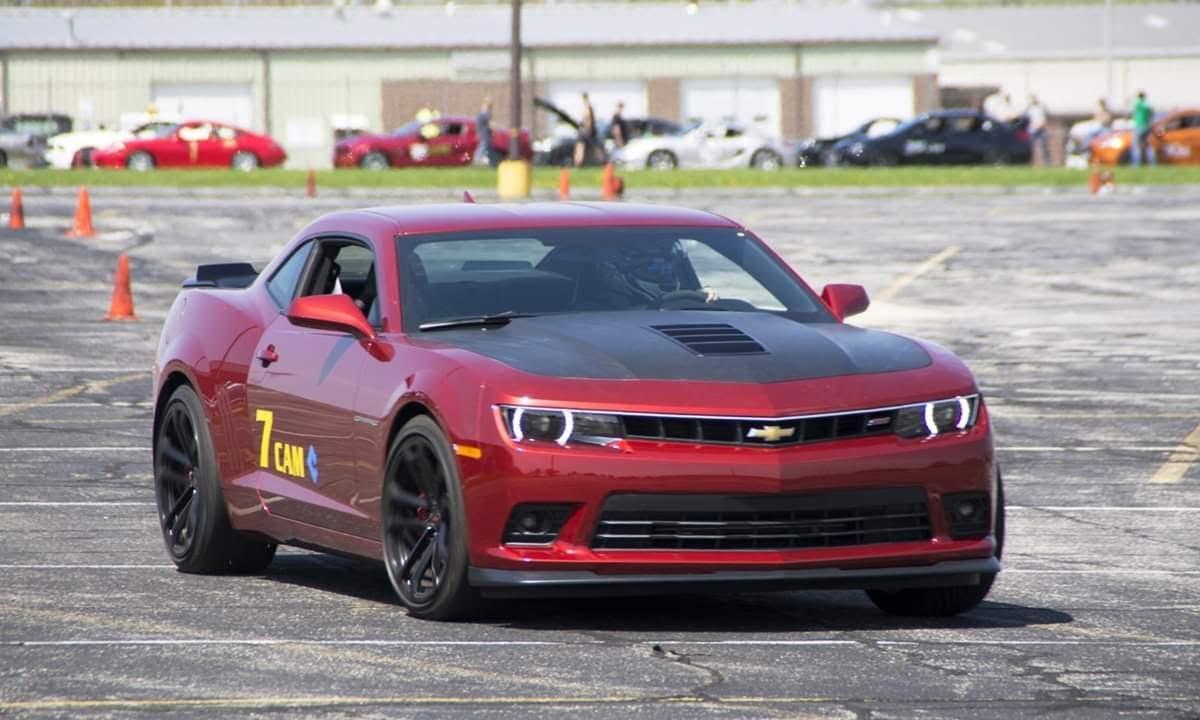

      So I sold my side project 79 TA autocrosser to a gentleman in Finland who saw my TA on these pages. He found it on Craigslist and got ahold of me via email. Such a small world we live in now. The short story is he had it shipped overseas without even seeing the car. But he has had it a year now in Helsinki and is enjoying the American car culture and improving the car to much higher levels of detail.

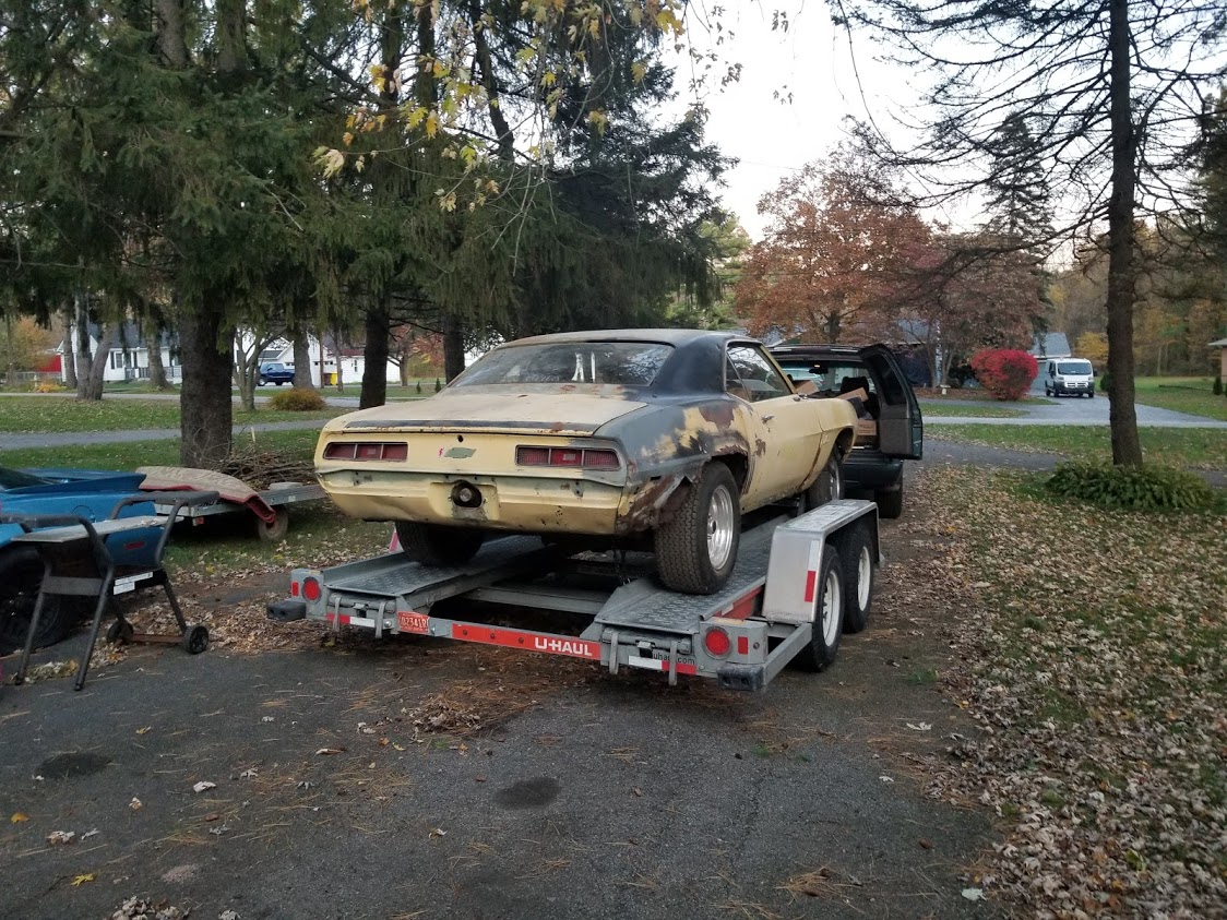

      Loaded up and trailered to Thomp's.

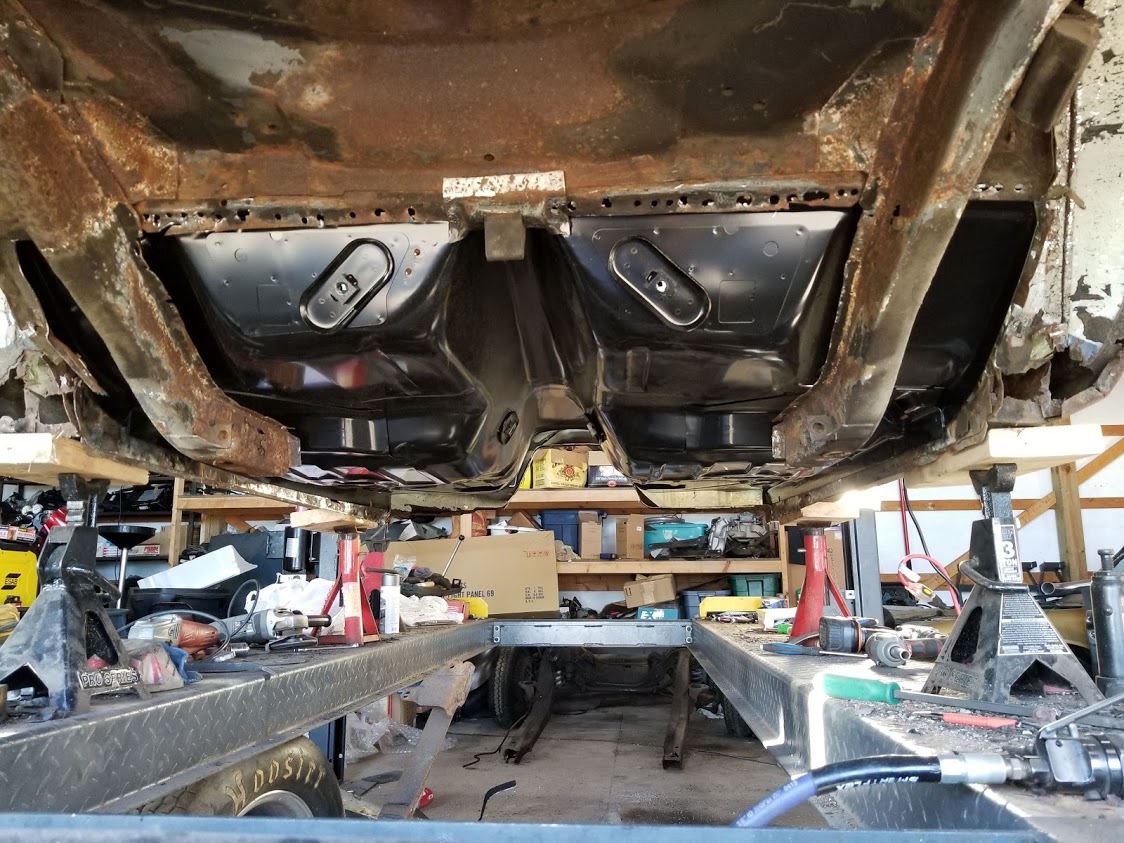

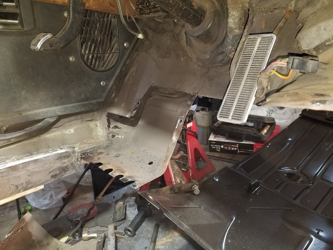

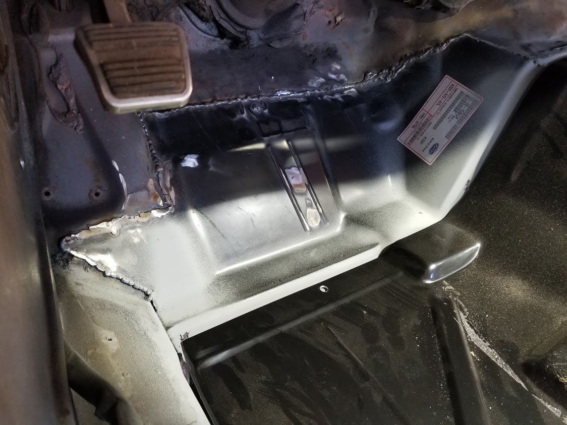

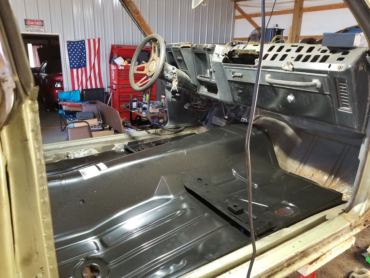

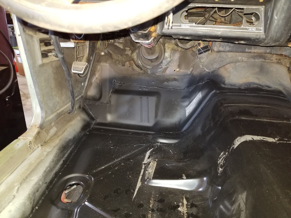

      Floor pan is just sitting in here in these. We pulled it back out to repair the drivers toeboard and the inner rockers needed some repairs as well.
Size:  161.5 KBName:  20200216_154905.jpg
Size:  235.4 KBName:  20200216_141845.jpg

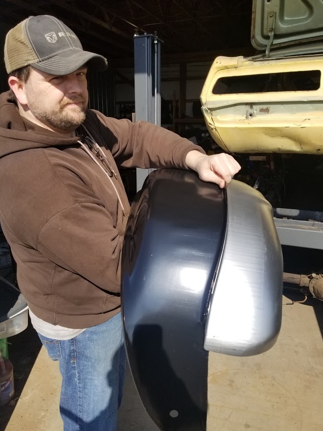

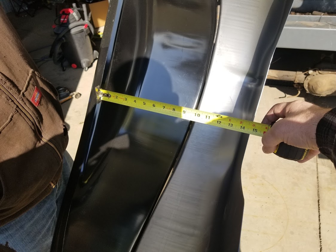

      Factory parts being put in may be a little boring so here are the DSE minitubs and AMD outer wheel houses.
Size:  142.8 KBName:  20200223_103300.jpg

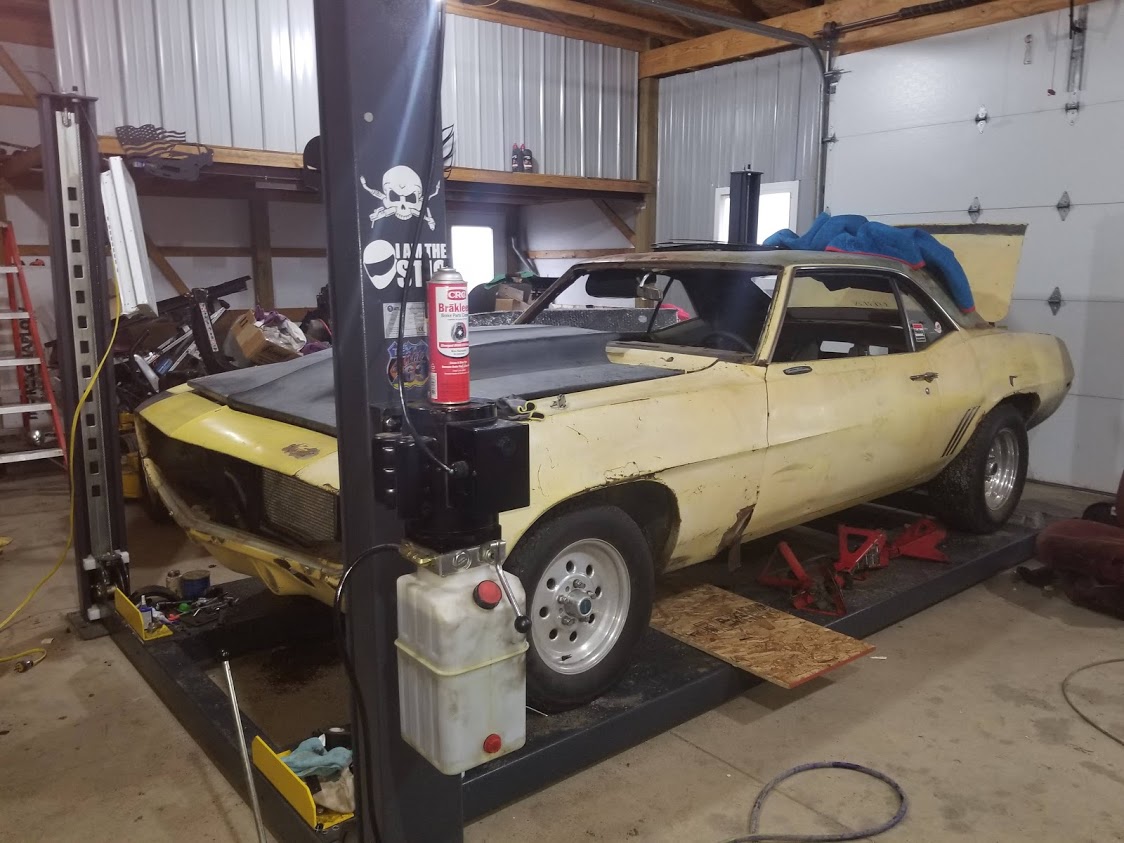

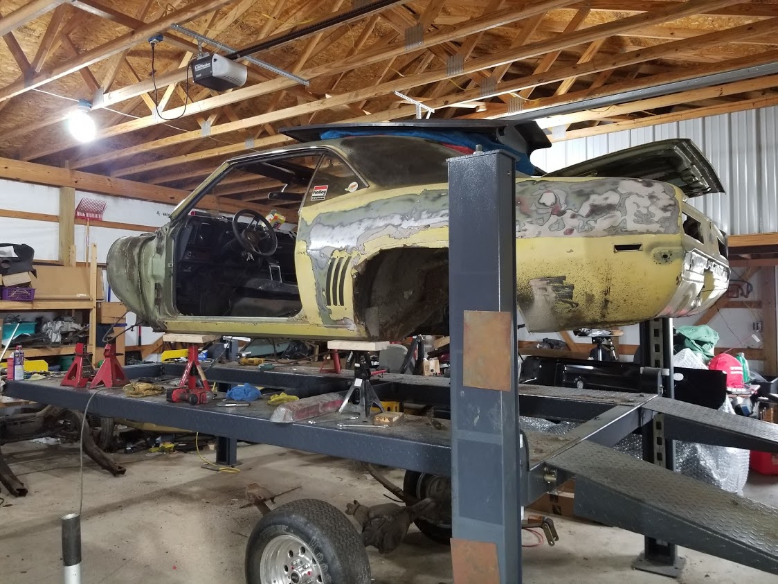

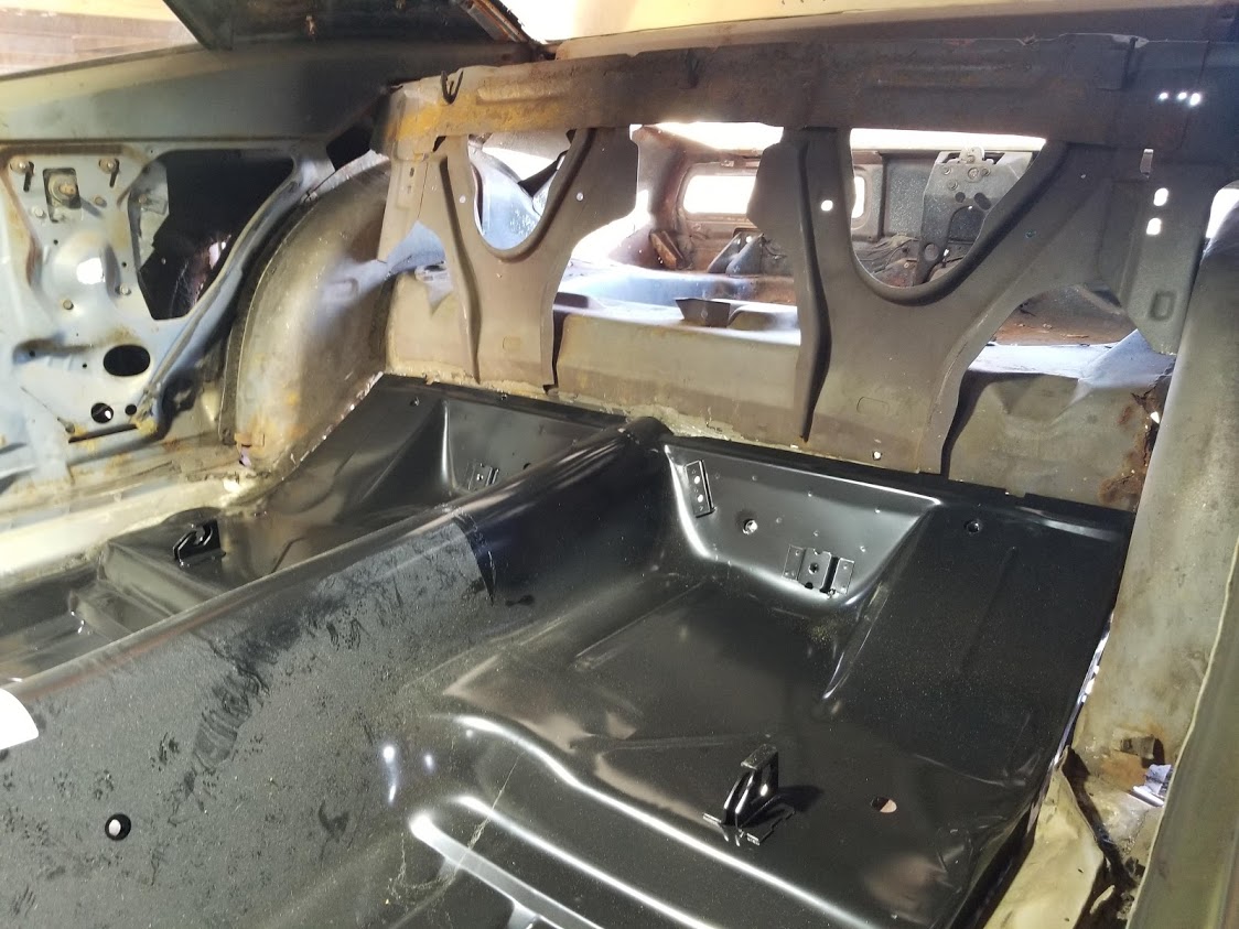

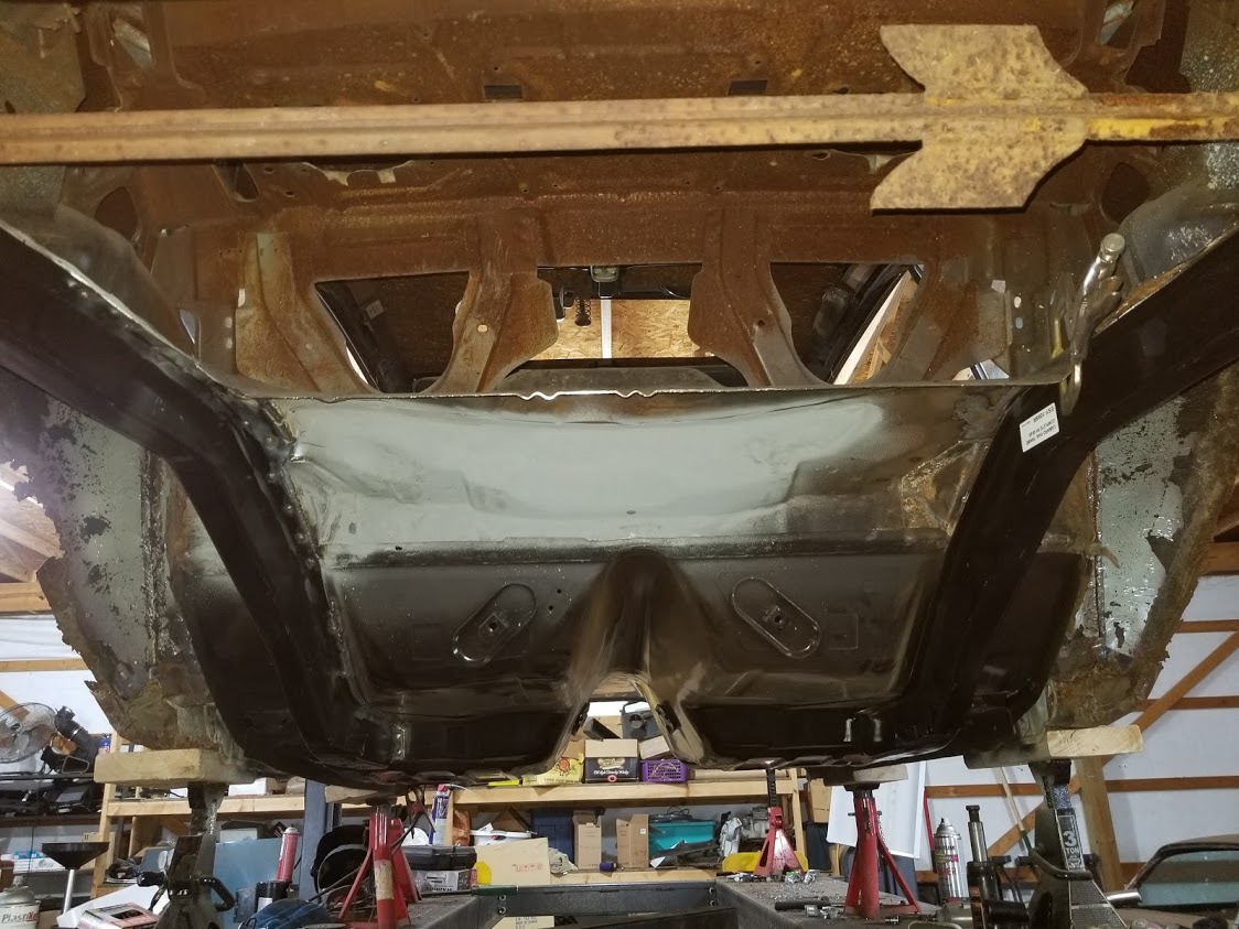

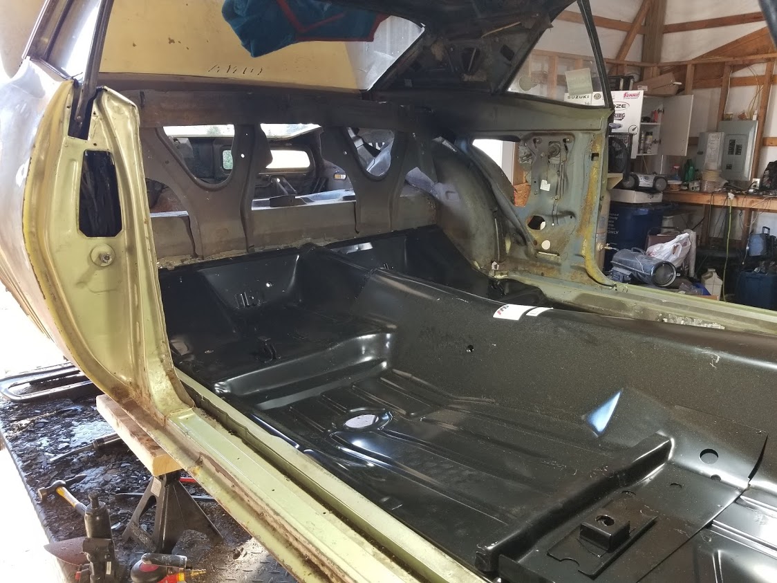

      When I was last on here I had the floor in place and the toeboard patches. A friend came over and asked if we were going to replace the frame rails. I hadn't planned on it until we thought of the power we were planning on adding. So I ordered new rails.

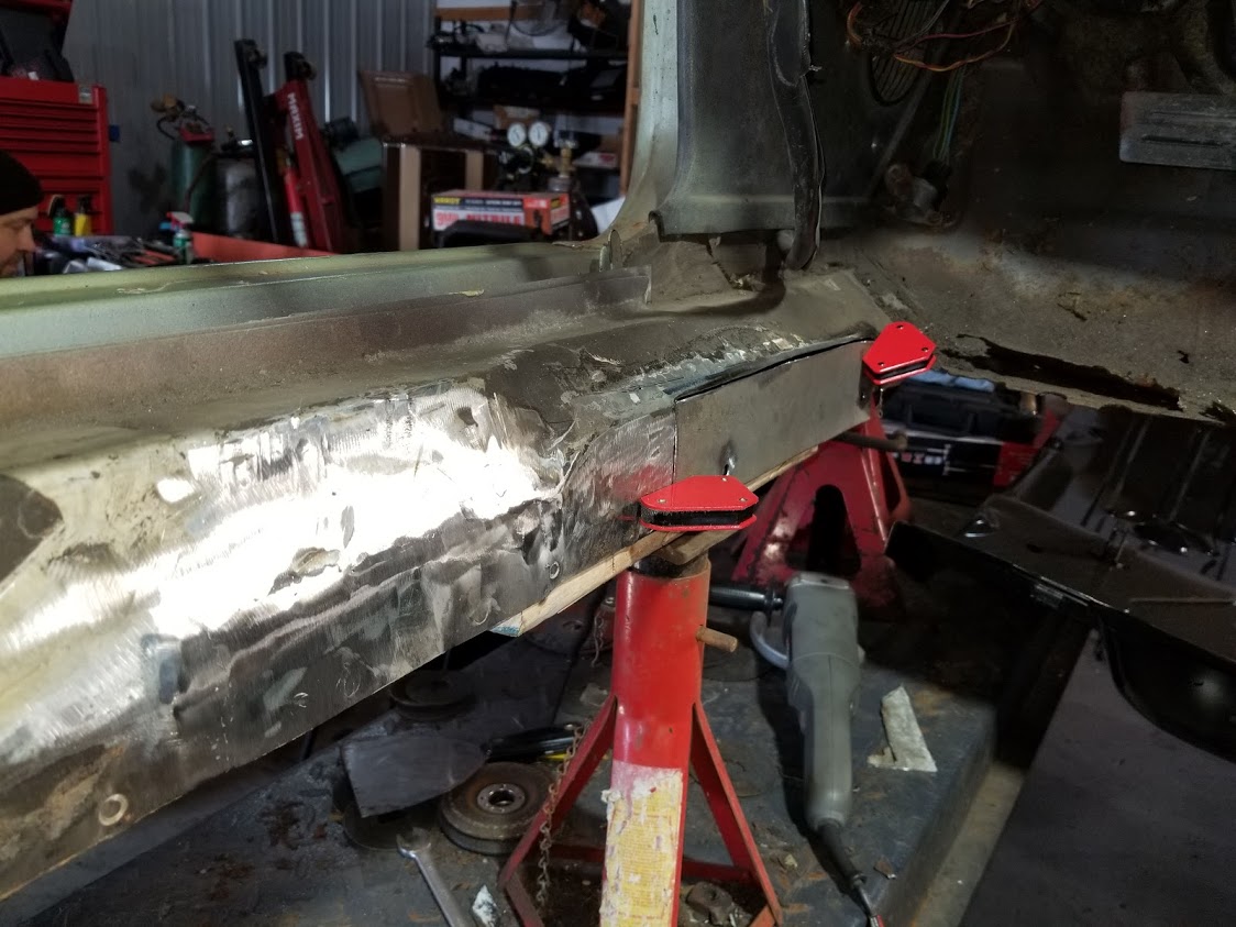

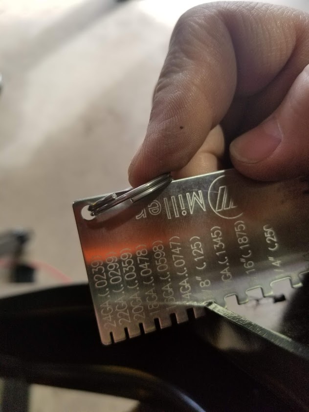

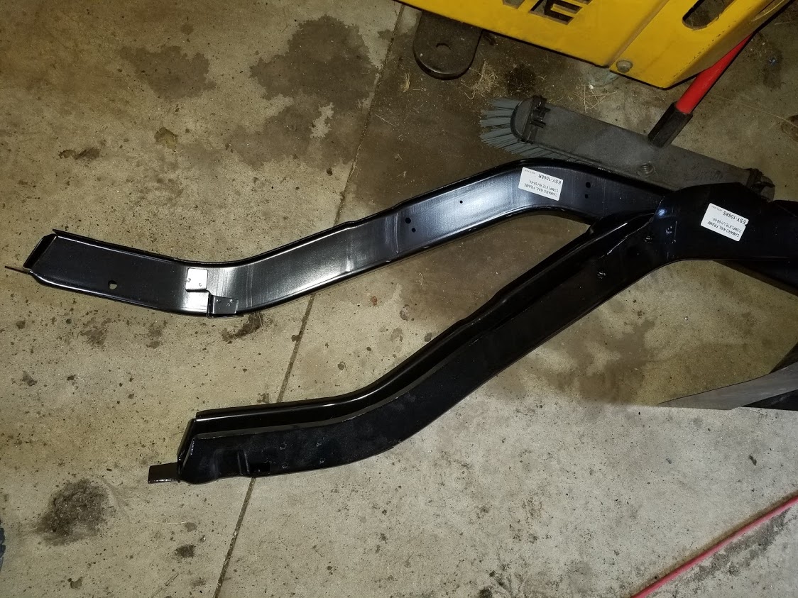

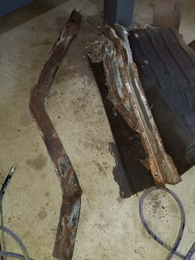

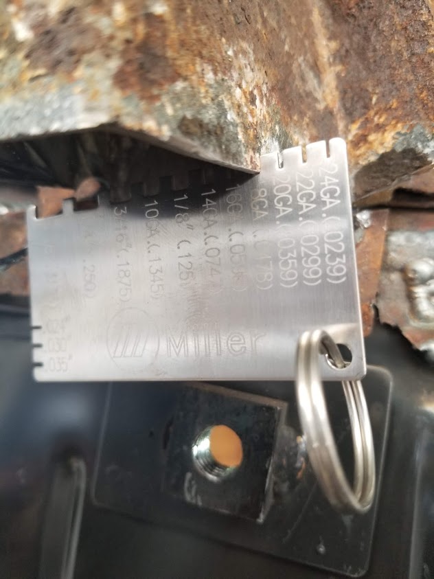

      I was talking to another friend about changing these and he asked if the rumor was true. I asked what rumor. He said the replacement rails were thicker the stockers. He was right!
      From 18 gauge to not quite 1/8" ! Definitely stronger and stiffer.

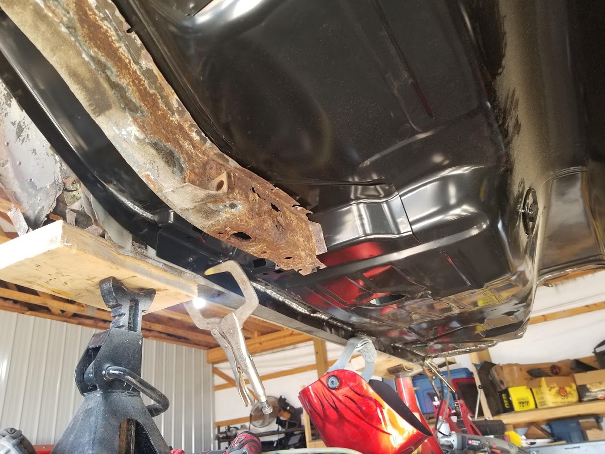

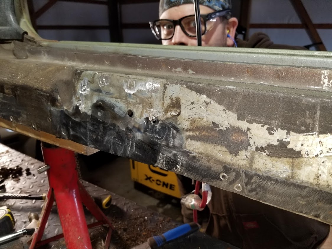

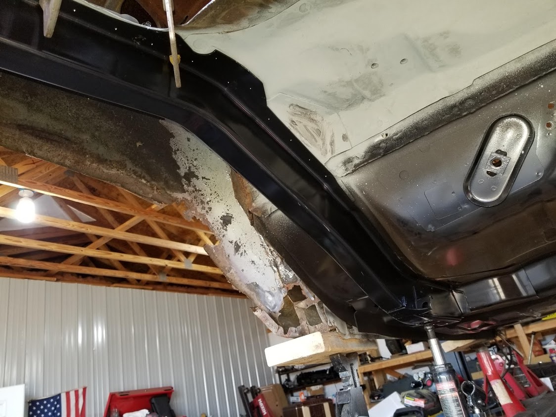

      Believe it or not, this rail looks crusty but it was only by where the brakeline was clamped to the frame. the rest was not terrible. But since we were in here...

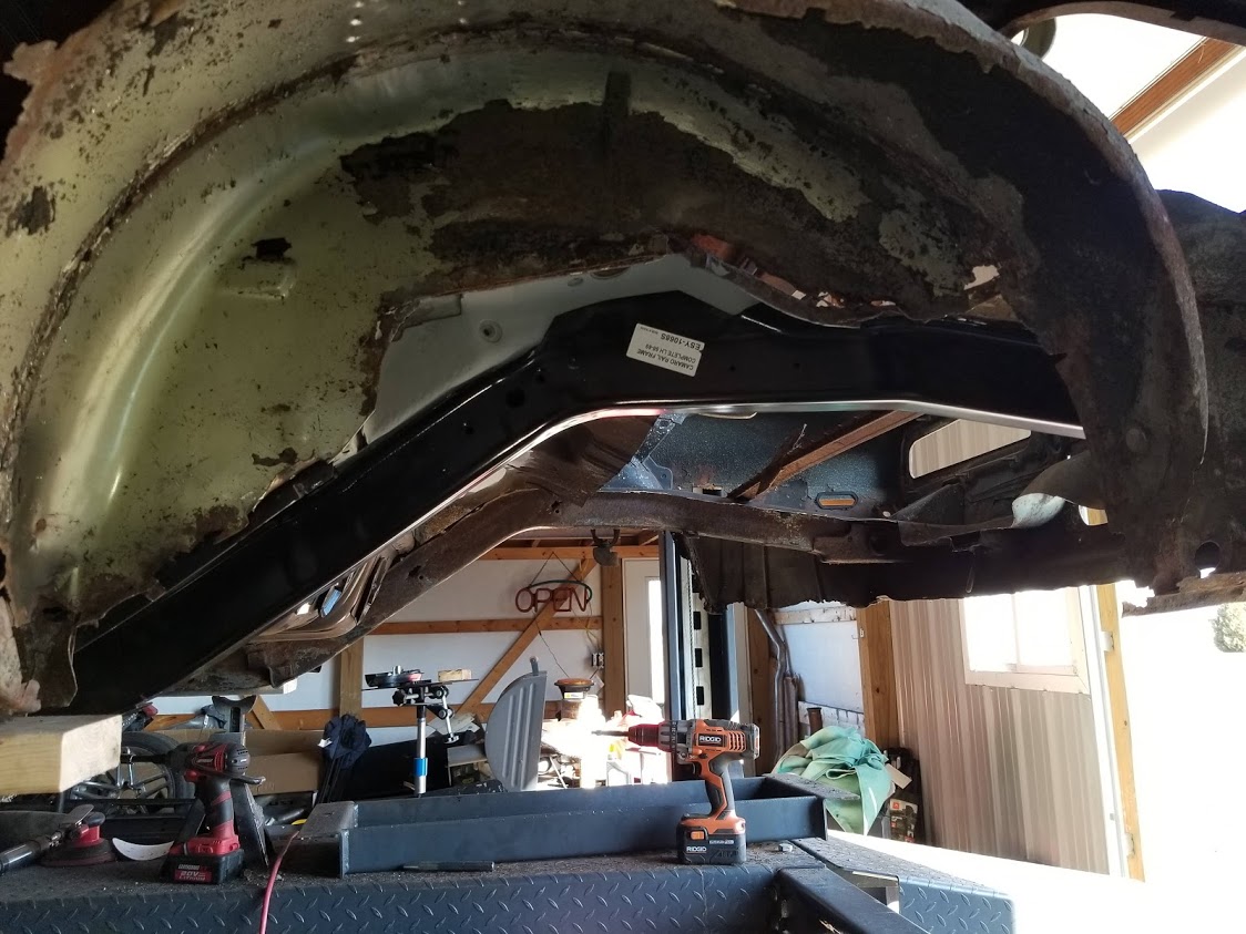

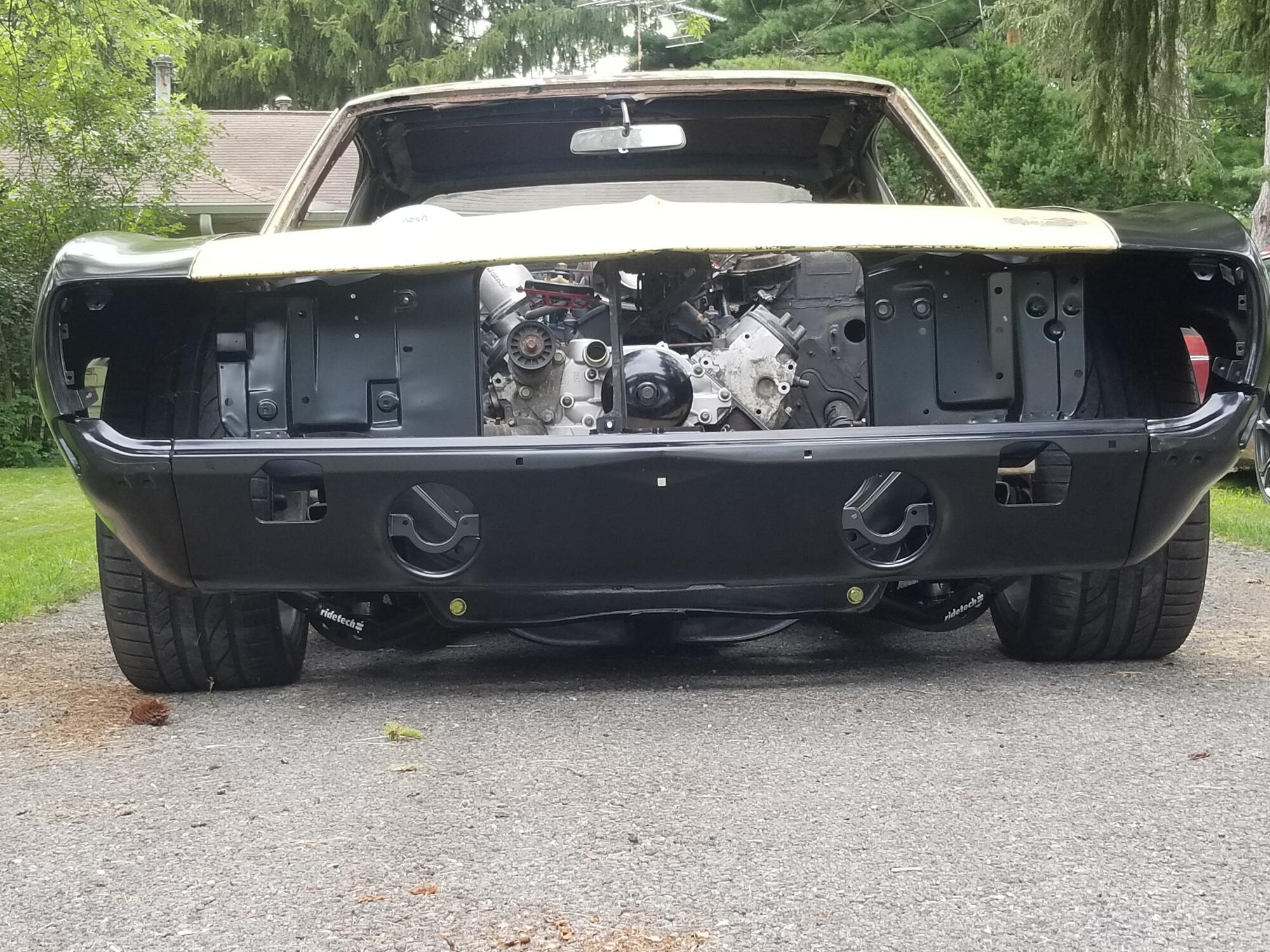

      When we started removing the undercoating from the wheel wells you can see how nice the original green was unfaded and protected. I hated the color when I had a '74 Ventura with the same color. Now my taste has changed. I actually like it quite a bit now. It may get painted the original color someday.
      Please excuse my frame rail brace. It happened to be the only thing we could find at the time without going for a drive for longer metal bracing.

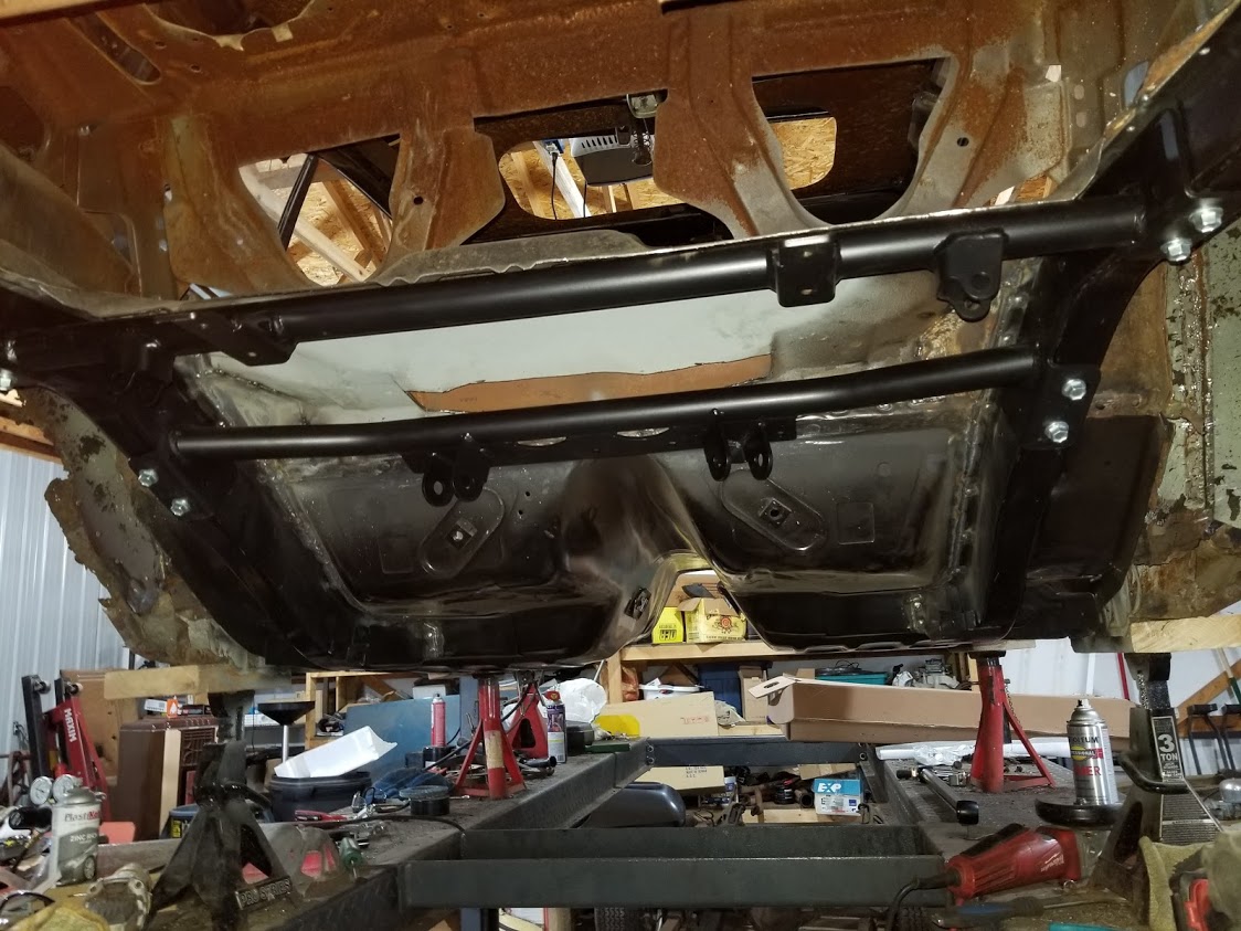

      And at the end we set the cradle in for the ridetech 4 link. Seeing the bracket in there got us really excited. Seeing some real progress helps. But, still a long way to go.

      In hindsight, I think a one piece trunk floor would've been a better choice. And like TankmasterJ said about his recommendation, I wonder if the one that is already notched with rails might be an even better way to go. Probably is. But, I was trying to fix things on my tight budget , since I got a decent deal on a drop in trunk center section. I probably spent close to or more than the $300 for the one piece trunk floor, buying all the fill / drop panels and tank supports. But it might have saved a bunch of time and aggrivation using the one piece setup.

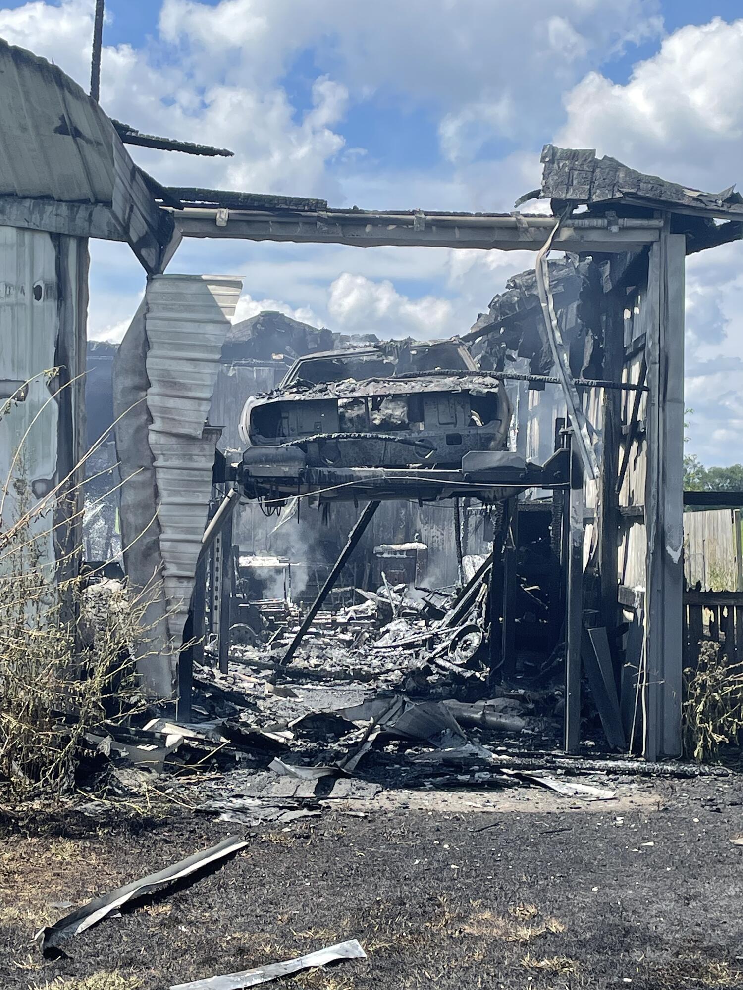

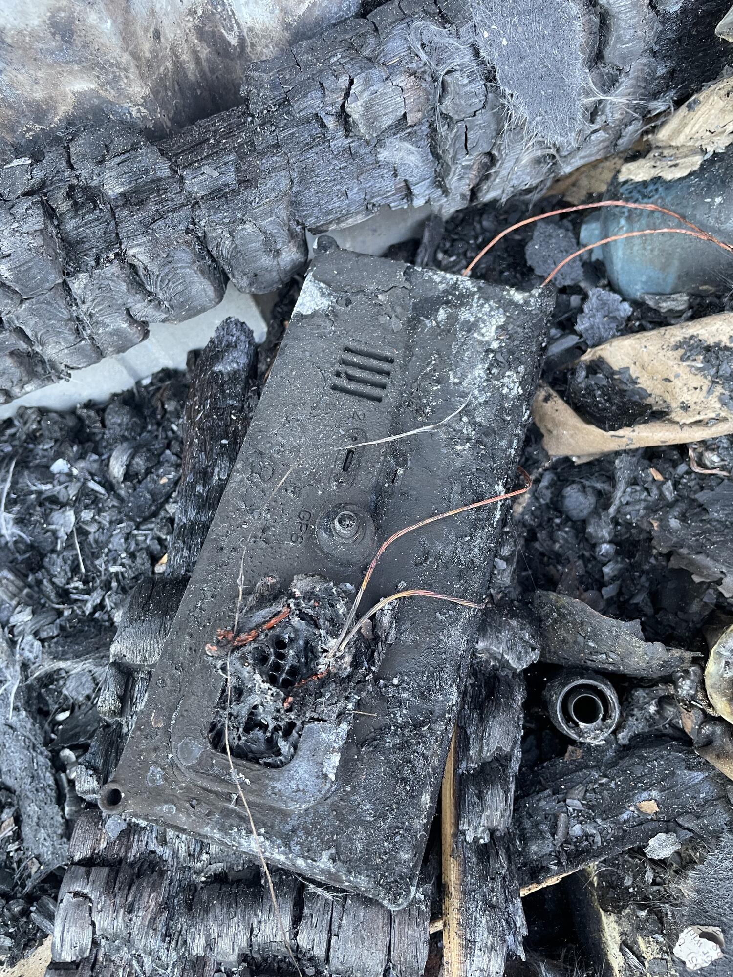

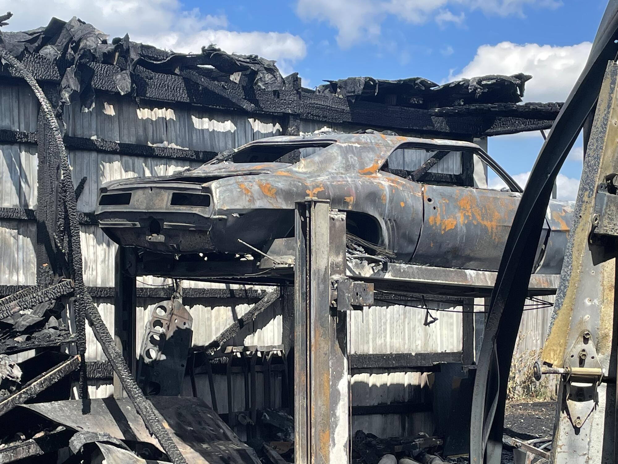

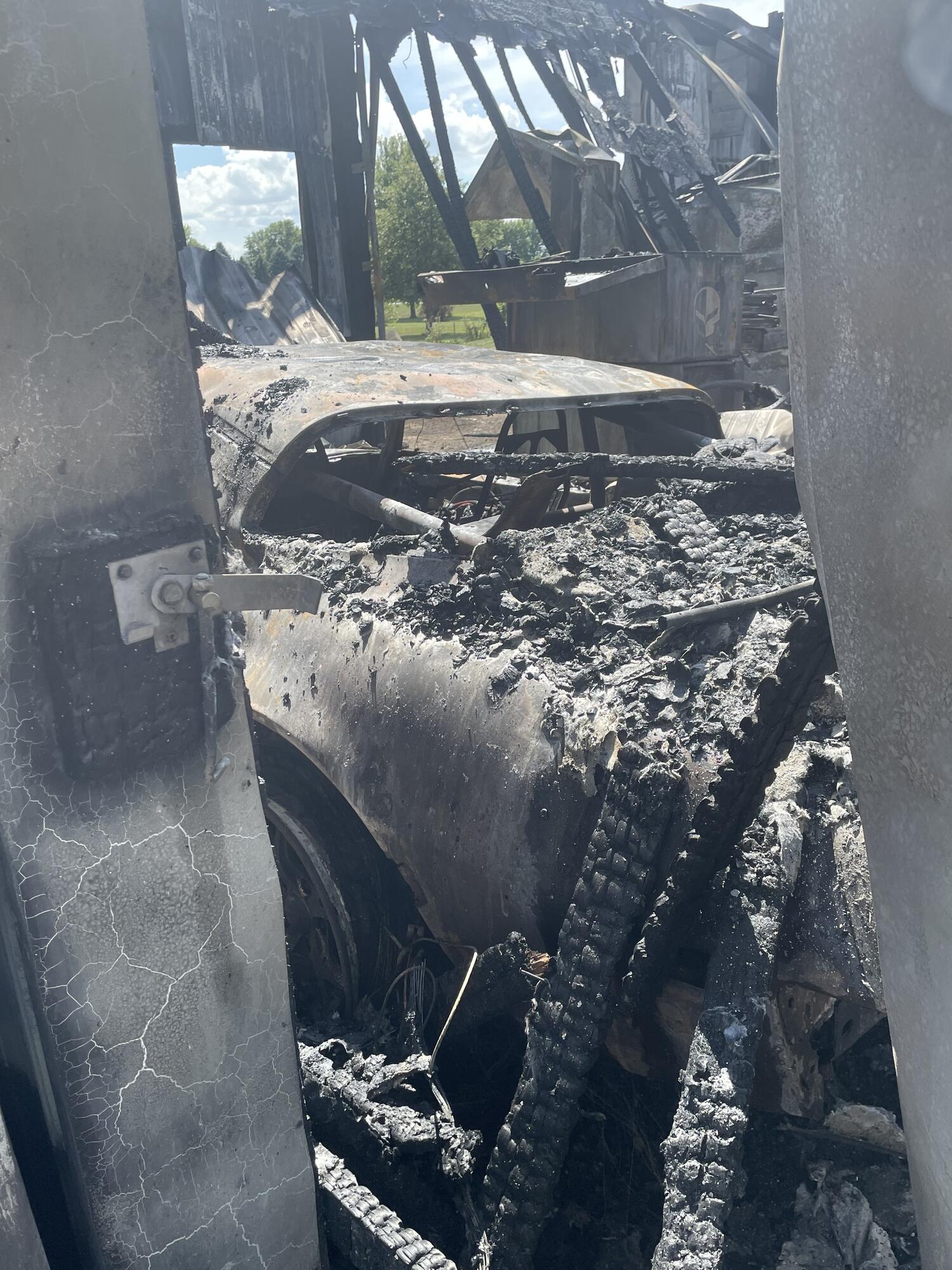

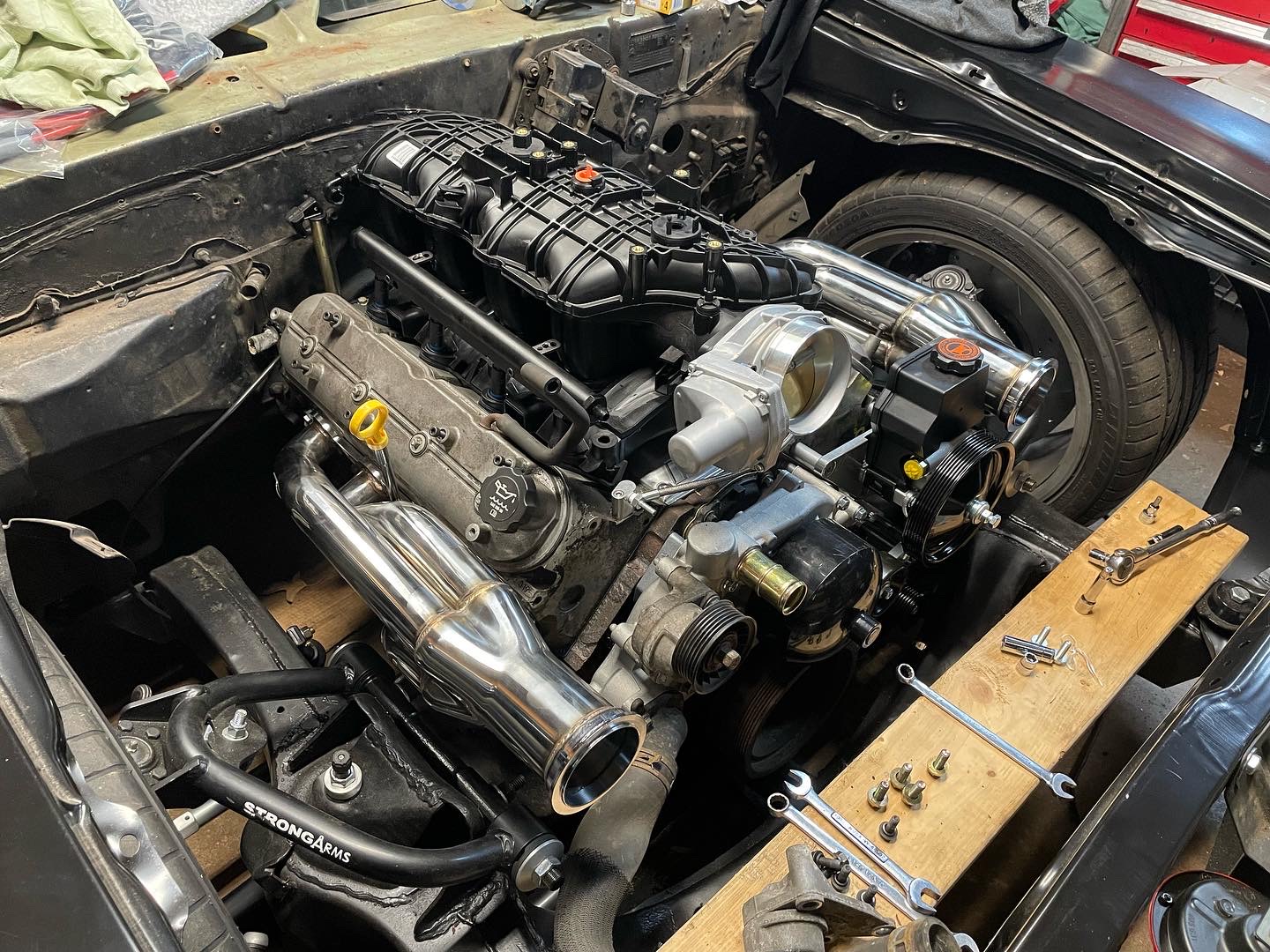

      This was July of 2021 and not much changed since then. I bought a c10 and started ls swapping it for a work truck.

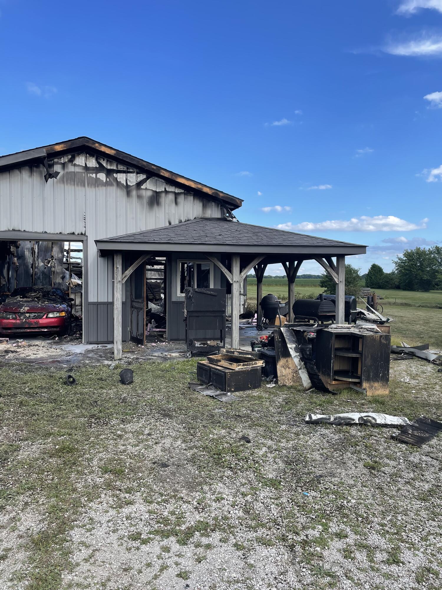

      So fast forward to last month, and the pole barn my friend and I were doing car stuff in caught fire and burned down.
      Thankfully no one was hurt or killed. But our cars did not survive.
      We lost my camaro, his 78 Trans Am and a 99 Mustang GT.
Size:  458.9 KBName:  81CED759-BEB4-435E-948B-C1151C0ADA3C.jpg
Size:  454.0 KBName:  53AD1C5C-3A23-4B3C-8AFE-D3D3FD9DBB93.jpg
Size:  504.6 KBName:  2BAB6B25-371D-4BD9-A3B2-A060B3C3621A.jpg
Size:  552.1 KBName:  4AAEC1E8-6ADA-4D7C-B647-23E278BCB633.jpg
      Like I said it’s been about a month and things are settling down a little. It still hurts to see the loss here but I’m posting this as a warning to everyone.
      Check to make sure you have insurance coverage for any car you have even if it doesn’t drive. If you value the car it needs some type of storage or agreed value policy. If it’s a car or associated restoration parts, they are only covered under an auto policy and not homeowners or personal property clauses.
      And those with exterior outbuildings double check your coverage on those as well. These are the battles we are dealing with now.
      insurance people don’t think or value the things car people do. They didn’t cover old or rare vehicle components like transmissions or spare engines but over valued small things like spray cans, paint, lubricants, cabinets, garbage cans, shovels, lawn equipment etc.
      It’s crazy.
      I have plans to start again on a project. I can’t quit now. My friends and fellow gearheads won’t allow it.

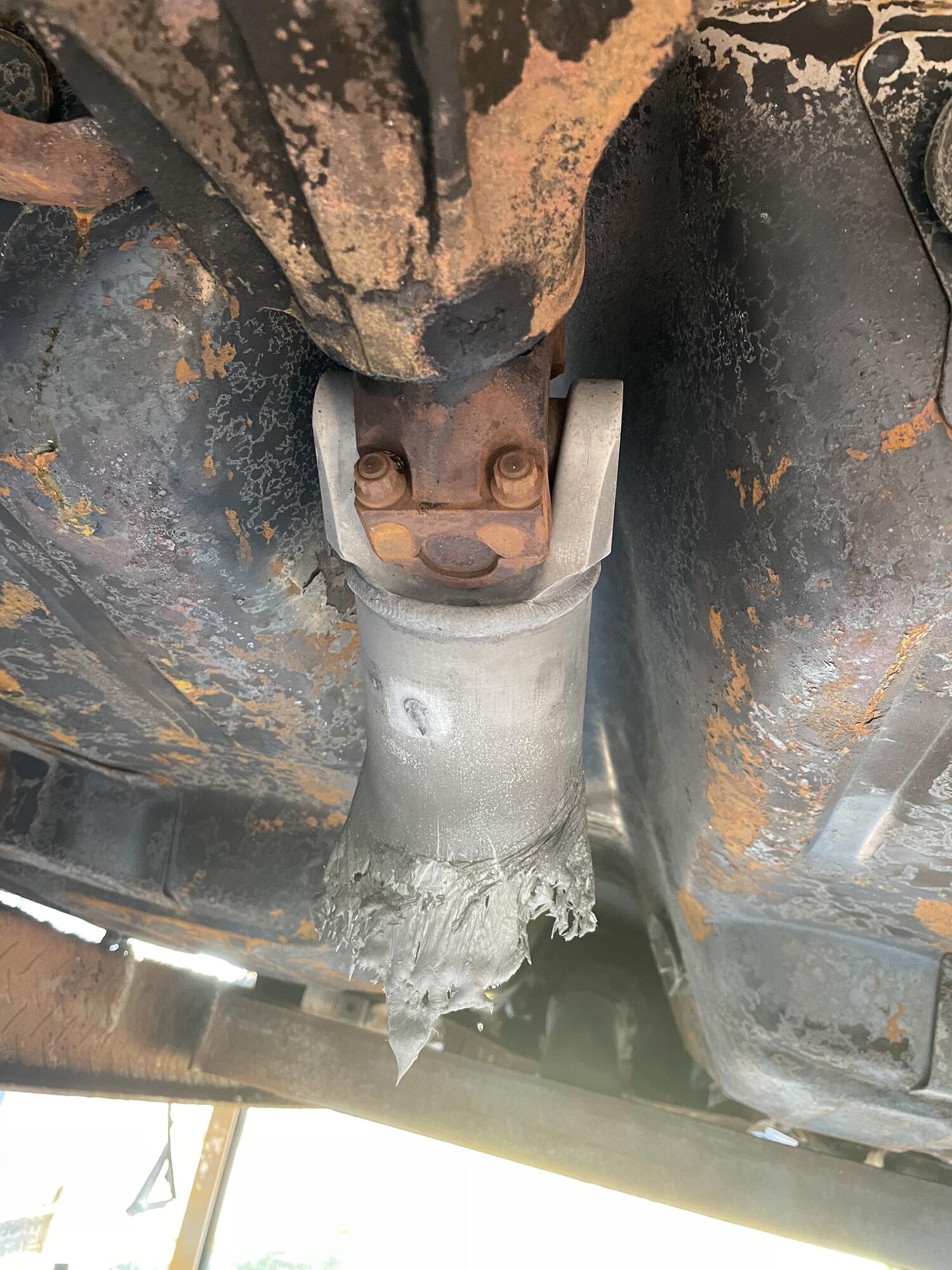

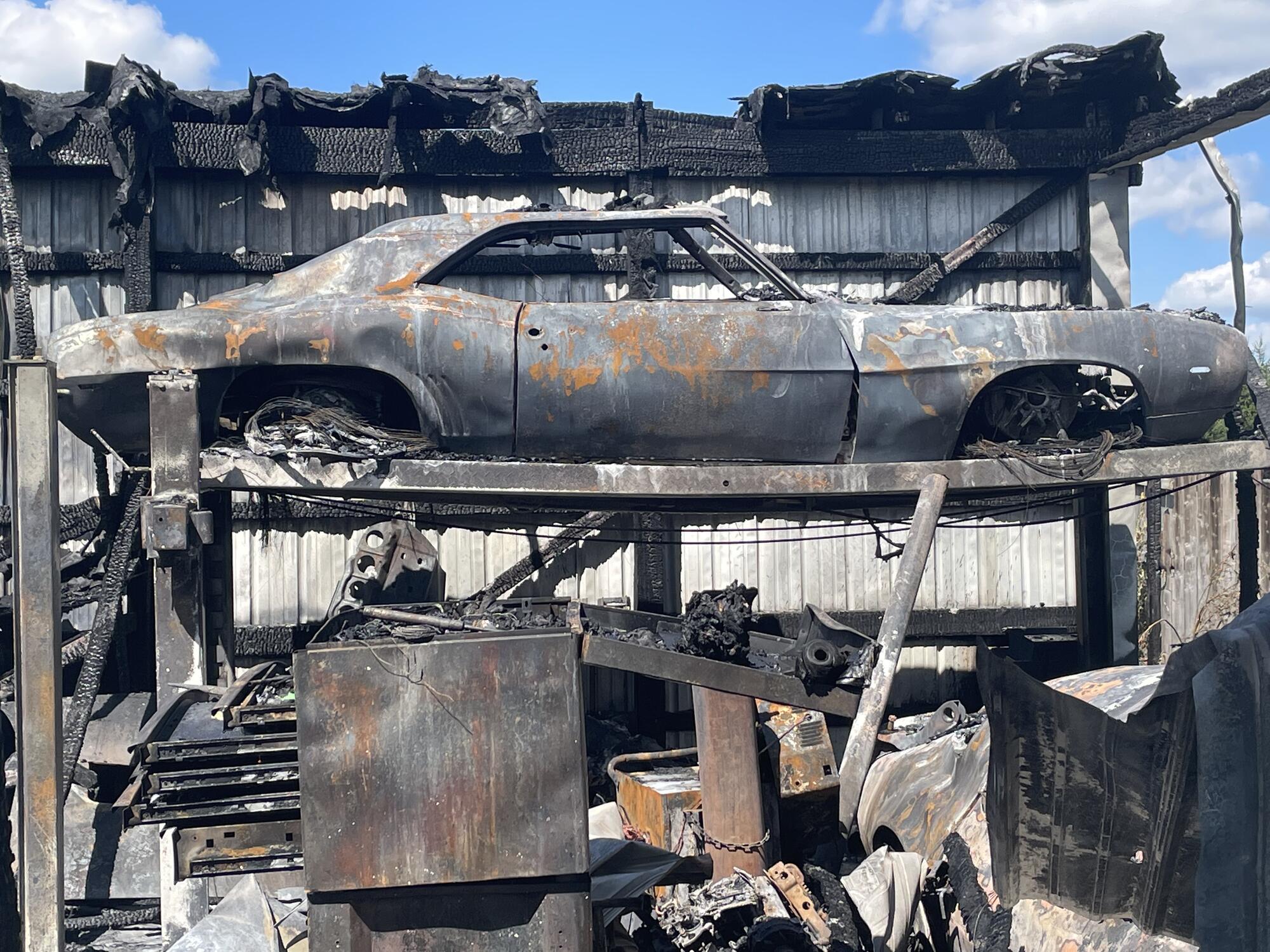

      I had all the suspension done with air ride ridetech. New brakes from Kore3 and Rockauto parts. 5th gen camaro Brembos. 6.0 LS motor, 4l80e trans, Action Machine driveshaft, tons of parts and it was close to running. Holley terminator x max and the digital dash that fits this car.

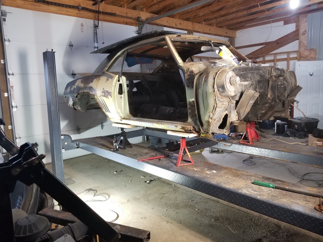

      I’ll try to salvage what I can from the car. But it isn’t much. The body was not only cooked but the roof probably fell on it too.
      I’ll get more pics when we get the car down from the lift. Someone is donating some time with an all terrain fork lift to help lower the car down. It’ll be a challenge for sure.
      I’m hoping the vin and trim tag are still on the shell. We’ve been talking about getting a Dynacorn body. It seems somewhat affordable compared to buying a complete car. The market for 69’s is INSANE.
