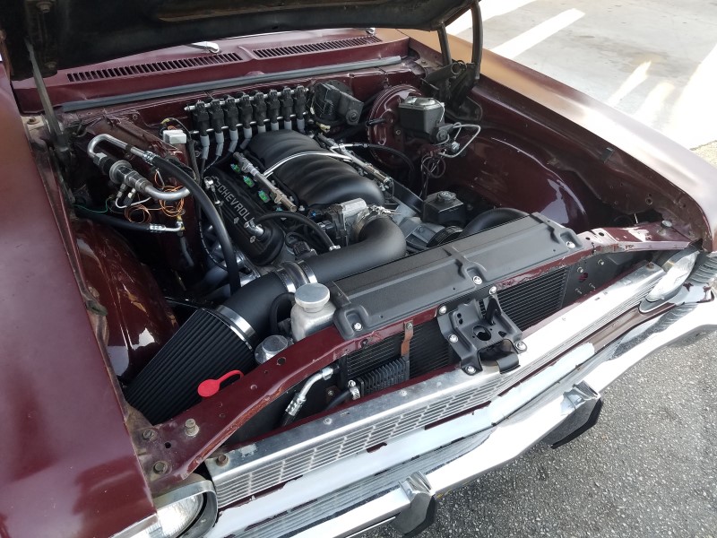

      Above I assumed you wanted to convert the system to run as a clutch cycled orifice system using the 2000 Camaro operation, since you've already retrofitted the evaporator coil into the factory suitcase. If you stay the course, you should setup the system to operate as a clutch cycled, orifice tube system exactly as it operates in the 2000 Camaro as I described above. That arrangement will automatically run the clutch, fans and adjust idle through the computer. The factory 69 controls would still run the blower fan, ducting, and recirculation functions (via the vacuum control valve) while relying on the computer to drive the other functions.
      If you want to use a factory TXV+POA arrangement, I can explain how that system functions and outline what needs to be updated to make it work well with r134a. I just read you have a spare suitcase, so you may have the option to make this function like an original factory system if you want to go that oute. I have a factory non-cycling TXV + POA system in my Nova and it works very well.
