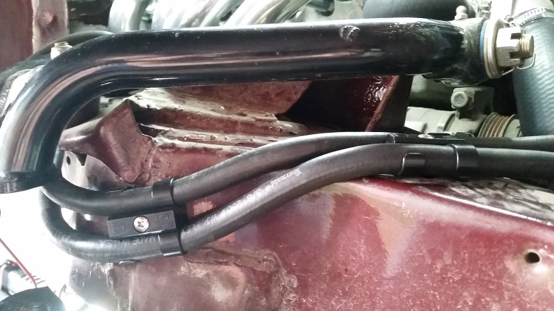

      I used Summit push lock hose for my TH400 cooler lines. I ran them along the top and outside of the frame, carefully routing where the suspension wouldn't interfere.
      This has been fine the last 5 years.
