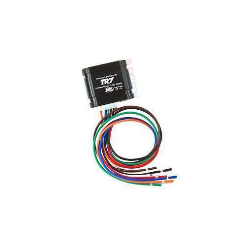

      And here's another option - a PAC TR7
      Programmable inputs- pos or negative- timed - push the button once-on -then twice off- so I could certainly do what you are wanting-and you can sequence the outputs and time them.
      I used it for my door locks(among other things)- where as one button would lock/unlock doors-push once locks- twice within a programmable time and it locks- has 4 outputs
      https://www.amazon.com/PAC-TR-7-Univ.../dp/B0002J22BO
