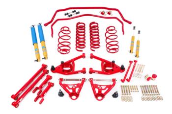

      So...I spoke with the builder about nixing the 2" drop spindles and he recommended the BMR package below (with 2" lowering springs) as a cost-effective alternative using the stock spindles. Since the GTO already has 1 1/8" front/rear sway bars, might nix those and the rear control arms, since this won't be a full-on autocrosser, just better steering/cornering than stock and dropped 2". That puts the front upper/lower control arms, front/rear 2" lowering springs and Bilstein shocks @ $1100. Full package is $2100.
      Has anyone used this kit and/or can comment on the approach, given my budget/goals?

      X2 on the drop spindles, don't do it. The BMR kit you picked should do well for a nice sport suspension. On my '66 GTO I'm running BMR upper/lower arms with tall joints & standard spindles, Hotchkis drop springs front & rear, Hotchkis boxed rear arms with adjustable uppers. Bilsteins front & rear. The car handles great, corners flat and has a fairly plush ride. Your going to want the adjustable uppers to correct pinion angle after dropping the rear.

      Did not think about the difference in pinion angle with 2" lowering in the rear. The kit has non-adjustable rear upper control arms...guess I need to replace with one of their on-car adjustable versions. Looks like they have 5 versions with 3 variations here (poly bushings, spherical bearings and rod ends) for 68-72 A-bodies...not sure which is necessary for my application. Sorry guys...new to this end of things.

      Also be aware that when A-bodies are lowered in the rear it causes driveline issues that cannot be corrected with adjustable rear upper control arms.

      Okay...what method would correct the driveline/pinion angle changes with a 2" lowering spring? Not looking for a raked look.

      You can either raise the back of the transmission, but that will be limited by the floor pan, or you can get a CV driveshaft, like I use in my GTO and my Cougar. Obviously, you can also modify the transmission tunnel.

      Marc at SC&C told me that a 1" drop in the rear was the most you ever do without screwing up the handling.
