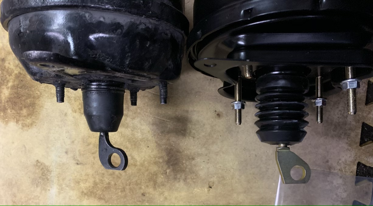

      Back in the fall I had the car ('68 Mustang, 390) at the local performance shop, doing the alignment after I'd installed coilovers etc. While there, they noticed the brake booster had a vacuum leak, and ordered in a replacement. By the time it came in, I had the car home for the winter, so just paid for the booster and brought it home. This weekend I've pulled out the old one and started to install the new, but they are not exactly the same. The new part is from Leed Brakes, and is to fit 67 to 69 models.
Size:  401.7 KB Name:  IMG_9410.JPG

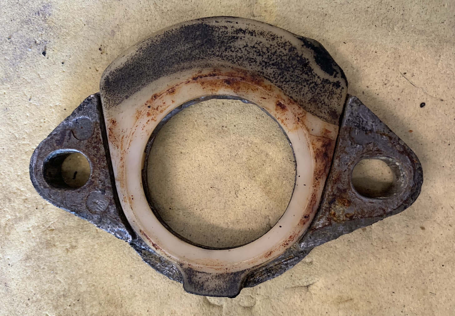

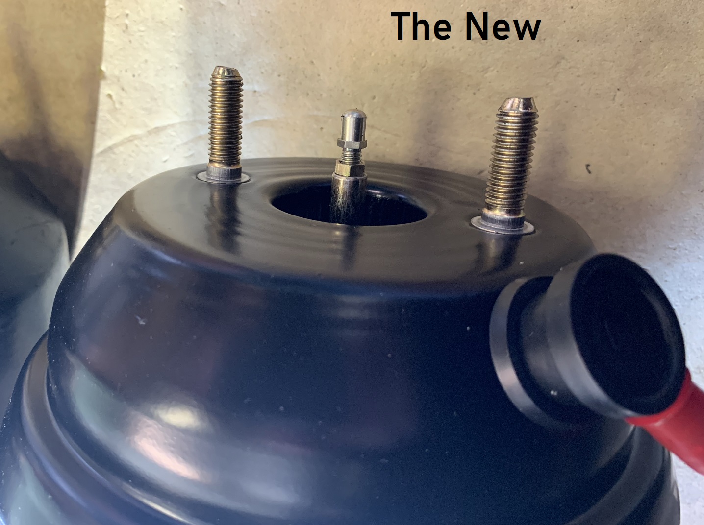

      As you can see, the pushrod sticks further out of the old one, and a major difference is that the old unit has a rubber seal that a spacer sat over. The spacer is rebated for the seal. The spacer also serves as a vent to allow airflow into the unit. The new unit did not include a spacer.

      Trying to slide the master cylinder over the studs, the spacing is off just a hair. The holes could be opened with a die grinder to make it fit. I noticed that the holes on the old spacer were already oval, and would slide over the studs on the new booster.
      So - will this unit work? With the spacer or without? Any guidance from someone who's dealt with this would be really appreciated.

      I guess I want to know what the pedal pushrod is doing with the new and old booster.
      Pretty similar, both are the teardrop style. Hard to judge if they are exactly the same length once bolted to the firewall, but the new one is adjustable.
