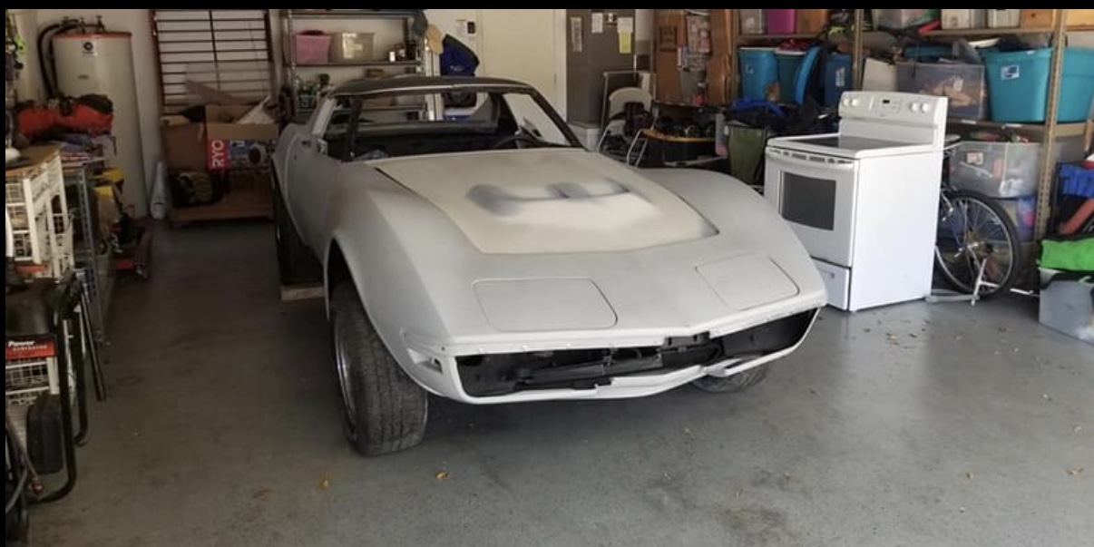

      Here’s the starting point. It’s basically a basket case, but it’s mostly there and the body and frame are in good shape.
      (This is not my garage and not my oven)

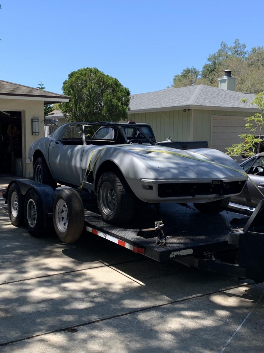

      This is us leaving to bring it home...holy parts.

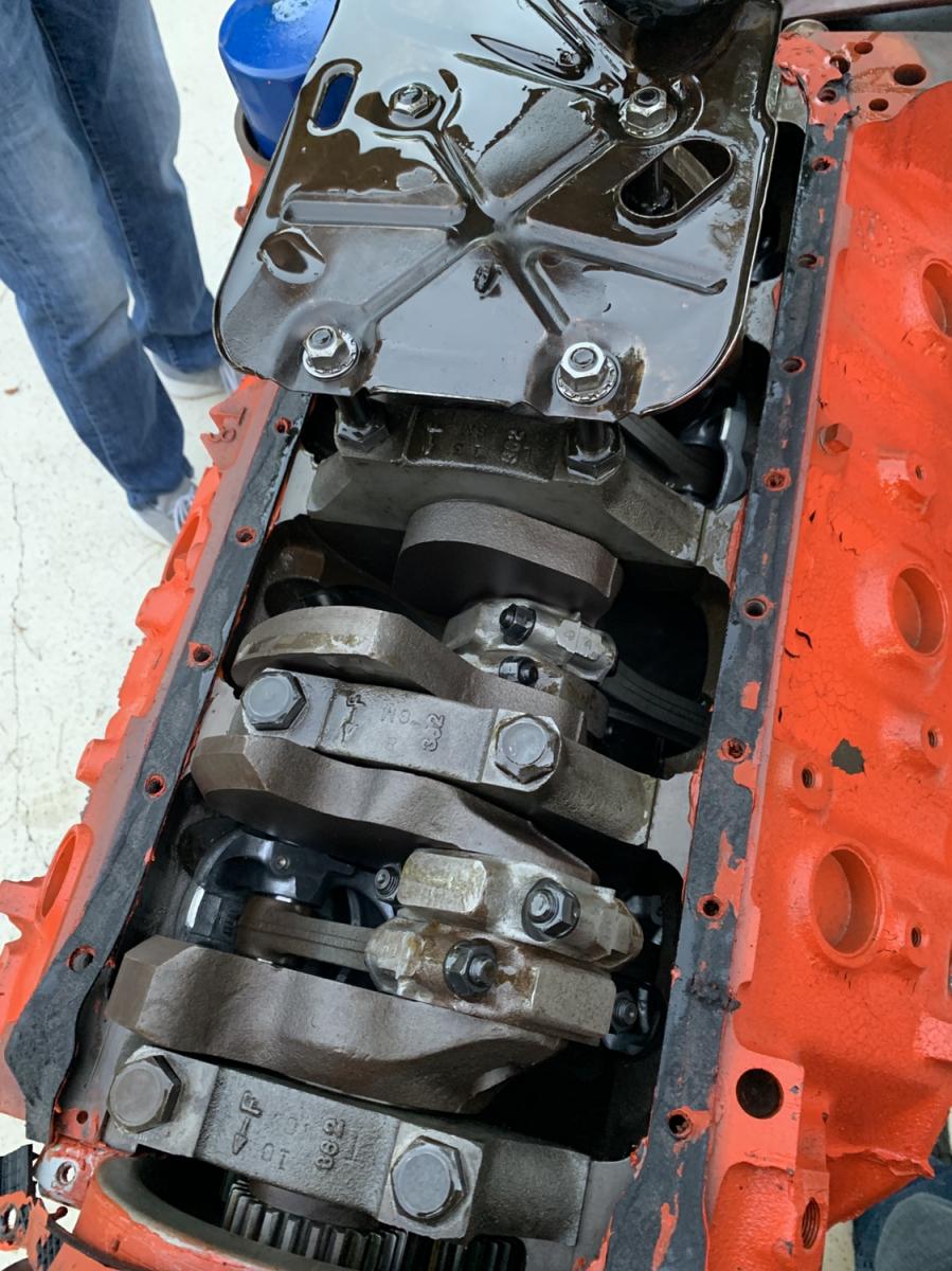

      I had to open up the motor as soon as I got home. I was super worried about it because it’s been sitting for over a decade with no spark plugs installed, and I expected the worst. It was in great shape after all. I’ll still break it down and check it all out. Bigger cam going on, new springs, pushrods, etc. But overall, I was pleasantly surprised.

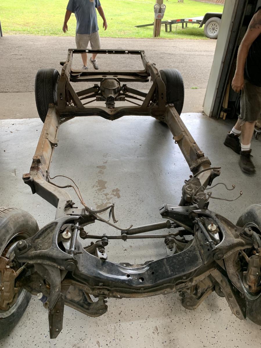

      First course of action was to get the body off the frame and to get to work on the chassis rebuild. I’m going to break it all down, sand the frame and paint it with POR-15. Then I’ll go through all the individual components and sand or blast them and repaint them as well, using new bushings to put it all back together.
      Here we are pulling the body off:
      Going on a dolly (there’s a brace welded in to support the nose of the car. It’s hard to see. We’ll be adding braces at the rearmost body mount points as well.
      And here’s the chassis:

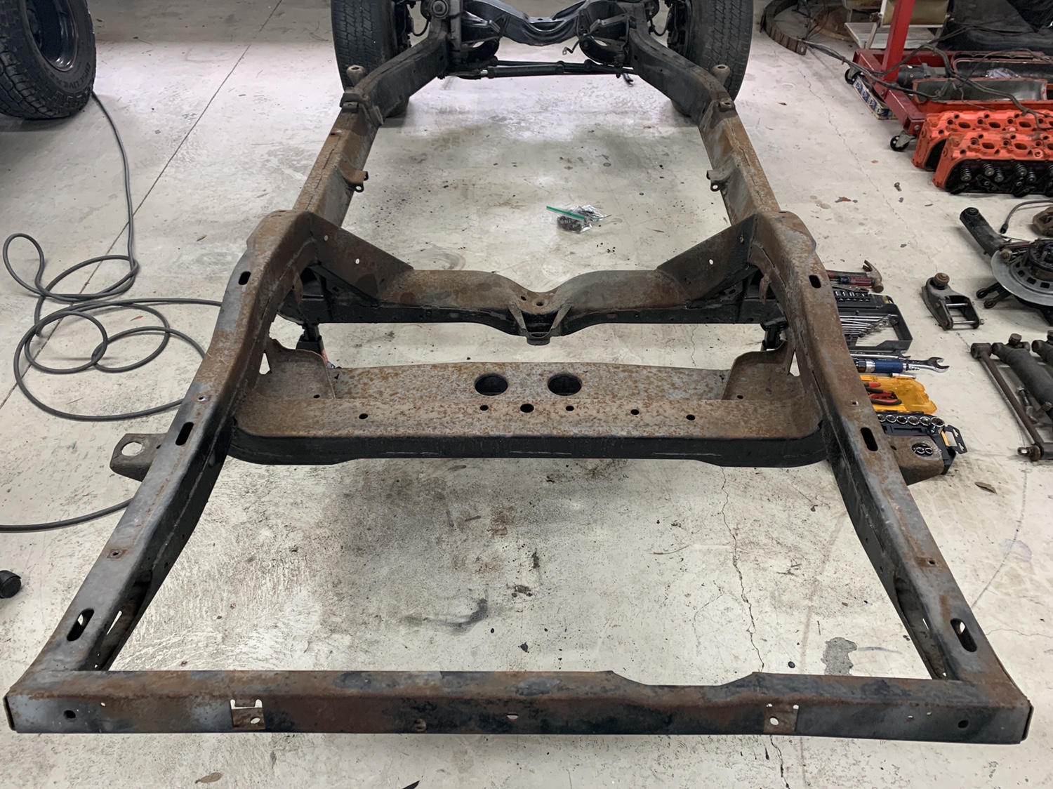

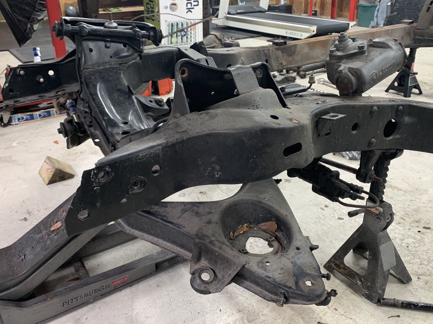

      Got the chassis home and it’s tear down time.

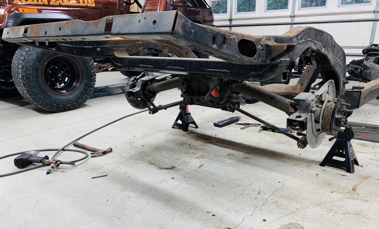

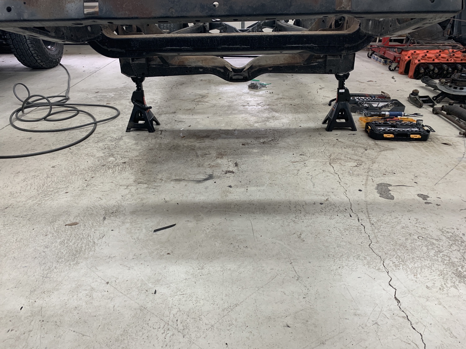

      Little more work breaking down the chassis today.

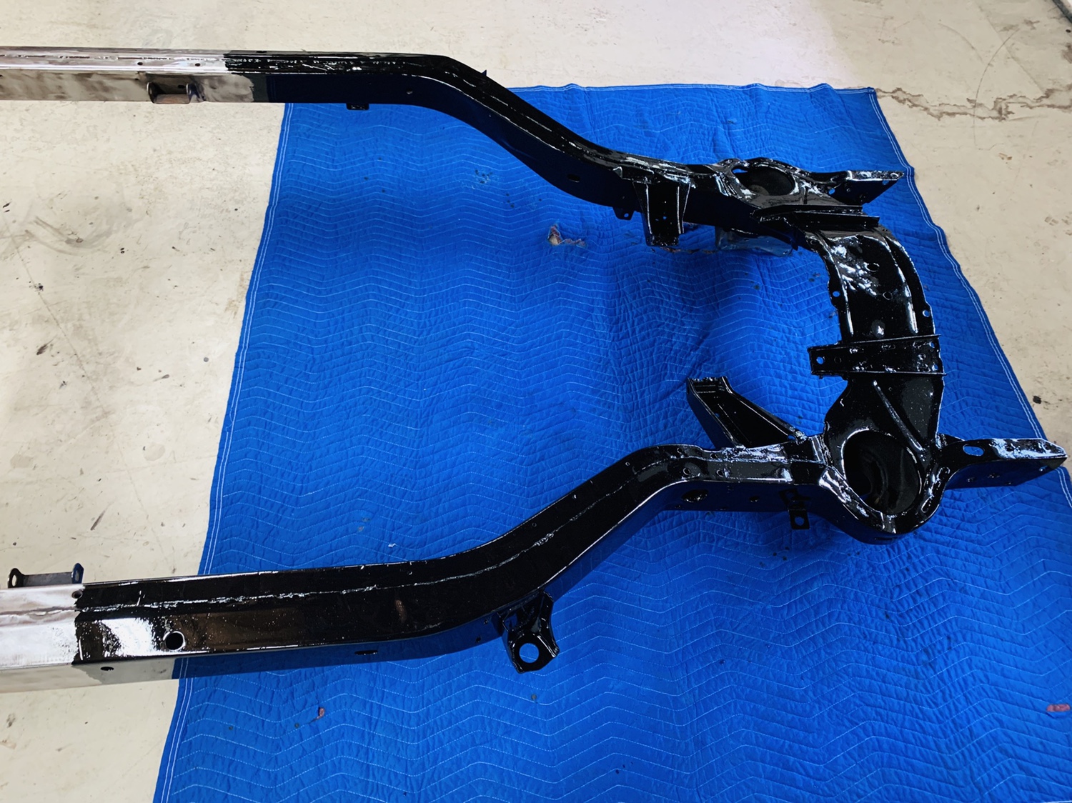

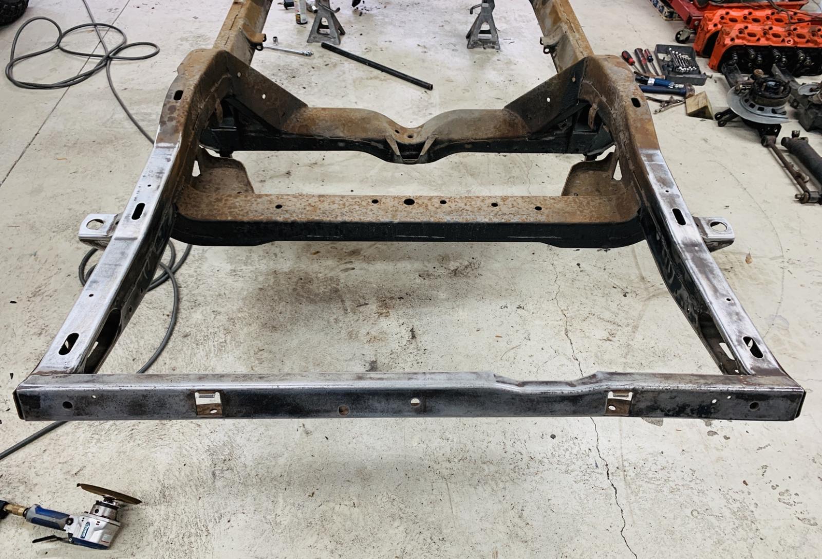

      And started grinding the whole thing down in preparation for coating it with POR15:

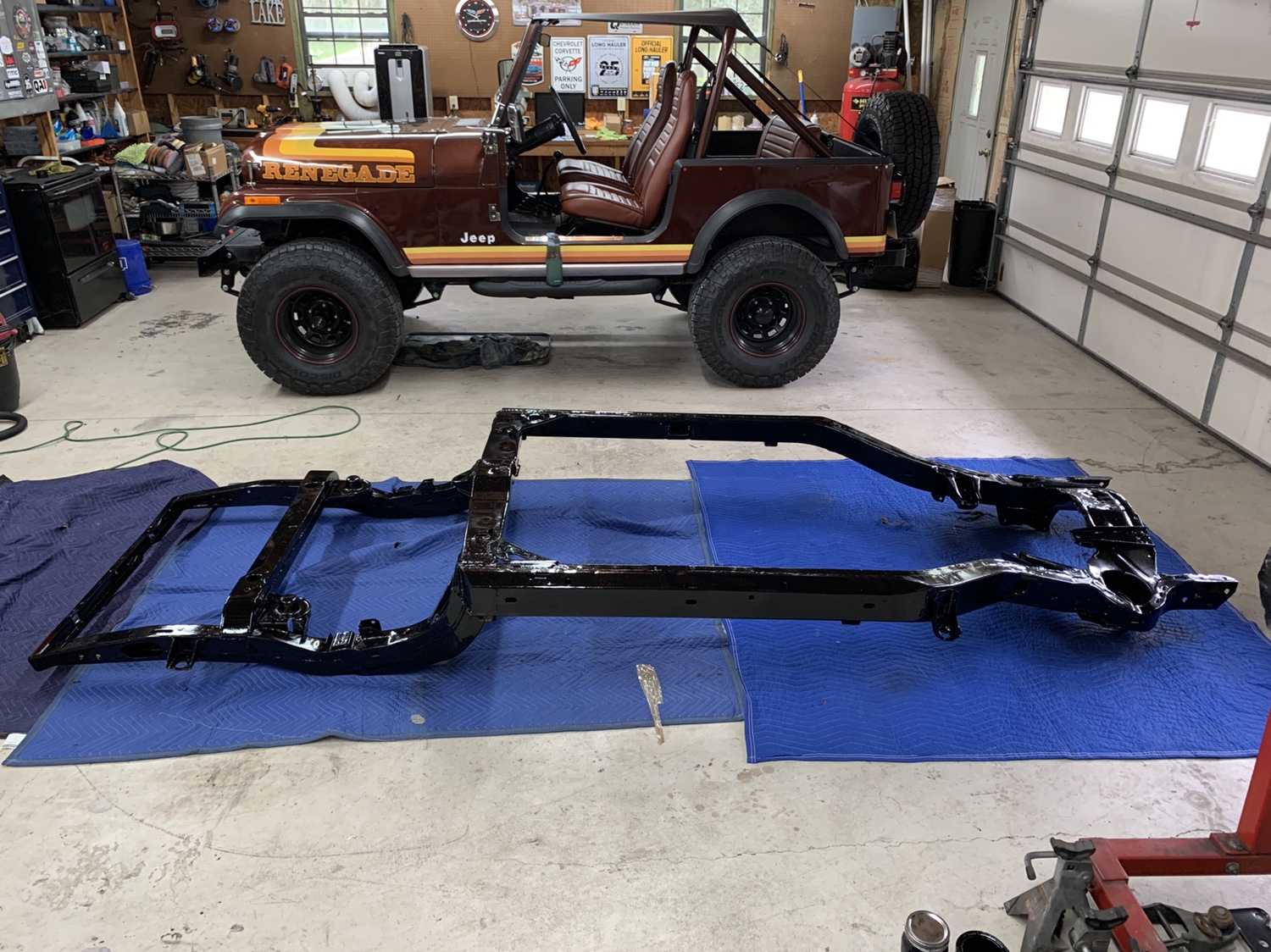

      Having the frame blasted would have been much easier and probably more complete, but I’m trying to keep costs down where I can. Ideally, a blast and powdercoat approach would be best, but I gave it a shot with gloss black POR15.
      This turned out ok, but I think satin black finish would have resulted in a more even and better appearing coat. Gloss looks good, but imperfections in the coating show like crazy. Not a huge deal since it will be under the car and you’ll only be able to easily see 5-10% of it at any given time anyways.

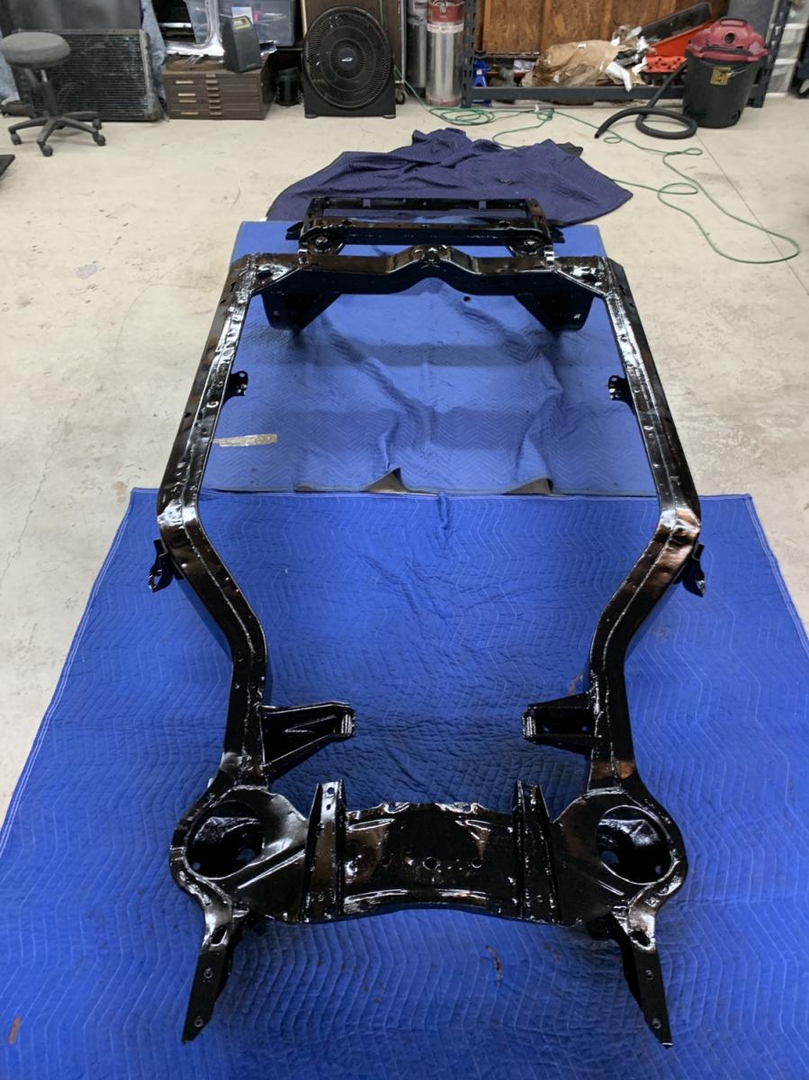

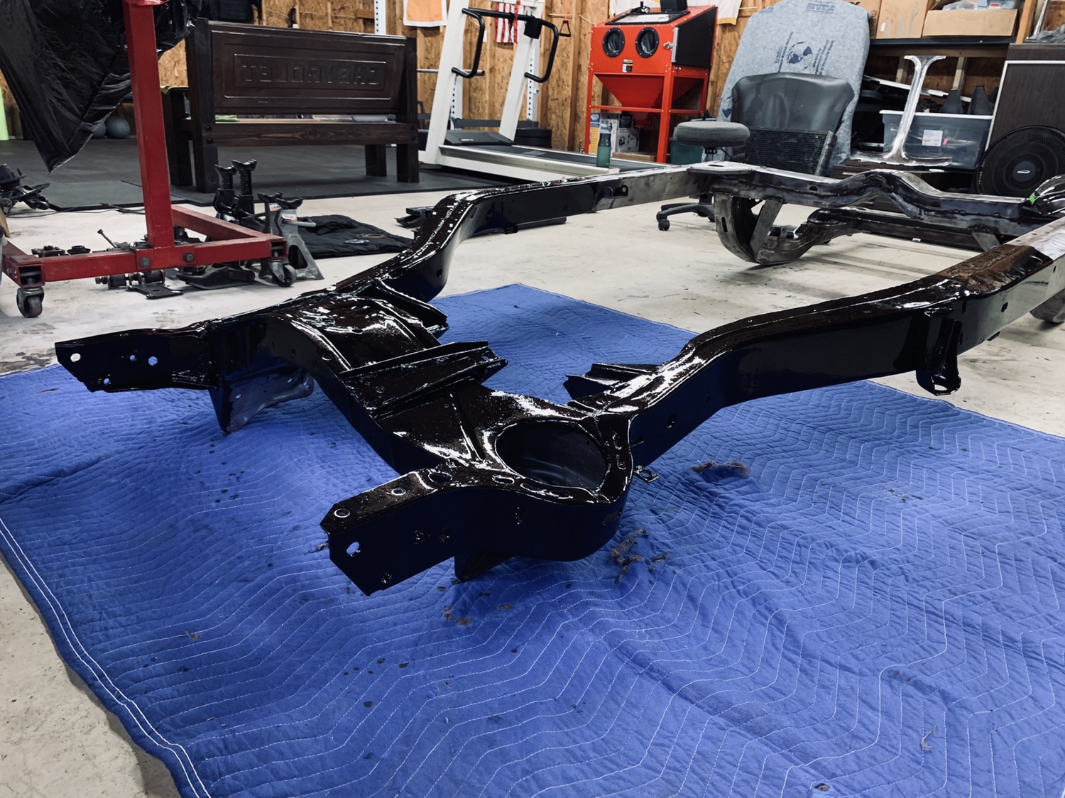

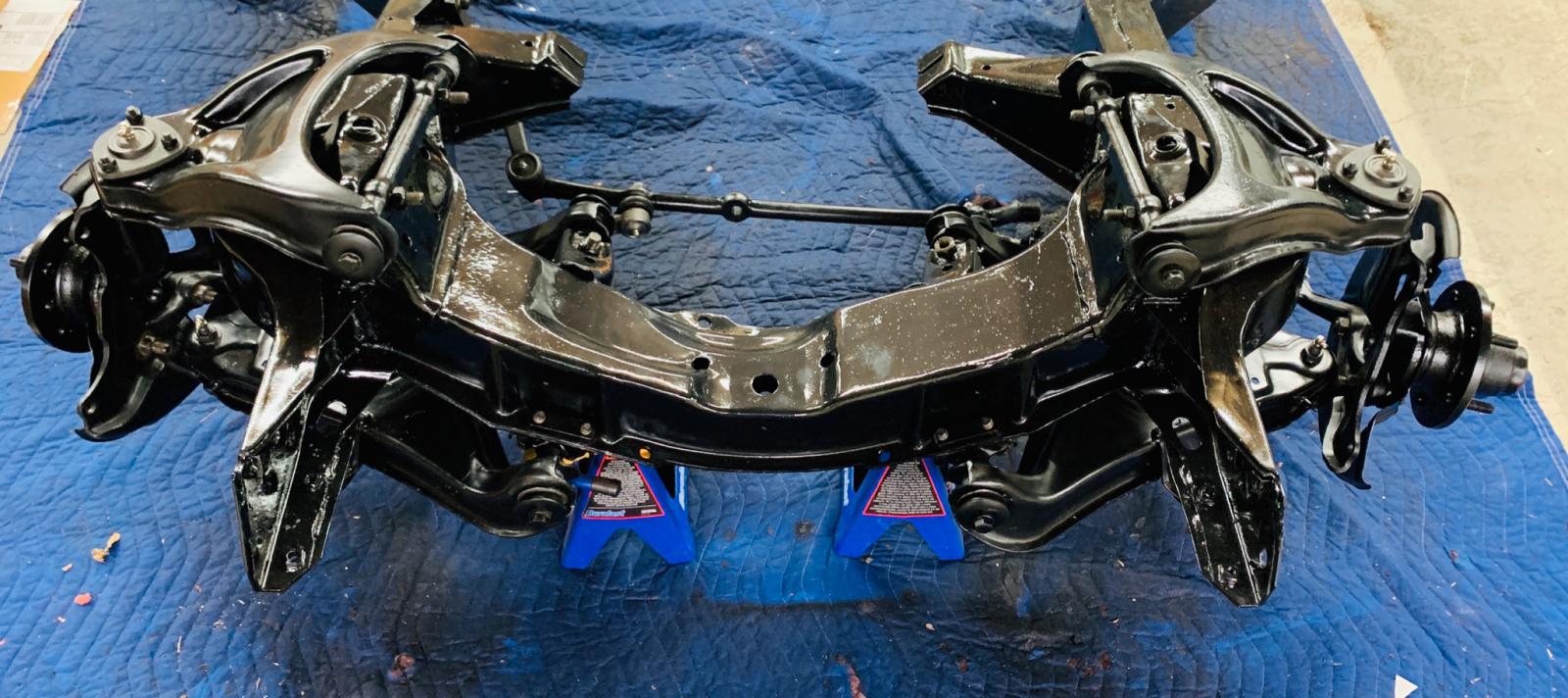

      Here’s the gloss black:
      With the frame fully coated, I’m ready to move on to rebuilding the front end and reinstalling everything. I have a complete front end rebuild kit on the way with new ball joints, tie rod ends, etc, as well as a kit of Viking coilovers for the front and smooth body shocks for the rear. The rear trailing arms are being rebuilt and the diff is being inspected. I hope to be making steady progress on this so I can get going on the body work ASAP.

      Looking good! I agree satin may have been the way to go, but that still looks good in gloss. I've always been a fan of POR15 over powder coat on anything that isn't a show car because its way easier to touch up if you actually drive it...and generally as durable when applied properly.
      Love the Jeep BTW!

      One trick that I use is paint everything with POR15 and while it's still drying spray it with flat black cheap rattle can paint. It bonds with the POR and gives a nice Satin black finish.
      Apr 2020
      101
      Quote Originally Posted by ryeguy2006a View Post
      I actually used POR Top Coat spray paint to finish, and it works pretty well, but it’s easy to get overspray on other areas which kind of clouds the gloss finish. Satin wouldn’t have even been noticeable.

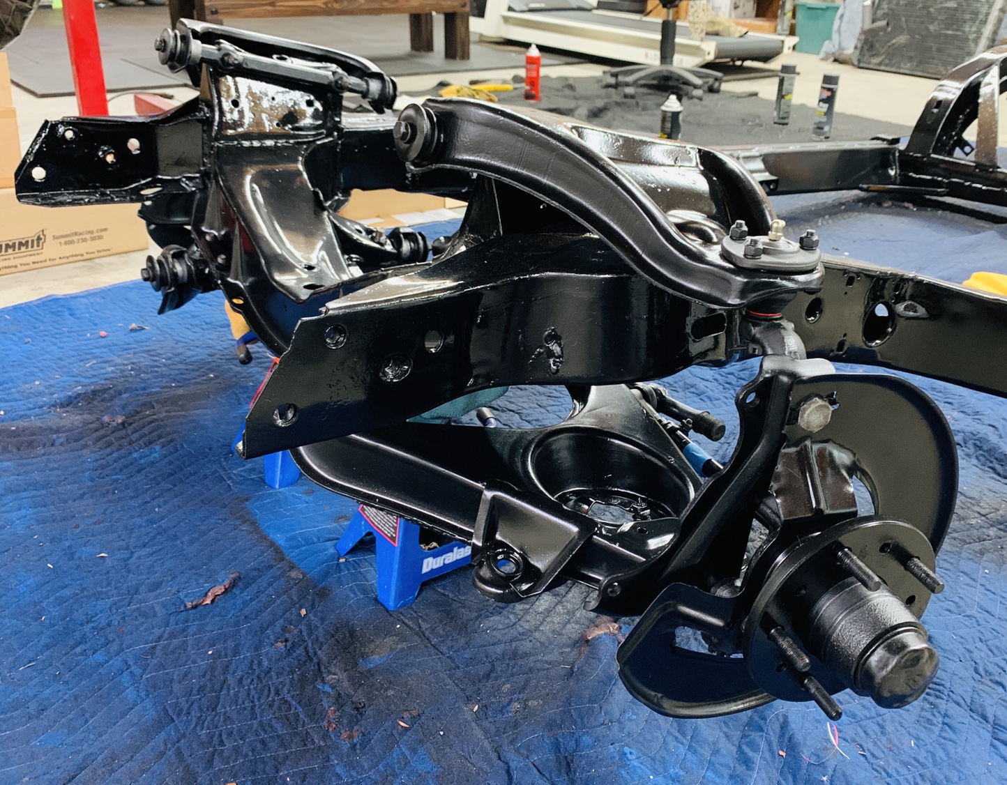

      Minor update...the front end is loosely back together. Just need the Viking coilovers installed to be ready to bolt things down. All new bushings, ball joints, and tie rod ends are in place. The rest of the suspension components were coated with POR-15.

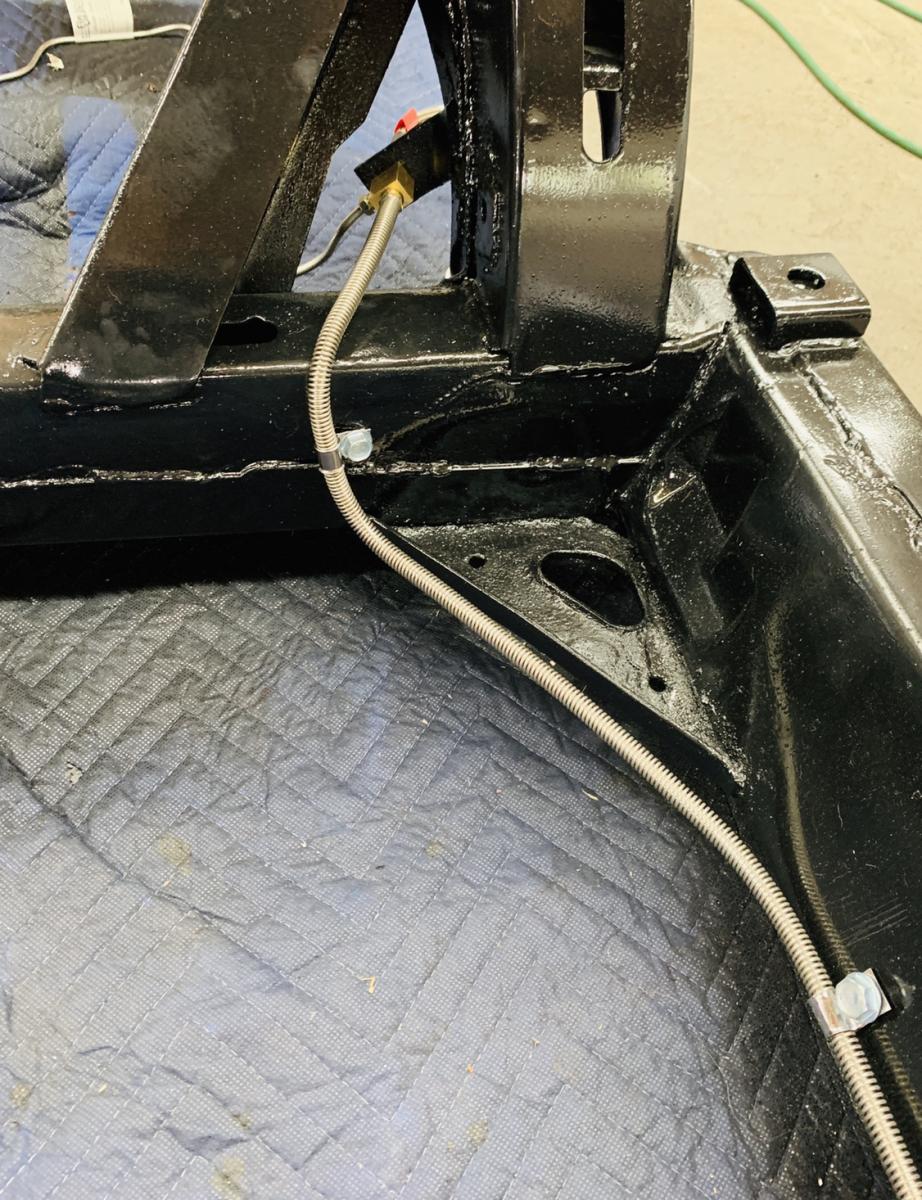

      New brake lines, brake rotors, and other various parts are inbound for the next round of work.
      Apr 2020
      101
      More progress. Sway bar is in with new end links and the brake lines are roughed in. Name:  IMG_2849.jpg
Size:  155.9 KBName:  Adjustments.jpg
Size:  528.7 KBName:  Adjustments.jpg
Size:  167.3 KBName:  Adjustments.jpg
