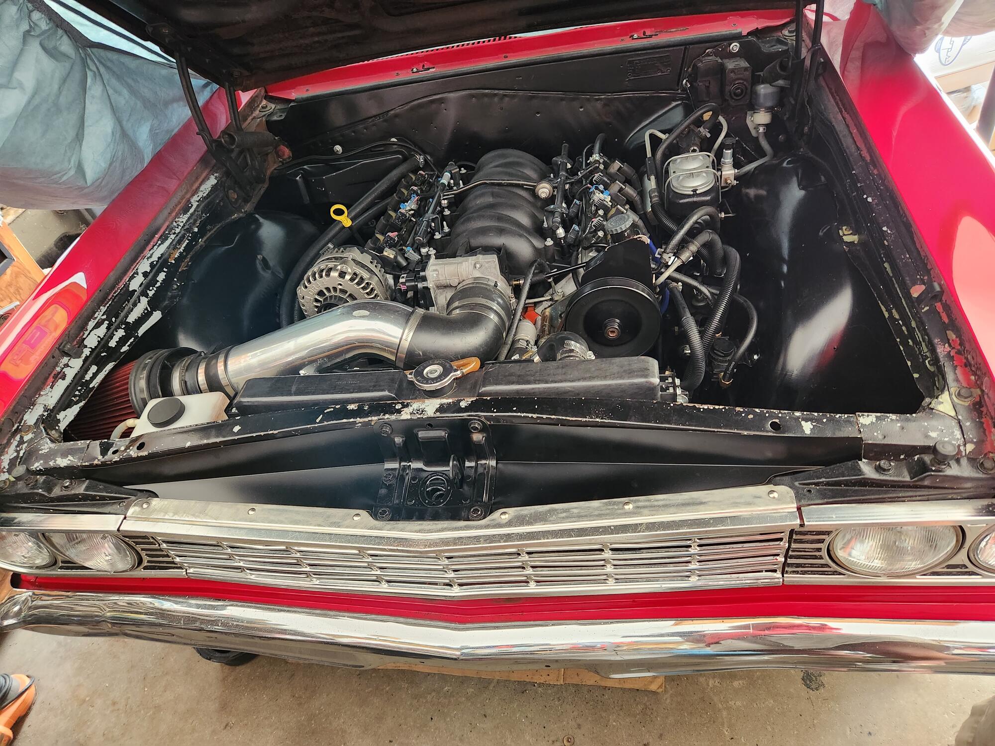

      Know it's an old post but checking to see if you've been happy with your setup? I'm in the market for a hydroboost hose kit and am checking posts. I've been running factory tahoe hoses but want to clean up engine bay now, have never enjoyed the Medusa's azz look .Name:  20230629_104440.jpg

      I made all of my own hoses and I'm very happy in the end. I installed the unit upside down so the fittings are facing downwards and of course, I made everything to exact lengths with just a bit of extra for movement and to avoid kinks.
      In the end, this is my full steering setup:
      Ididit Pro-Lite 1" 48 spline steering column
      Flaming River billet steering u-joint
      TurnOne SB2 Saginaw 600 series 10:1 steering box w/215 T-bar
      Lee Power Steering Saginaw "P" series pump (hydroboost setup: 1500PSI & 3.0GPM) kit w/external reservoir
      Lee 10-micron Power Steering filter
      Derale cooler w/fan (200F switch)
      All Earls -6AN Power Steering fittings and hoses for the high-pressure lines
