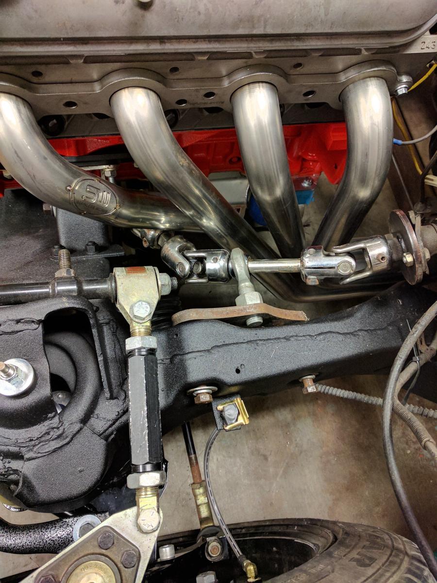

      my understanding is that the modified Stainless Works headers from Speedtech fit and allow you to use a single shaft for steering. We used the Stainless Works LS swap headers, Stock subframe, and unisteer rack (remarkably similar lay out to yours) and had to use the unisteer BBC steering linkage kit. There were a couple more tricks needed, but I don't think they will be necessary with the Speedtech subframe. Here are a couple of picsName:  IMG_20161205_223049_Original.jpg

      Wow that's tight on the steering shaft.
      Thanks for the photos. The Speedtech does have some slimmer areas on it.

      i thought i had a pic from under the car. the headers tuck really well and we have yet to smack them on anything. And, our car is really low.
      The frame is actually powder coated and has a texture; hides lots of flaws. ha
      the frame stands are factory BBC stands, Moroso solid mounts, and dirty dingo sliders. The BBC stands move the engine towards to passenger side and gave us clearance for the rack fittings
