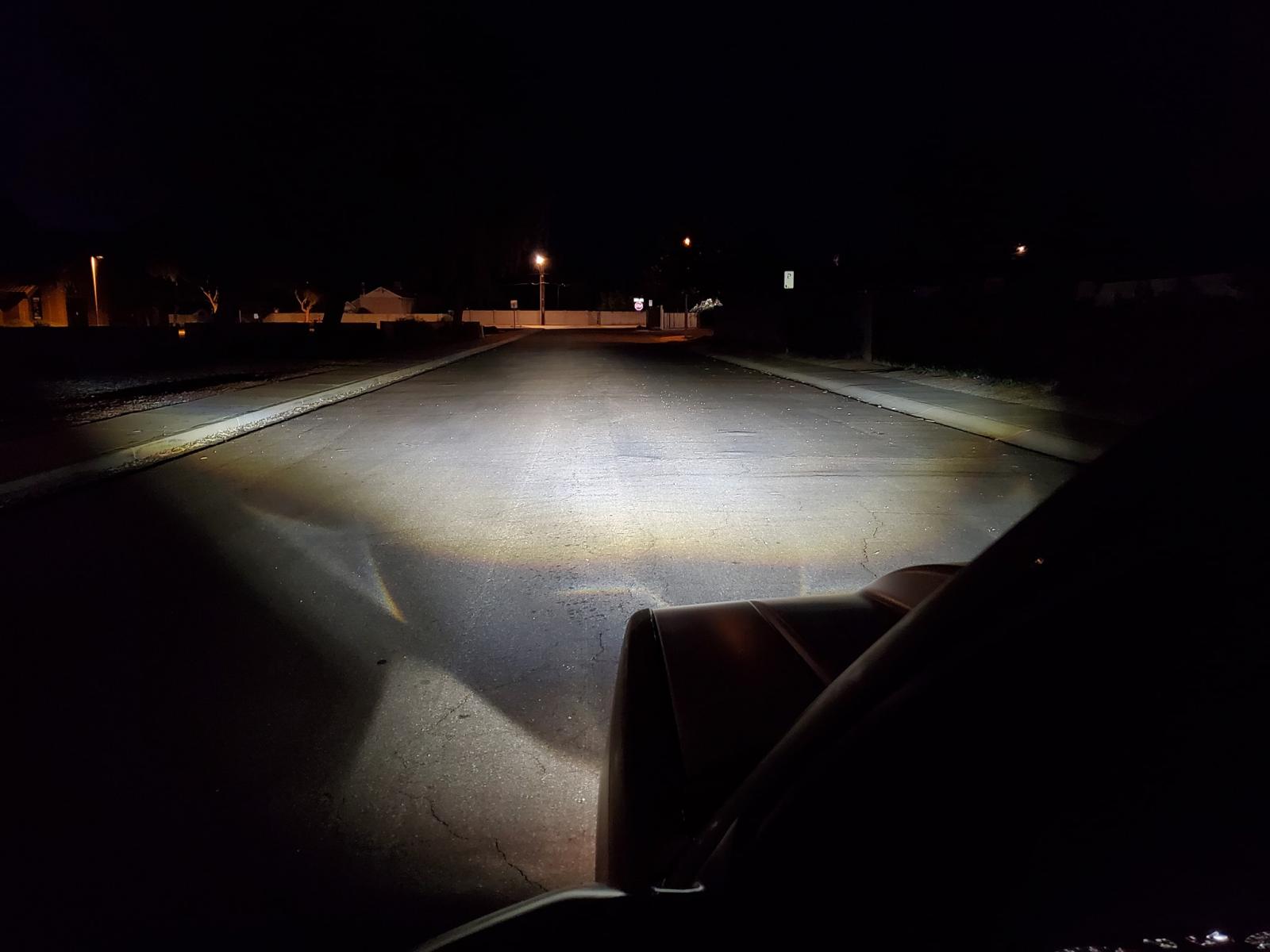

      For the money, there is nothing better than JW Speaker headlights. The cut off is sharp and amazing like a late model lexus, the output is extremely impressive, the only issue i have is for older cars, like your GTO, they look to 'futuristic' for my liking. But depending on the build, they can fit in, and the wow factor is impressive. Below is a picture of the LOW beams only. Literally the brightest and well-designed aftermarket headlight I’ve ever used. And I have used a lot.

      16,125
      Quote Originally Posted by BK2LIFE View Post
      Do you have the exact part number for the 5.75" set?
