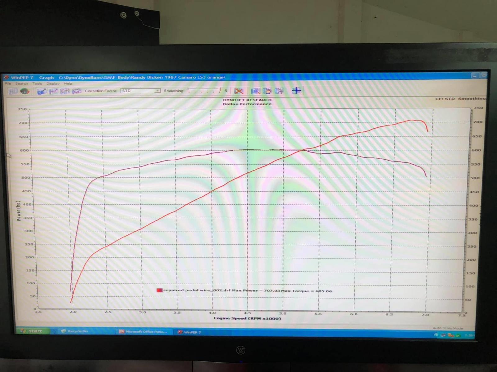

      TSP Stage 2 N/A LS3 229/244, .629/.615, 111 LSA Camshaft kit. Dual valve springs, pushrods, trunion upgrade. Runs real hard and 7000rpms if need be. I also kept everything the same and added a heartbeat supercharger on it putting 8-9psi

      Nice how much did it make with the super charger. ?

      474hp na
      707rwhp and 606tq supercharged
