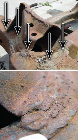

      Following the post above, I did some digging and found one example described here: https://www.chevydiy.com/how-to-rest...pension-guide/. This related to the control arm mounting area, and not the stitch welds along the top rails of the frame that go under the car.
      The upper control arm tower and shock mount get a lot of abuse and they don’t get a lot of attention. The shock plate can be cracked where it meets the frame rail and can go undetected because it’s covered by the control arm. Hairline fractures commonly start around factory welds at the base of the control arm tower.

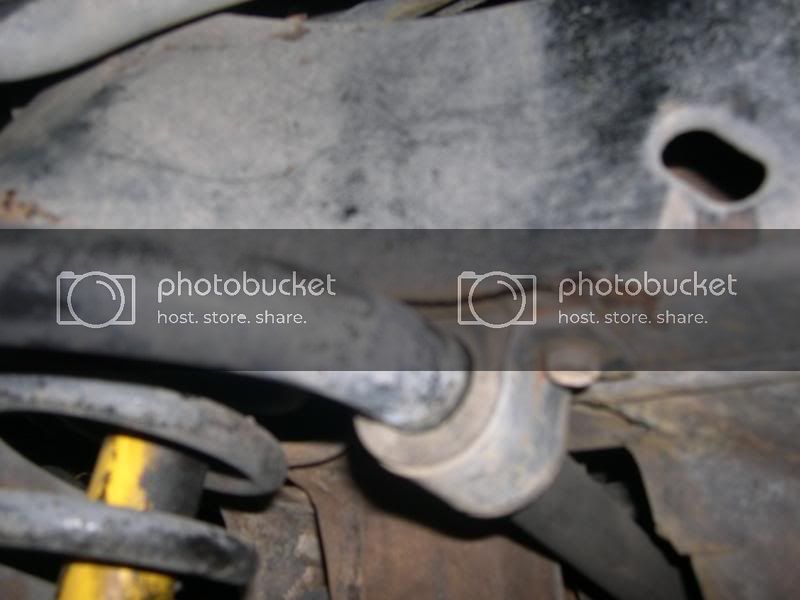

      Another area of concern, unrelated to welding, is where the sway bar mounts to the frame. There's an example of that described here: https://www.camaros.net/forums/16-br...-sway-bar.html
      I use this car for my daily driver and have driven it 115,000 miles with this 1 1/4 " sway bar on it. Also found the sway bar frame mount bolt loose, the nut had disappeared.
      This car is driven gently. So you guys autocrossing your car need to keep this in your check list when inspecting your car.
