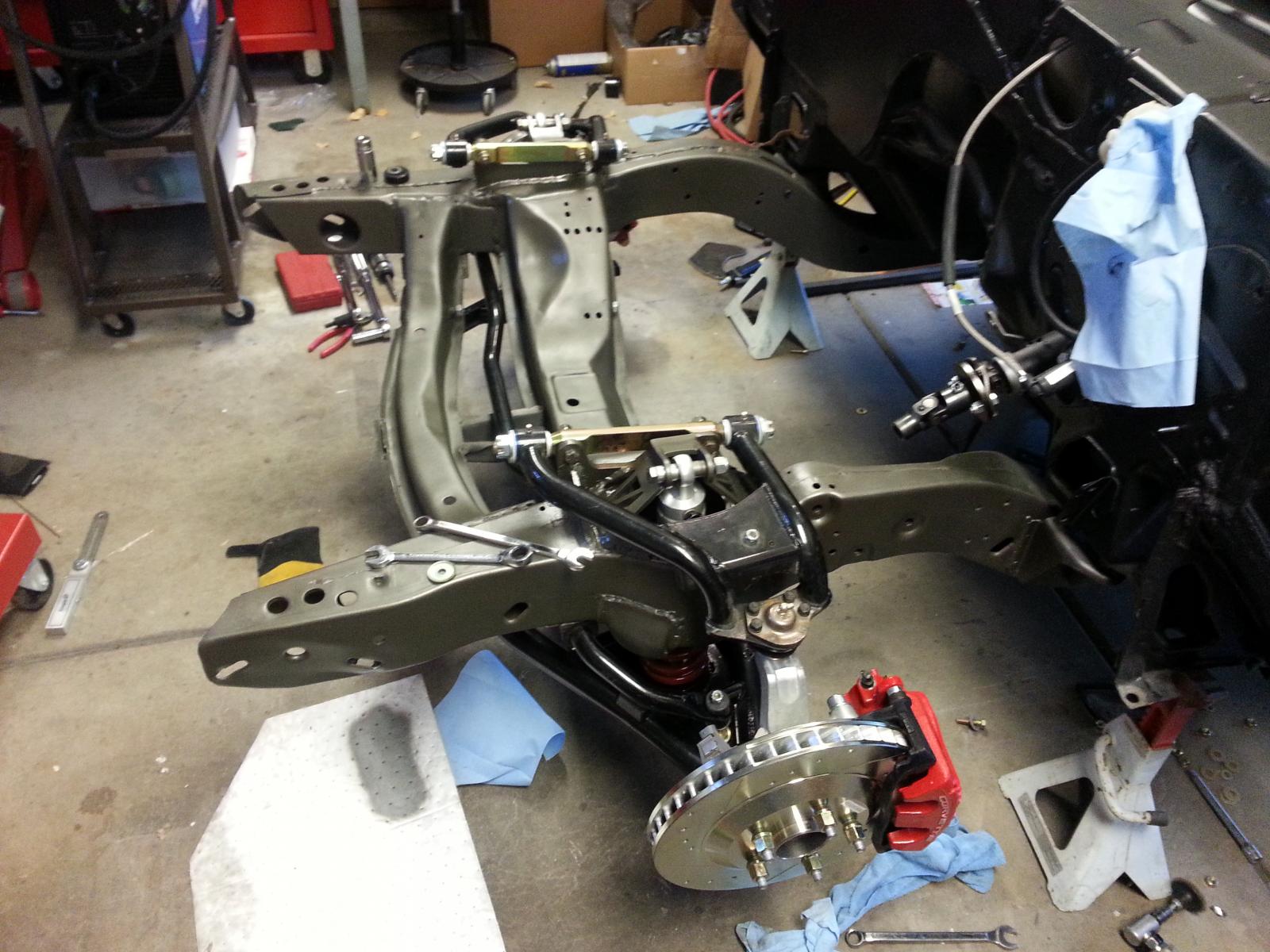

      I am definitely not the voice of reason when it comes to that choice. I have coilovers, but I let my Camaro turn into an avalanche which has kept it off the road for years. It's very close to being done. I will have it going as soon as my daughters Nova is done. TheBandit did his build a little at a time which kept his car on the road. F-Body is 100% correct in saying bang for the buck is the way to go.
      Matt H.
      Apr 2020
      12
      That looks like a really nice set up. I love how nice things look when they are clean and put together! I think that’s honestly one of the most satisfying things, seeing everything come together and function how you’d like. What are you running for coil overs? Also those of you that have a garage, I’m a bit envious. Working on your back in the driveway like a dog tends to get old at times.
      Apr 2007
      Clarksville, TN
      406
      Thanks. The setup in the picture is my old stuff that I just put into my daughters Nova. Global West upper and lower control arms, Speedtech Chicane coilover mount, Chris Alston Varishock coilovers, Eibach springs and Hotchkiss swaybar. The picture shows ATS tall AFX spindles and Corvette C5 brakes which are staying with my car. Her car already had new Wilwoods when we bought it and Belltech drop spindles which don't fit well. Tomorrow I am going to show her how to put stock spindles on.
