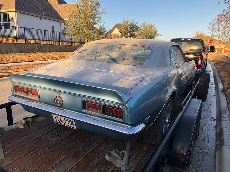

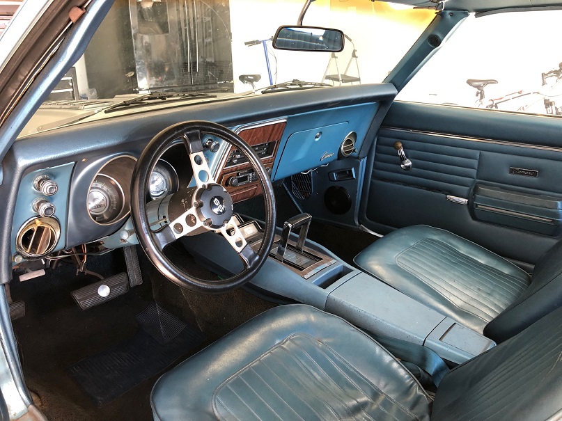

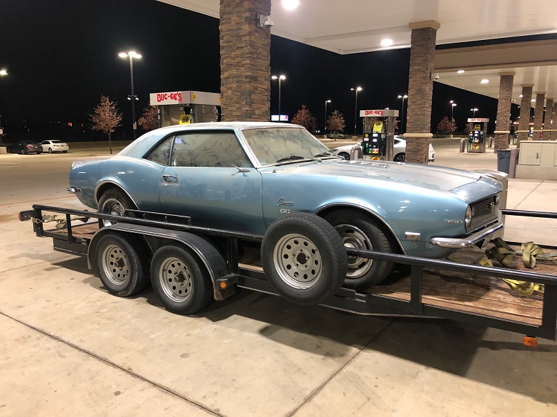

      I've been lurking around here since I got this car about a year and a half ago. Since I've got nothing but spare time right now I figure I might as well do this. When I got the car I was looking for something in pretty good shape, that wouldn't need too much work that I would keep mostly original. I found this one and bought it the night I went to look at it. Lesson learned...don't buy a car without looking at it in the daylight. As you already guessed, it had rust. The truth is that I knew better. I had been looking for one for weeks and got impatient. Making the repairs isn't a big deal, it just adds time that I wasn't counting on. This has been a pretty slow moving project and I haven't taken as many pictures as I should, so it won't take too long to get you all caught up. Here it is as I brought it home.

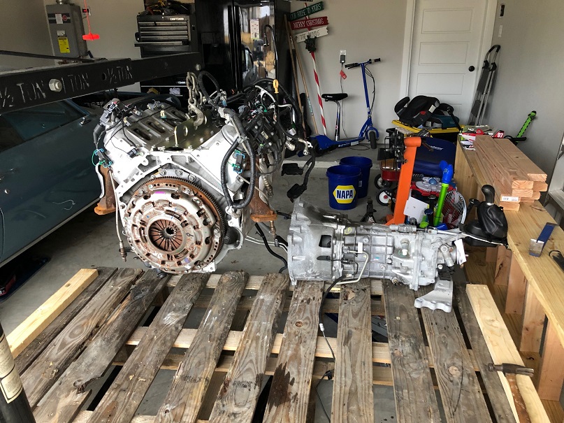

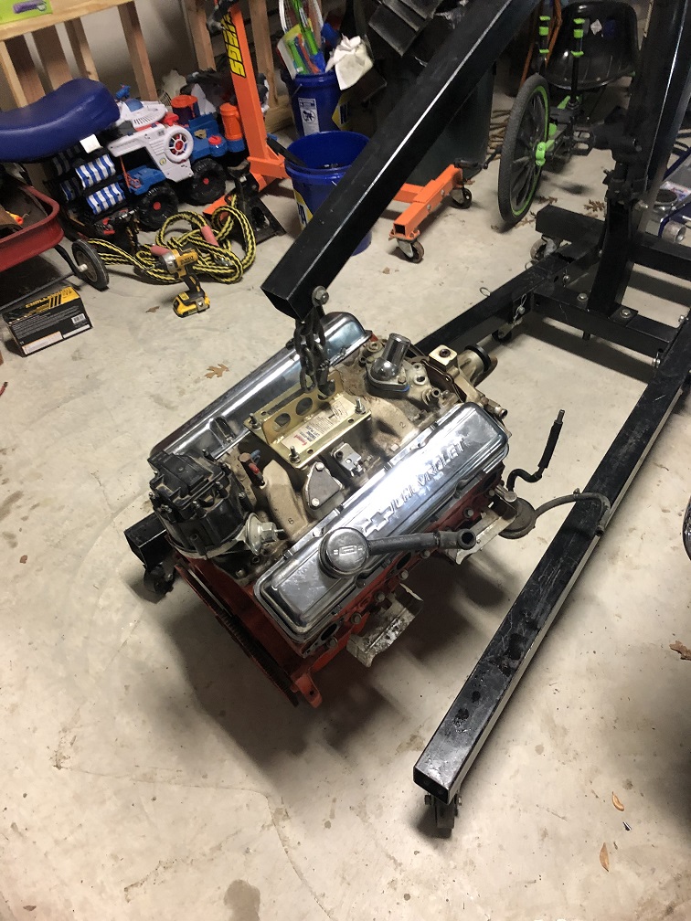

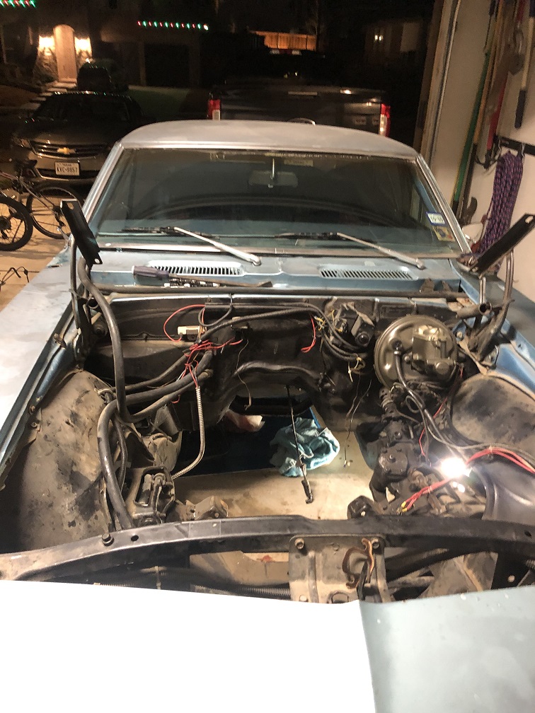

      Well it didn't take long at all for me to decide that the 400 small block that came in the car wouldn't cut it. So I found a great deal on an LS3 and TR6060 out of a 2015 Camaro with only 15k miles on it. I guess I didn't take any pictures before I took everything apart. I couldn't believe how much stuff they sent. It seemed like I got half of the car. At this point the plan was still to rebuild the front brakes, add discs in the rear, new bushings and ball joints, etc. Just get it street worthy.

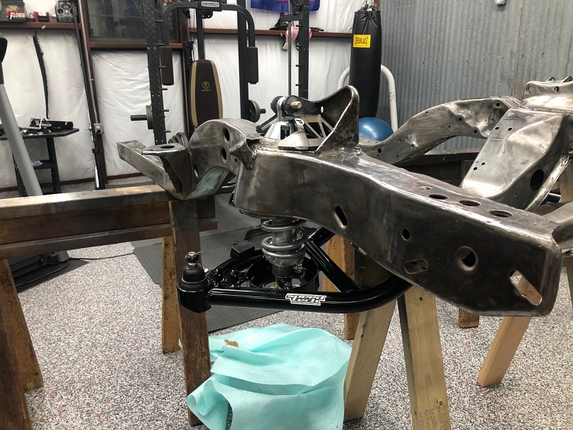

      33

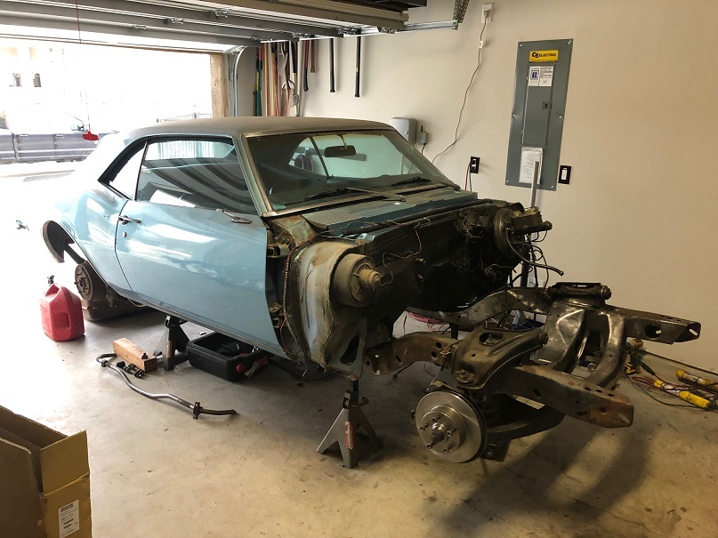

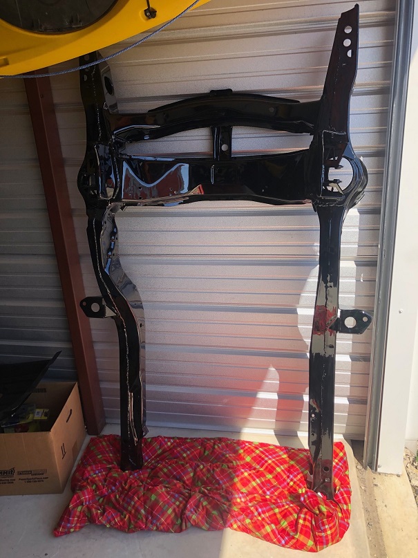

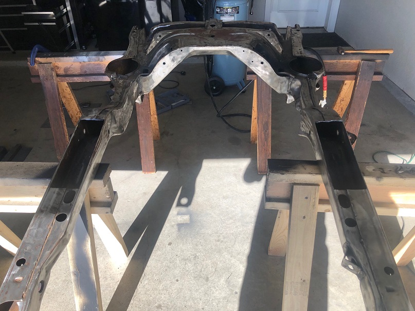

      While I was cleaning everything up I realized that the subframe was a little more banged up than I realized. Then when went to install the Global West solid body mounts I saw that it was in pretty bad shape. So out came the subframe. Somewhere about this time I decided that I needed to learn how to weld, so I bought a Hobart 210 MVP and started learning how to use it. Go easy on me, I'm still learning! I made those repairs and welded up all of the seams while was at it.

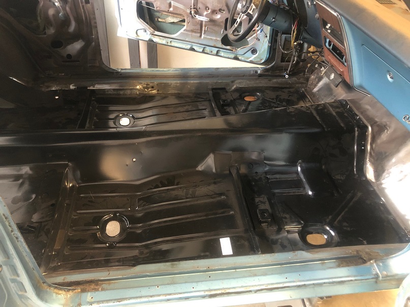

      33

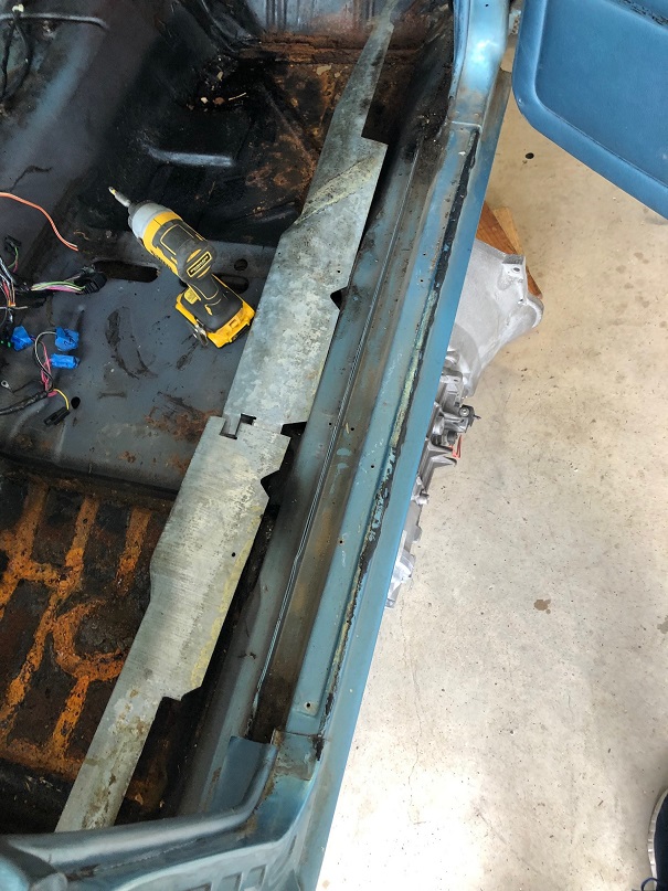

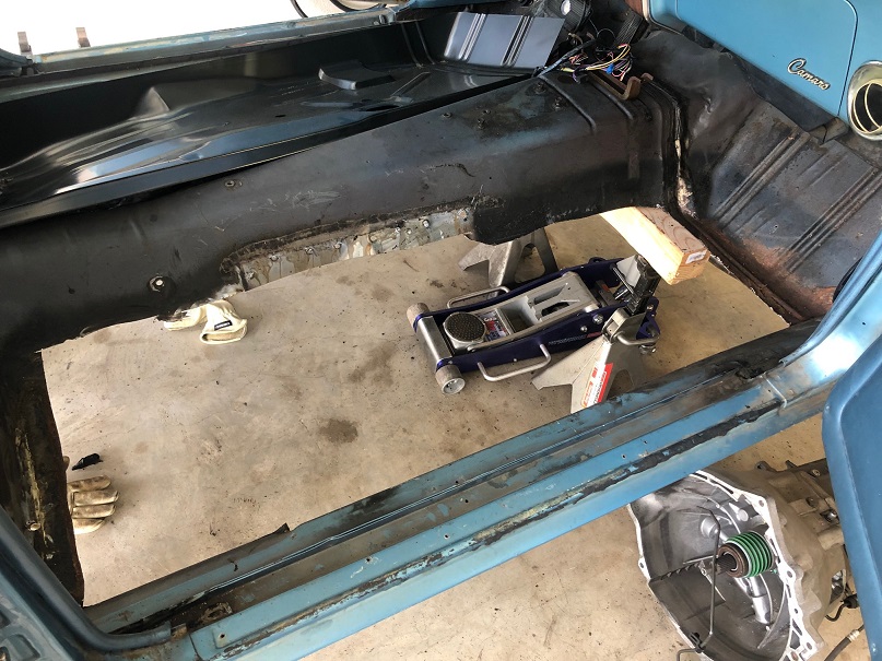

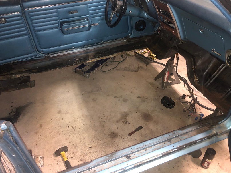

      The floor needed some work. When I started I was just going to do 2 or 3 patches. Then I decided to do the whole passenger side. After messing around with it for a while I figured out that the butt welds were going to be a whip, and I probably wouldn't be satisfied with how they looked when done anyway. So I went ahead and cut the whole thing out and put in a 1 piece pan.Name:  IMG_4138.jpg

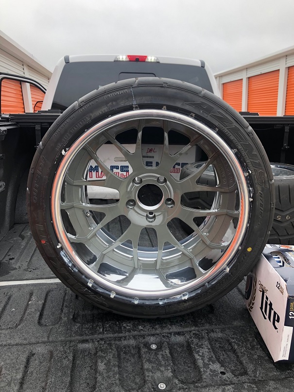

      33
      Tired of typing for tonight but here's one last pic. I'm very happy with how the wheels turned out. I went with US Mags because I have a longstanding relationship with the manufacturer. Forged, multi-piece, and powder coated the color of my choice, Storm Grey.

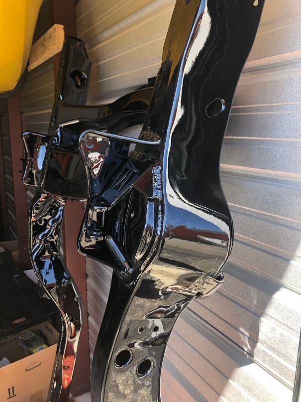

      I'm sure some of this is not in the order that it was actually done. I really wish I'd done a better job of taking pictures and keeping better notes. Oh well.

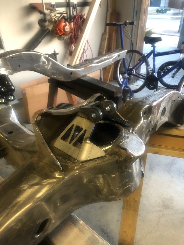

      After making the repairs to the subframe I wanted to get it to powdercoat. One thing left to do before that could happen..the Chicane brackets. I did the cutting and prep work but I really wanted them TIG welded so I got my buddy Justin to help with that. He is very good at what he does and I will be relying on his help quite a bit as the project progresses.
Size:  11.0 KBName:  IMG_5194 (1).jpg
Size:  150.1 KBName:  IMG_5189.jpg
Size:  194.3 KBName:  IMG_5191.jpg
Size:  175.3 KBName:  IMG_5249.jpg
Size:  227.9 KBName:  IMG_5250.jpg
Size:  238.5 KBName:  IMG_5253.jpg
Size:  189.0 KBName:  IMG_5321.jpg
Size:  223.8 KBName:  IMG_5322.jpg
Size:  220.7 KBAttachment 174306Attachment 174307

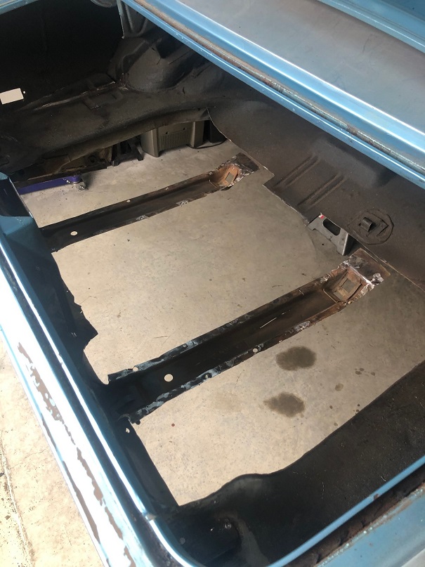

      33

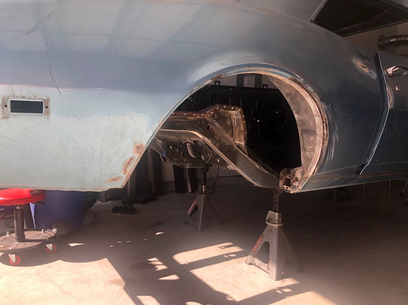

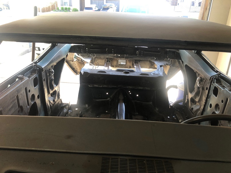

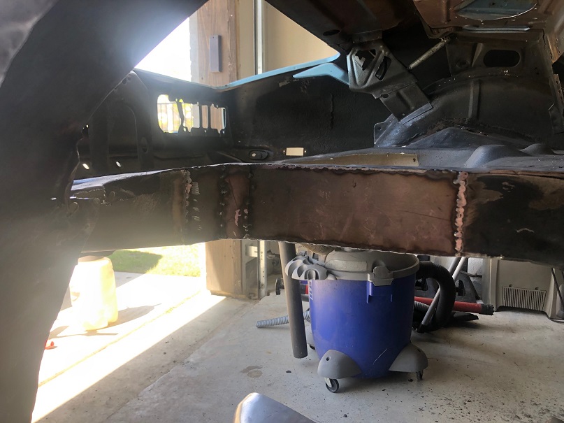

      Next I decided to start on the trunk pan as it was pretty rusty, caused by a bad leak from rust damage around the rear window. After I cut the pan out I decided to pause on that and get started on the mini tubs. Doing that so that I can get the wheels under it so that we can measure for the rear end. Justin will be building it. I had a difficult time getting the correct bend on the closeout for the frame rails so I ended up cutting it into 3 sections. Once I finish welding everything I'll grind it down so it looks good before undercoat or whatever I decide to use.

      And this is where I'm at right now. Over the next few days I will hopefully get the tubs and trunk finished. Justin will be starting on the rear end soon.

      I forgot to mention earlier that shortly after I got the new motor we went ahead and put a Texas Speed stage 3 cam in it. Along with their valve springs, pushrods, trunion kit, and Melling oil pump.
