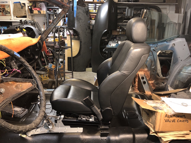

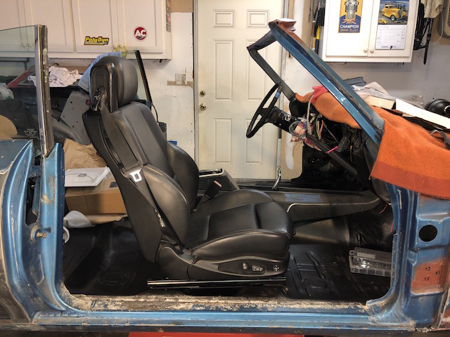

      They got one mounted in my car yesterday, here are a couple of pics. For some reason the second pic is posting sideways and it won't let me rotate it, not sure why.

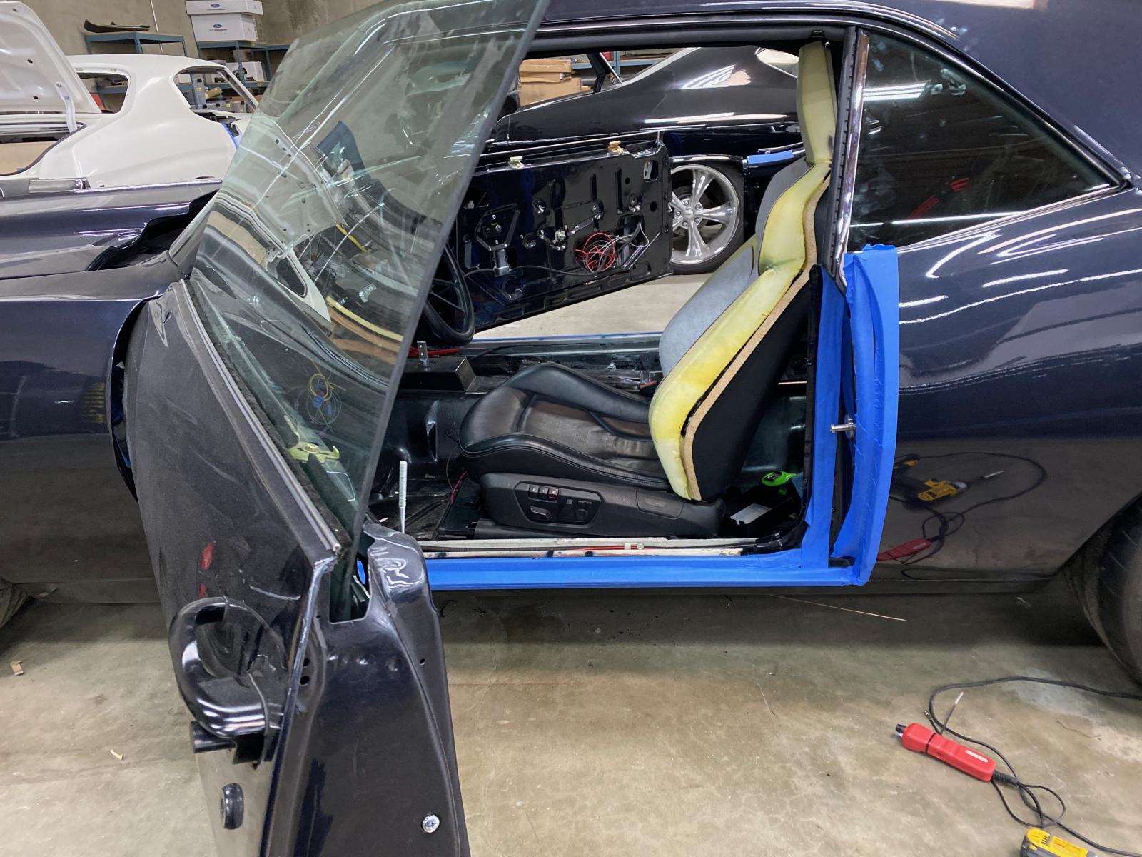

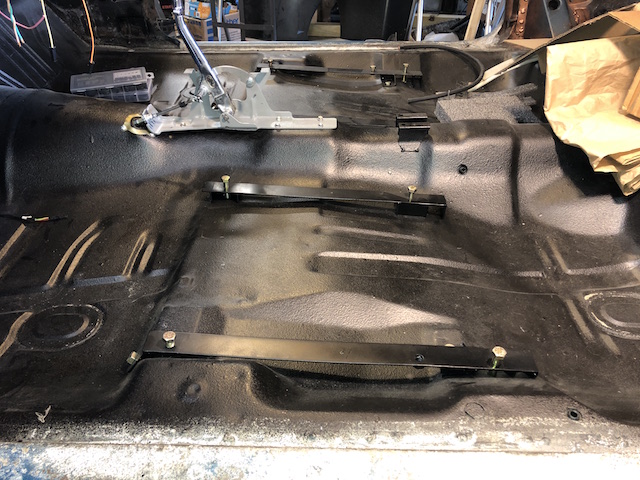

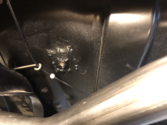

      I have sorta progressed lol. There is an area on the tunnel that stuck out, like a factory indention that sticks into the side of the seats, that I cut and layed flat so it gave me more room. Where the BMW seats have bolt holes, the inner rear one was right over an indention in the seat plate, so I bought a 1/8th thick plate I am going to weld nuts for the seats on and then weld to the factory seat plate. I think it will work, I just have not gotten anymore done. We did hang the car on the rotisserie today and I have been smoothing the subframe welds.
      I may end up using the material off the BMW back seat to cover the camaro seat. I have a local upolstery guy working on another set of seats and he acted interested in helping get the back seats done.
      I had a seat in the garage and gave a quick measurement. The BMW seat frame is about 17.5 inches in the front and the rear is 18. The widest area of the bottom cushion looks about 18.5 inches. There was not much difference compared to the stock camaro seats. They are taller with the head rest compared to the 68 with no headrests. I may ask the upolstery guy if we can cut the head rests down a bit.
