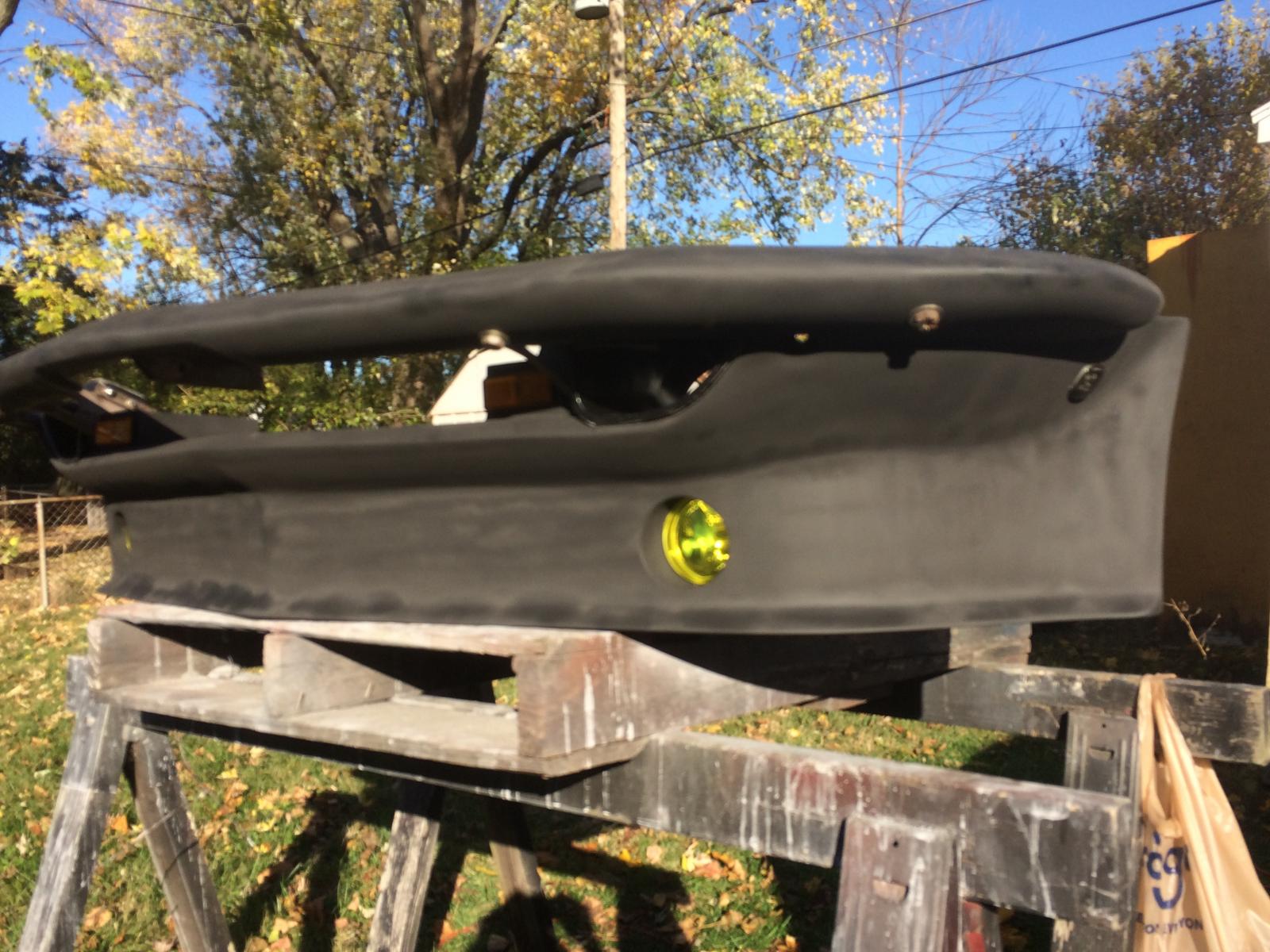

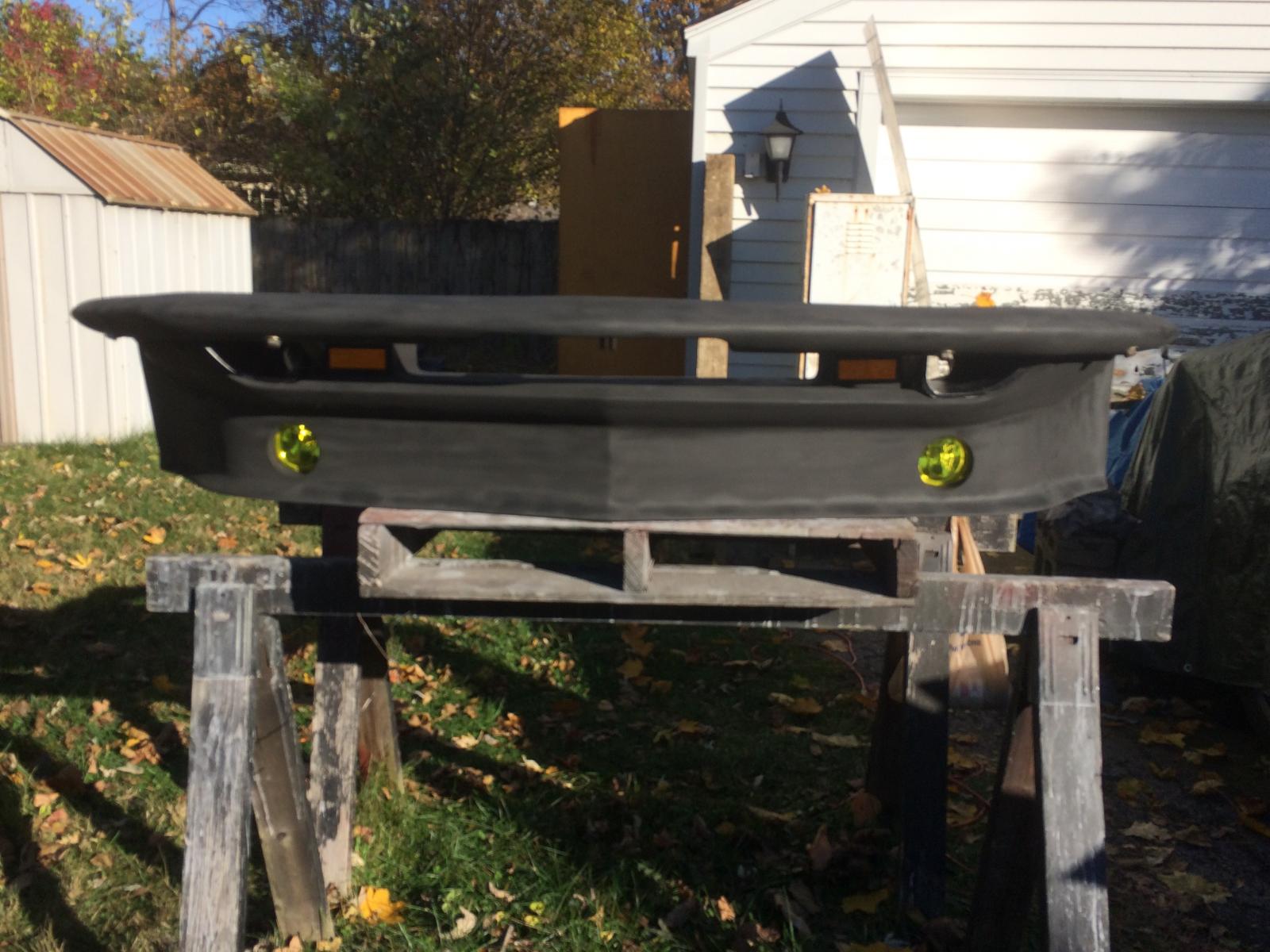

      Wet sanded with 320 grit & re-primed with some black spray bomb primer. Will probably wet sand most of it off. Test fit the lights & brake ducts. Side markers are smoked LED Audi A4 pieces.

      You might consider using the 2 part spay cans of primer to save you some work. I know they're pricey but if you line up several items and shoot at one time, it's easier on you in the long run. I think that front is going to look real good.
    6. #26
      Nov 2007
      Dayton, Ohio
      443
      Thanks wfo_guy.
      The primer was some spray bomb I didn't like and figured since I'm going to sand most of it off anyhow I used it up. Since the spray bomb primer is not quick drying and I knew I wouldn't be able to get to wet sanding again for a while either thus giving it plenty of time to cure. I do have quarts of primer to use in one of the spray guns I have but wanted to use this stuff up anyhow. Hopefully, this filled most of the coarse sanding scratches. You can tell I hit it more heavily in some areas. I will definately be breaking out the spray gun for the next round of primer.

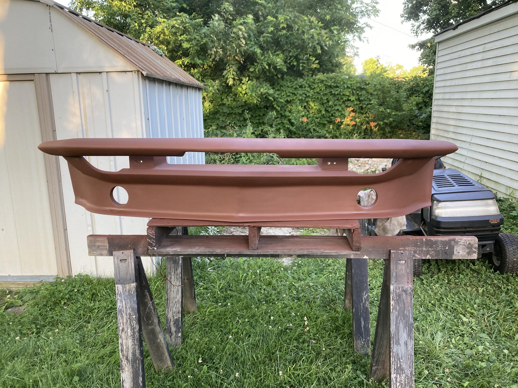

      Well, finally back to wet sanding again then primed.

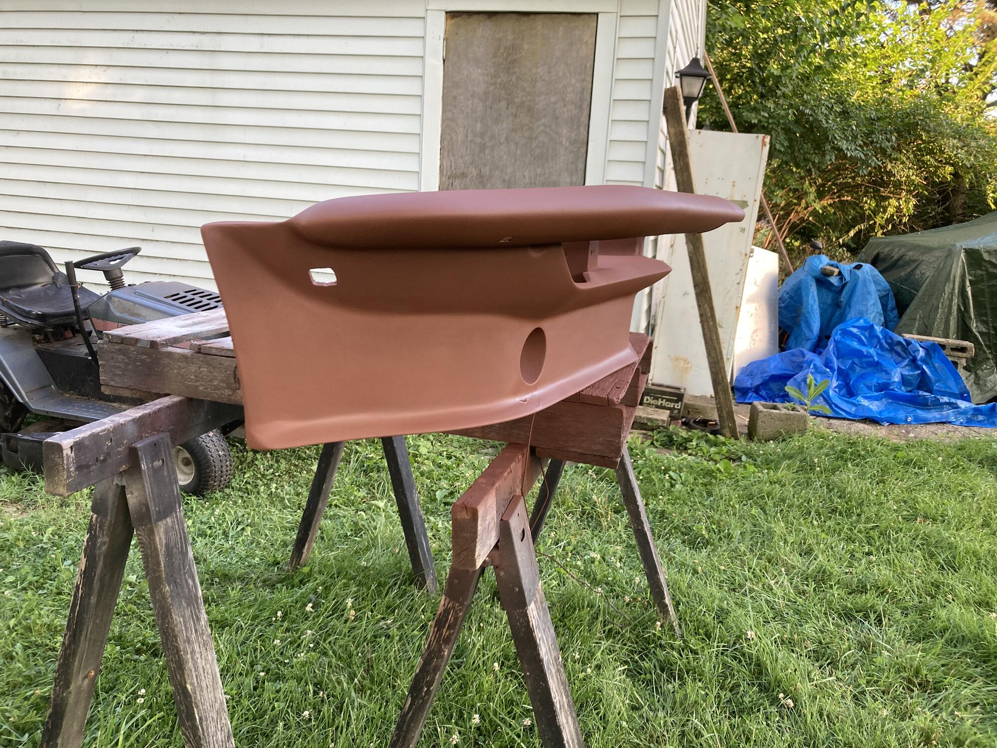

      Fabbed new accel pedal, wasn't an easy way to clean & rebuild original without cutting it up.
      Also working on a pod for a clock for the right dash panel. Decided to make it symmetrical to better match LH gauge panel.

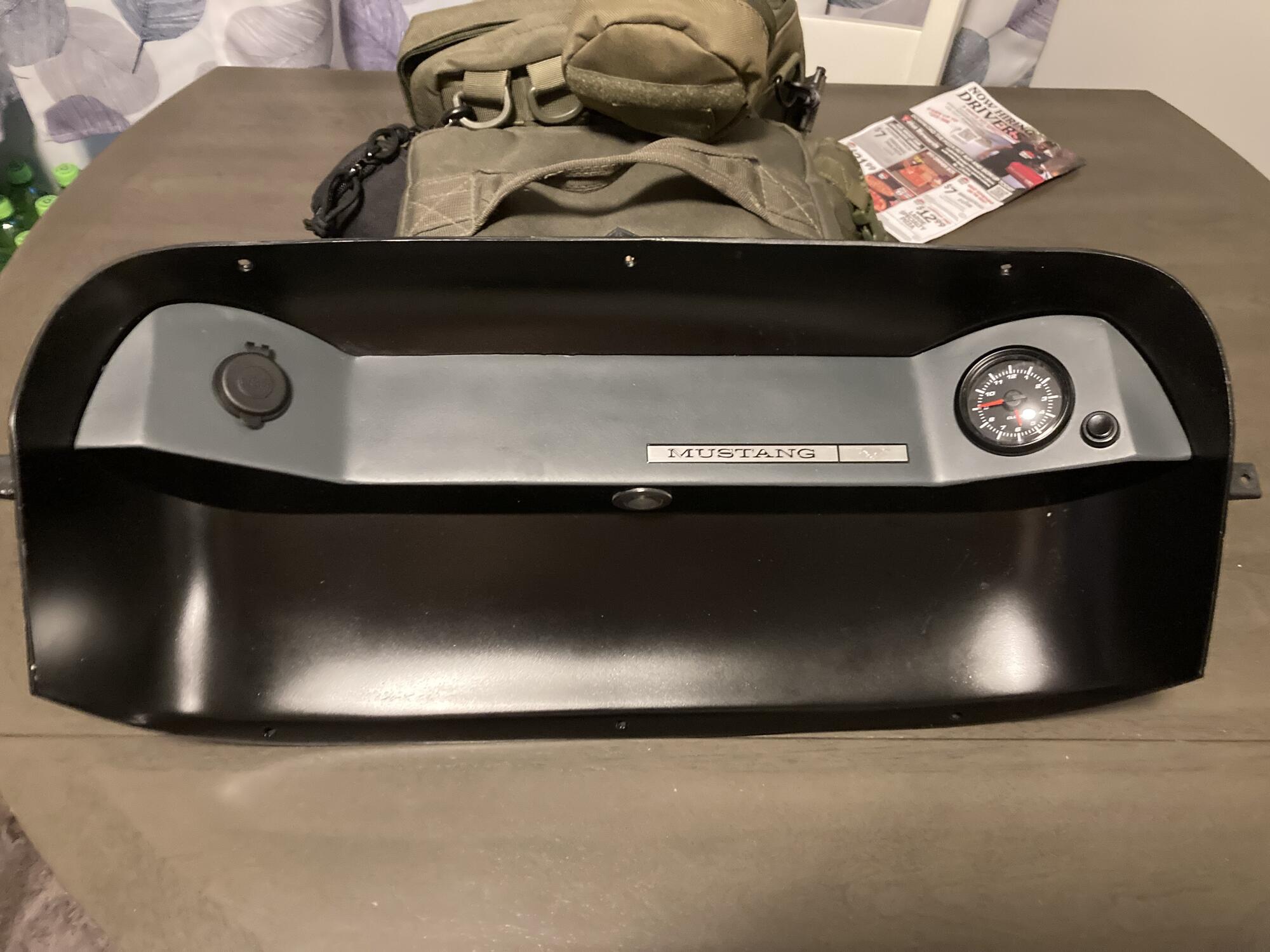

      Some updates
      Finished the RH dash panel

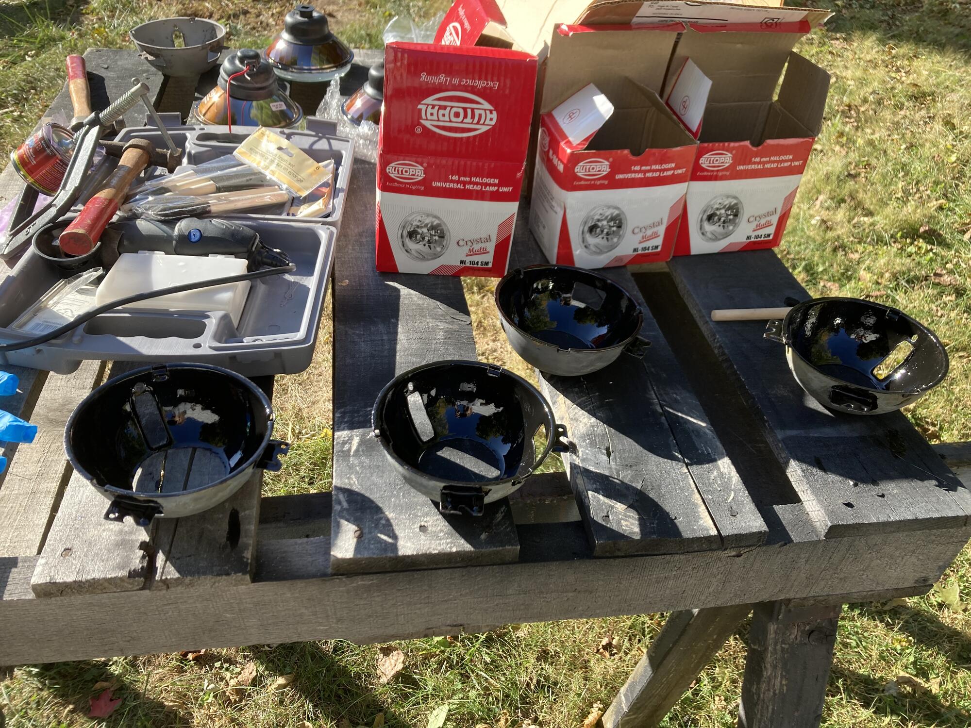

      Had the headlight bowls bead blasted. Trimmed and refinished for new headlights. I need to take pictures of the finished bowls.

      Interesting take on the RH dash panel. What does the button do?
      chunger
      '68 Ranchero 500
      '70 Cougar XR-7 Convertible
      '98 Mustang GT Convertible
    15. #35
      Nov 2017
      129
      looks great per usual
    16. #36
      Nov 2007
      Dayton, Ohio
      443
      The button is to adjust the clock. My understanding is the button completes the ground bypassing the internal circuit that keeps time and advances the hands?? We'll see.

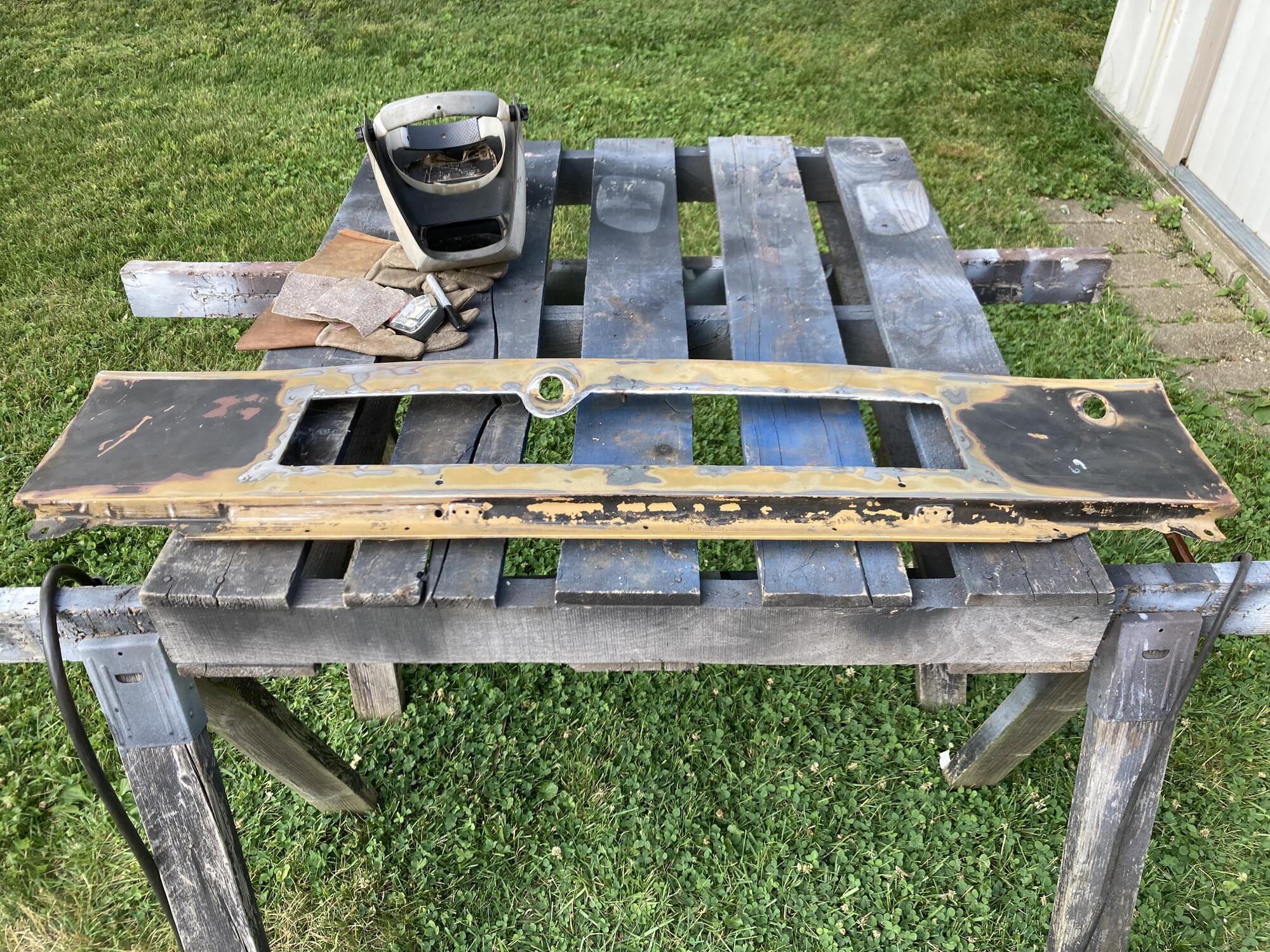

      Updating

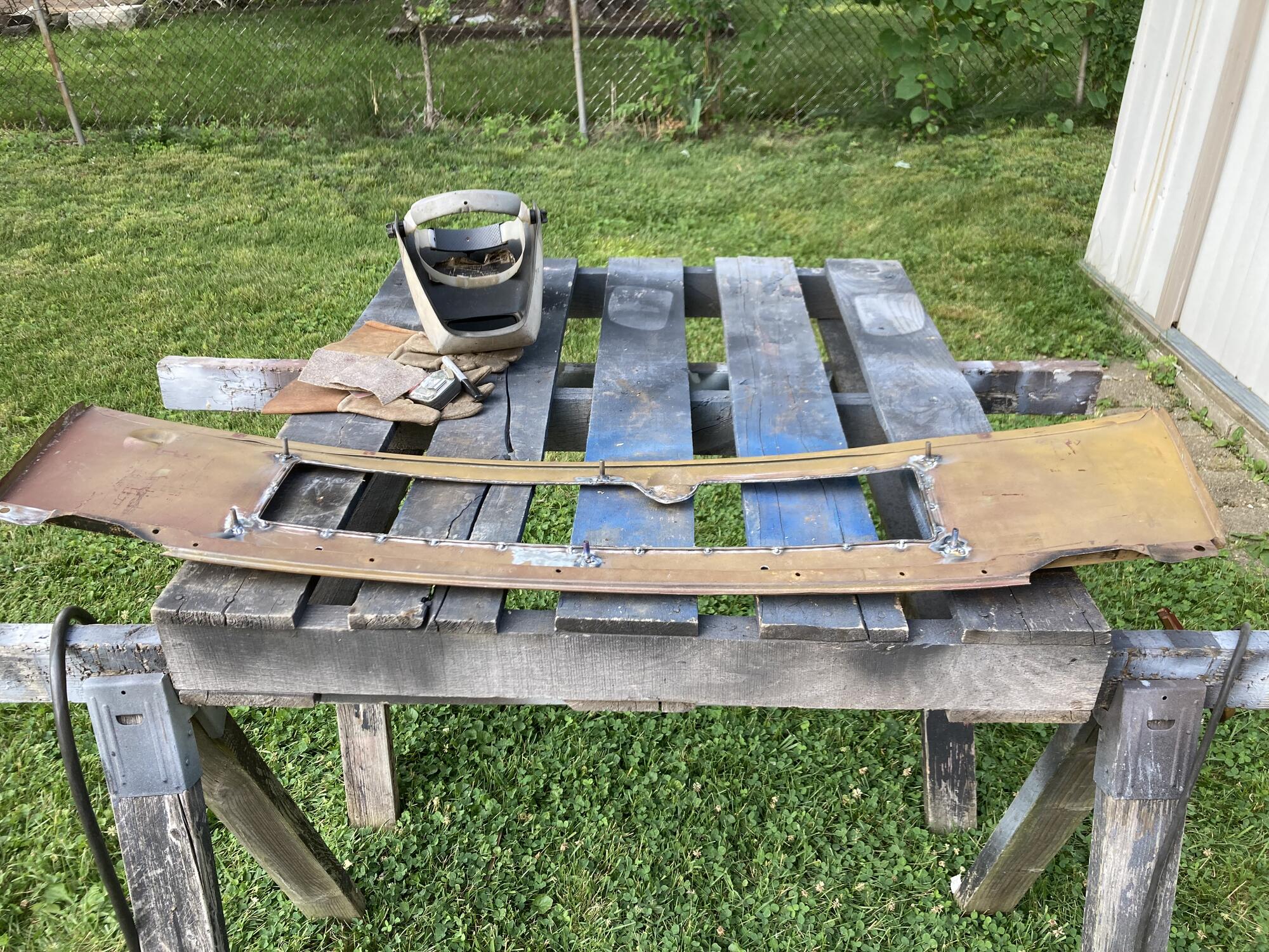

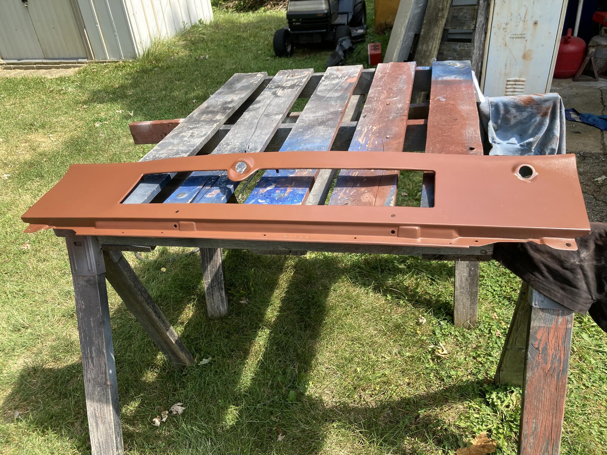

      Modified my cowl panel. Cut away the grill bars, welded 1/8 rod around the perimeter of the opening, tack welded 1/4-20 studs to the bottom side, stripped, skim coated, primed, sanded, primed. It'll get SS or aluminum screening.

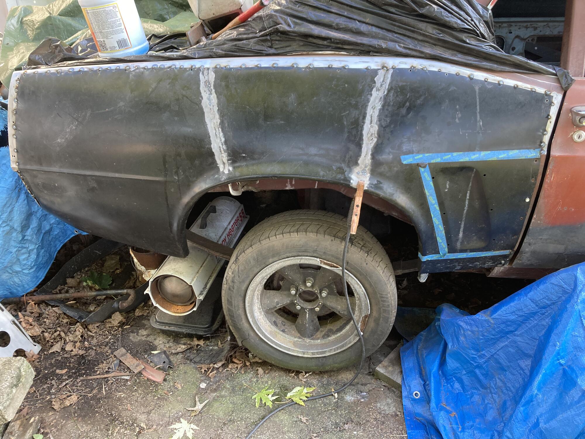

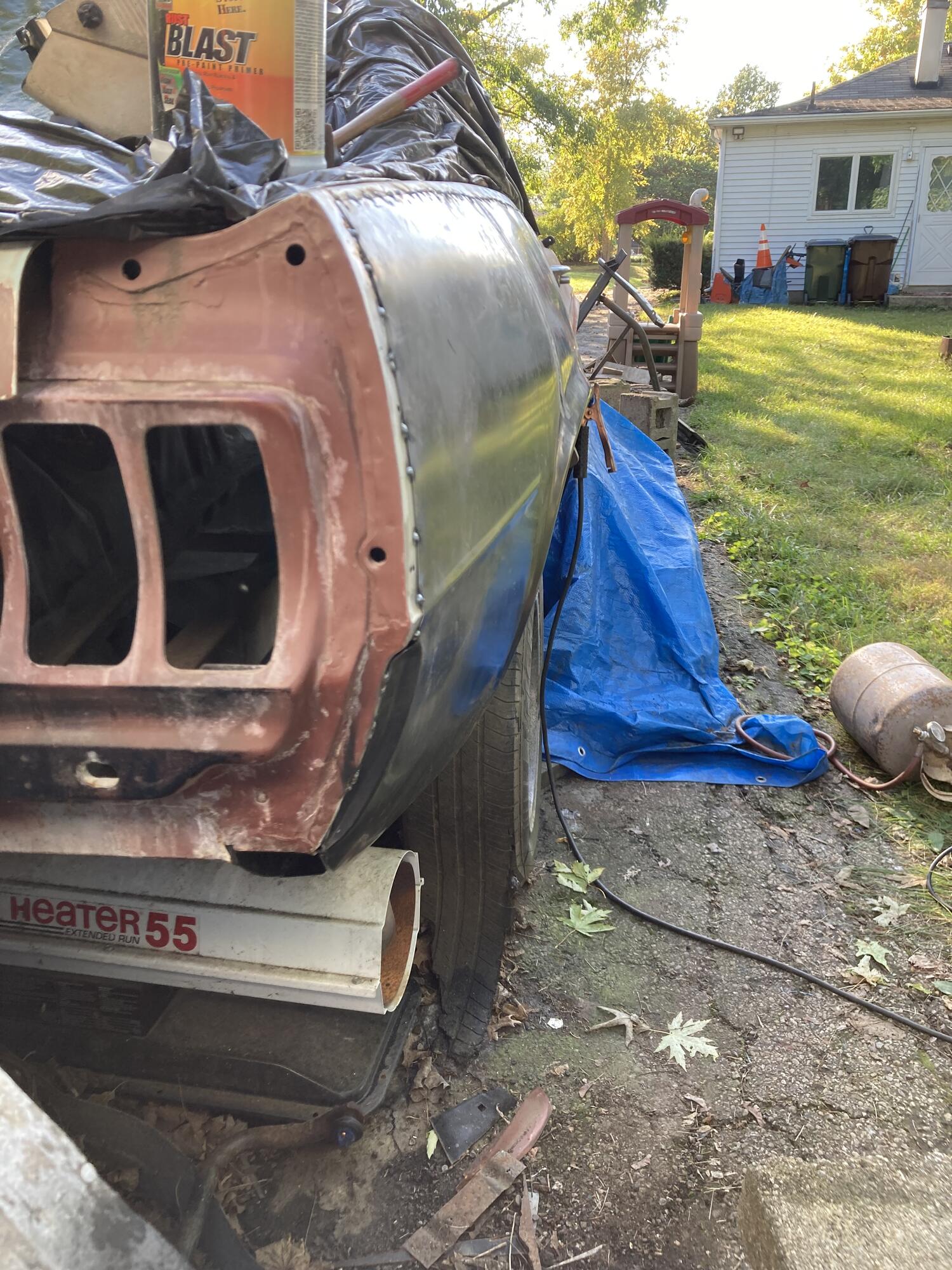

      Tacked rh quarter in place. Bumped out 2"

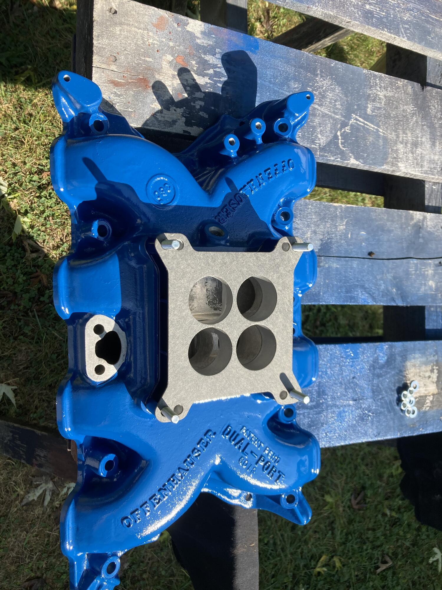

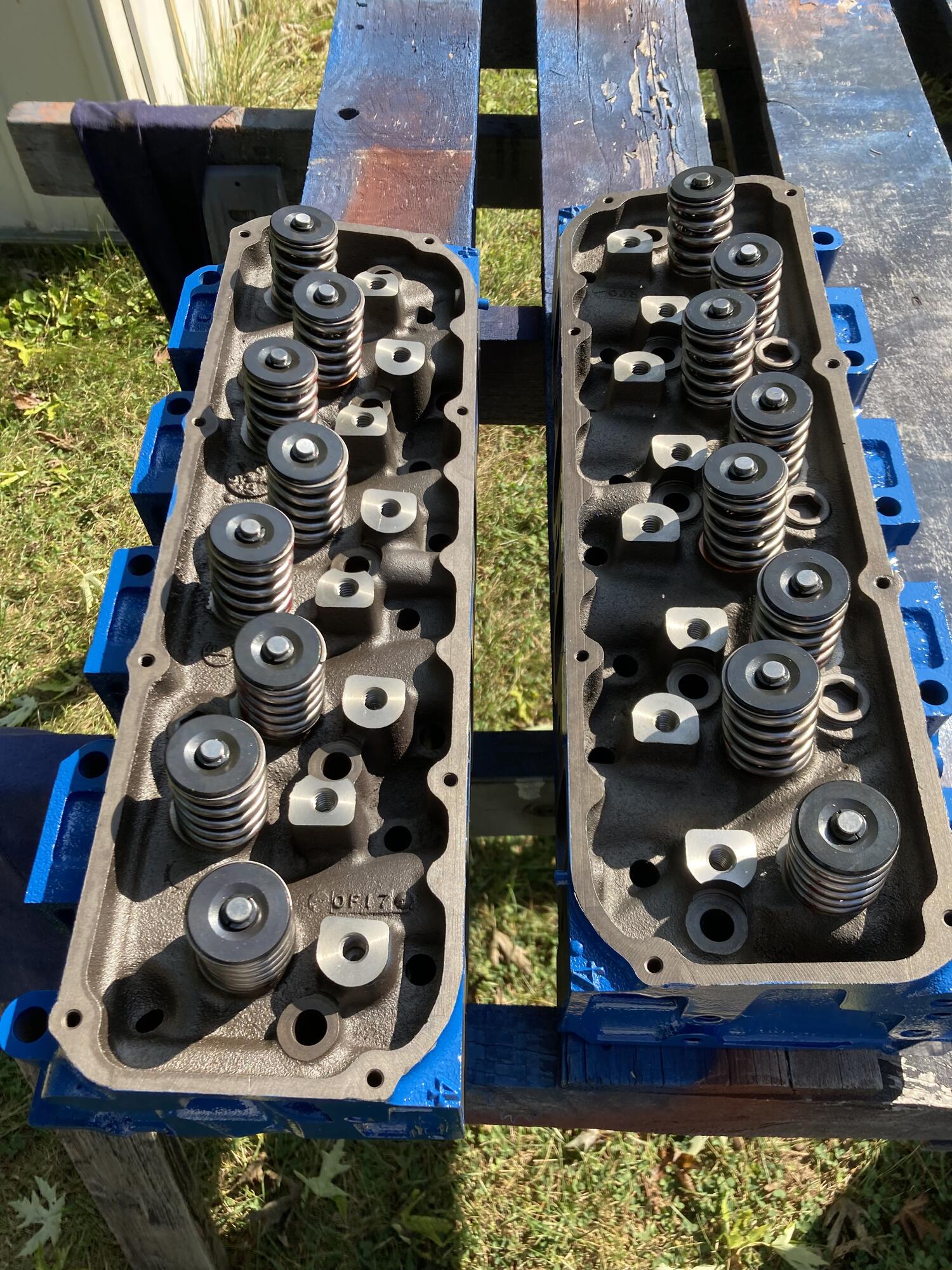

      Pulled the heads and had them reworked with new valves, springs, seats & seals. Had them set up for roller rockers. Also picked up an Offenhauser dual plane intake, had some recommended machining done then cleaned. I painted the heads & intake with Eastwoods ceramic engine paint.

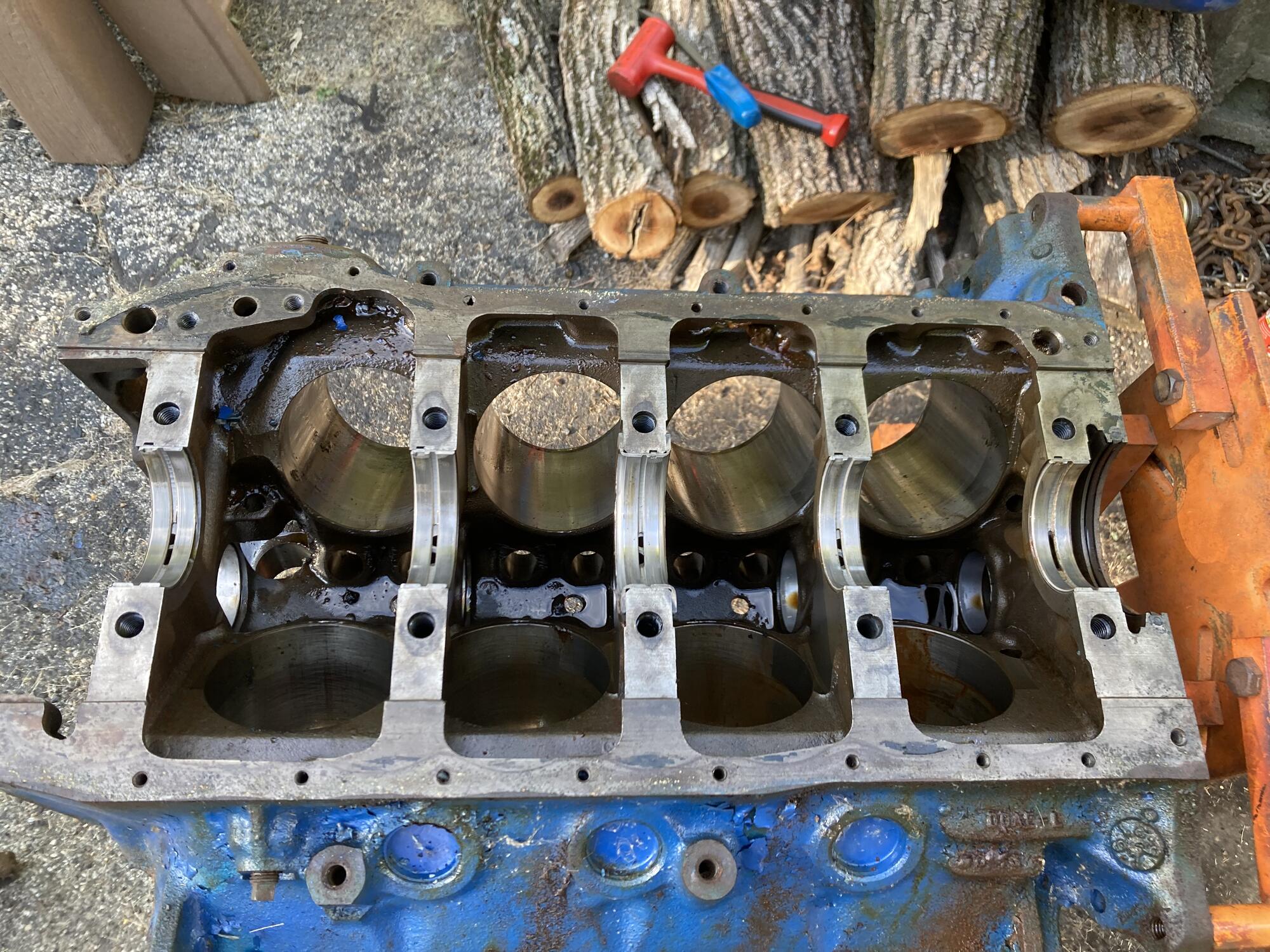

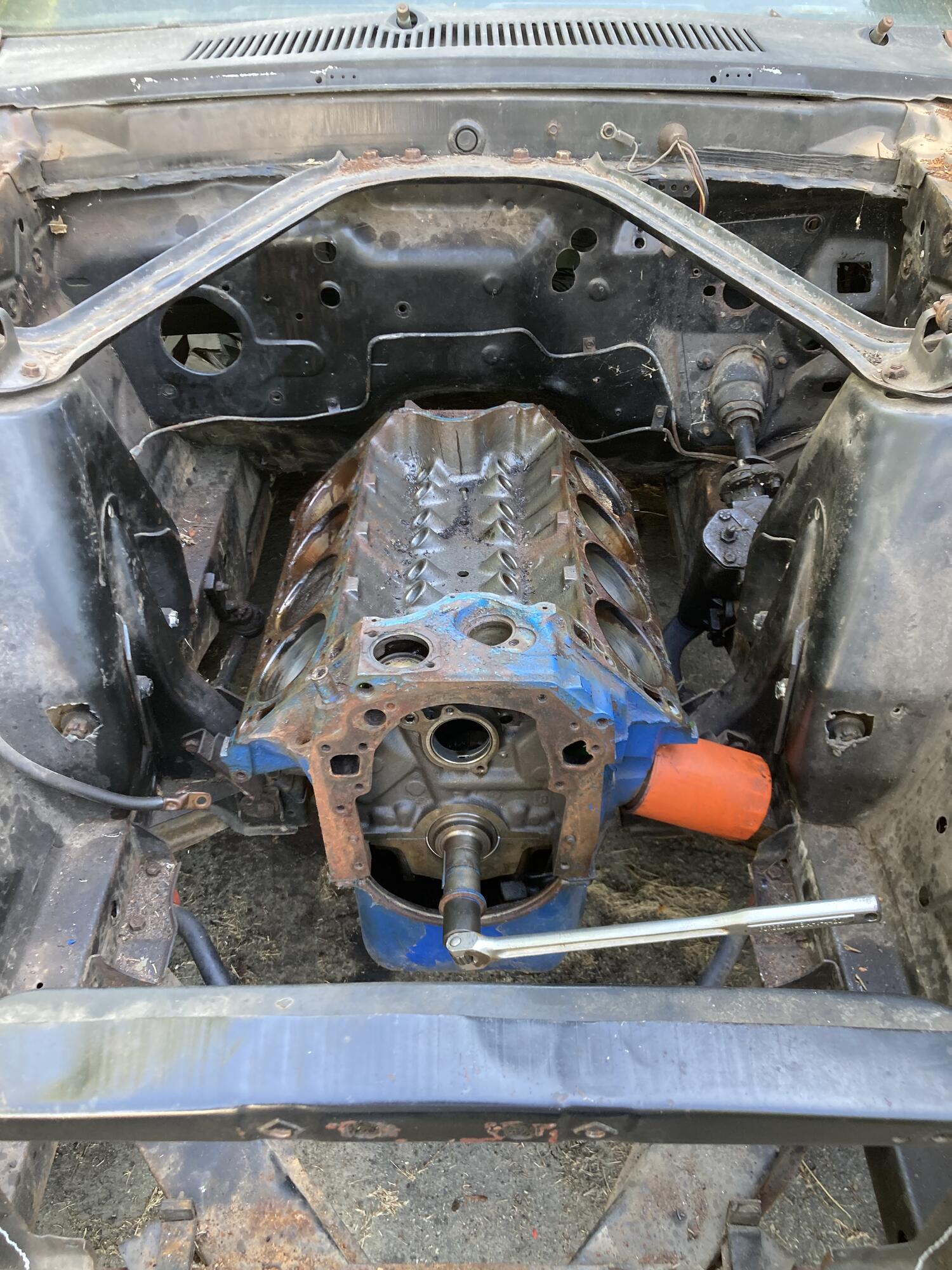

      Pulled the block out of the car and finished disassembling. There was some surface rust in #2 & #4 cylinders. Number 6 piston has a broken ring groove wall between 2nd ring and oil ring. I don't know what happened to it, there was no rust in the cylinder and the piston slid out fine. I had forgotten my pistons had been knurled so I'm thinking I might be looking at minimal boring with the needed cylinder cleanup.
