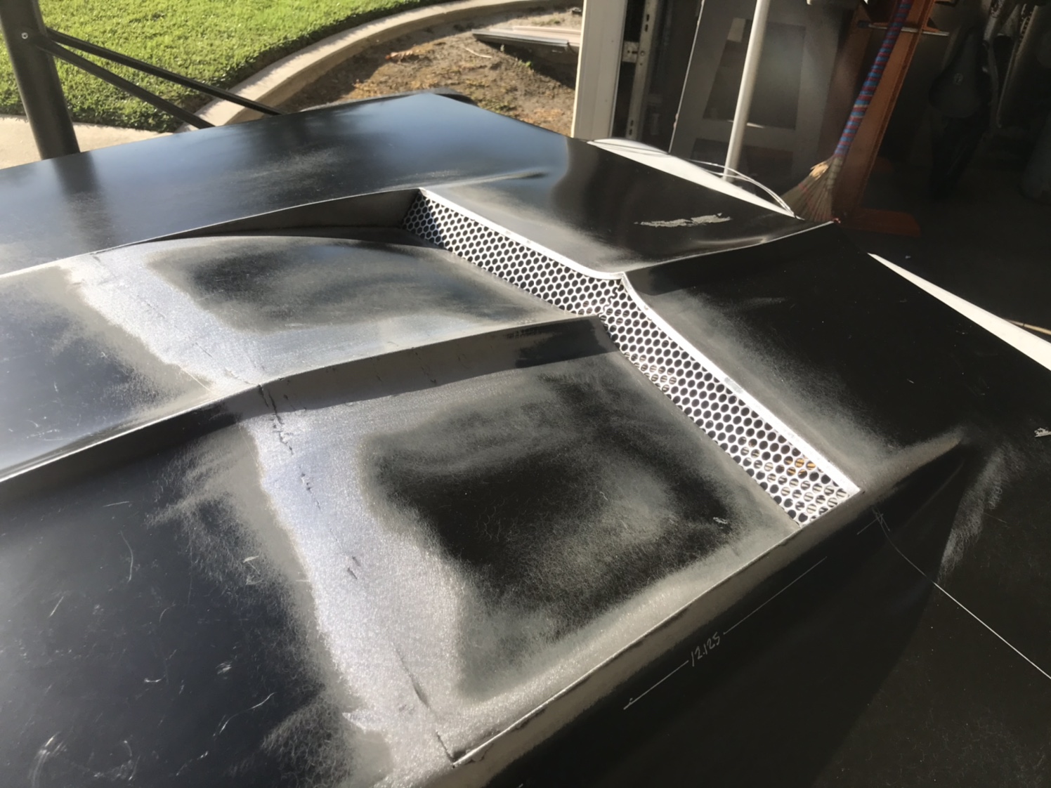

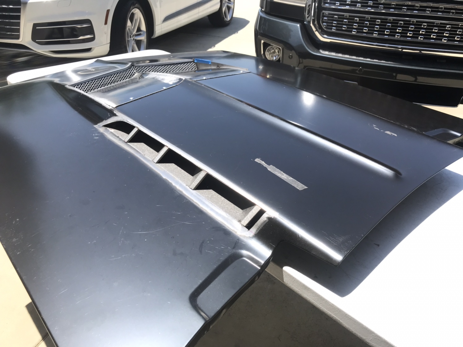

      Quote Originally Posted by frankv11 View Post

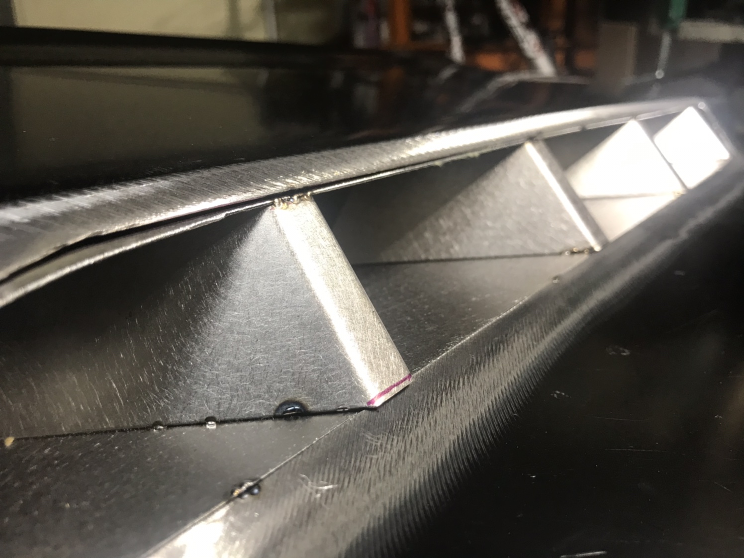

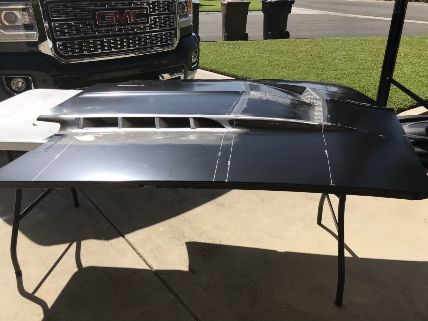

      Just finished this commissioned hood for Brad @1969camarobuild , maybe running a few of the side louvers , Attachment 176320Attachment 176321Attachment 176322Attachment 176323Attachment 176324
      Wow! Those are excellent!

      All I can say is wow and I wish I could Tig!

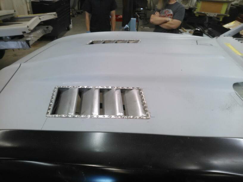

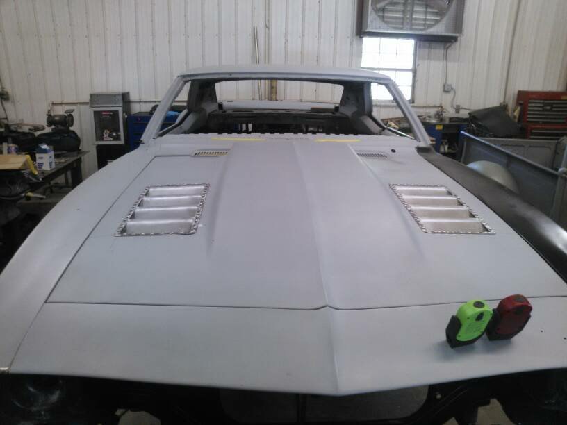

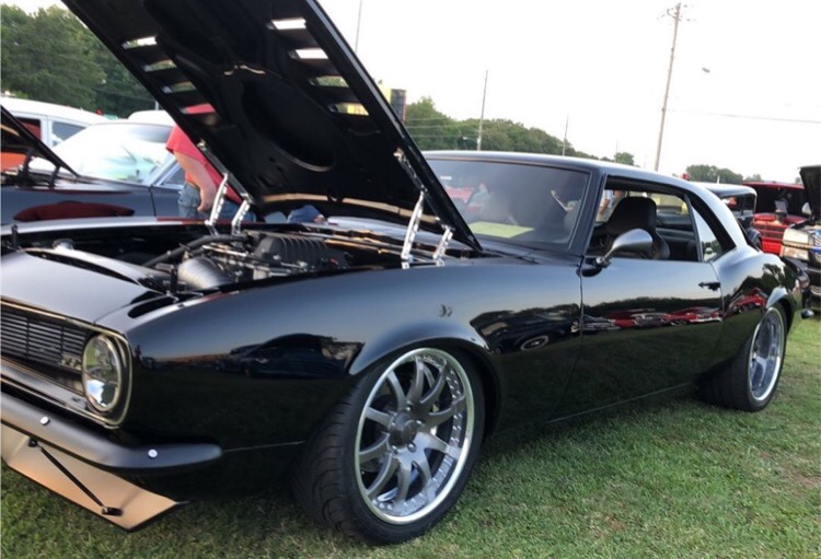

      Dave,. The ones your referring to frank sold to me and I wanted an industrial look so we layed out and drilled 48 holes for button head stainless steel Allen bolts.
      A guy could do 24 or whatever but it was what I wanted. My car has forgeline ZX3R wheels so that will match nicely. Wheels are black barrels and brushed titanium centers so I figure I'll paint Frank's vents with a stainless steel type paint to get the brushed titanium look on them or may. Even just clear coat them for the look I'm after. I'm also running ride tech stainless cage with similar coating. So I'm theme throughout the car black /white ad stainless / carbon fiber.
      You could easily drill and bolt or Tig your bolts for studs as you said. I'm super pleased with how my turned out and more so with Frank's work

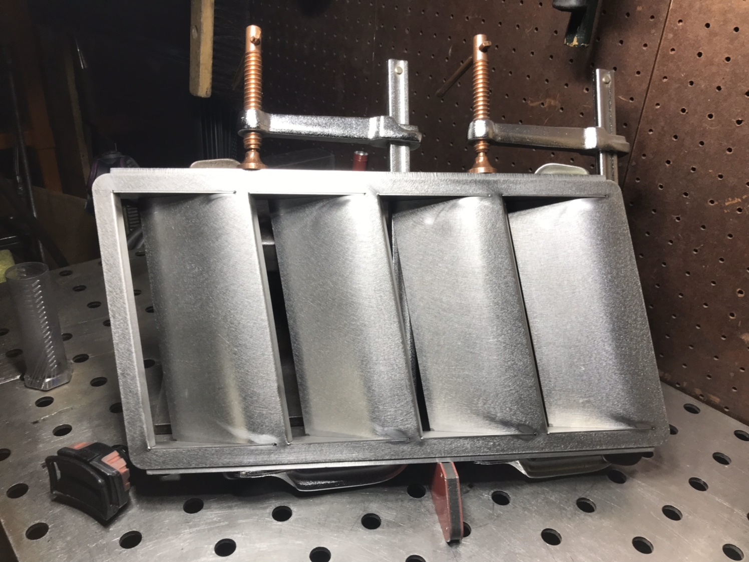

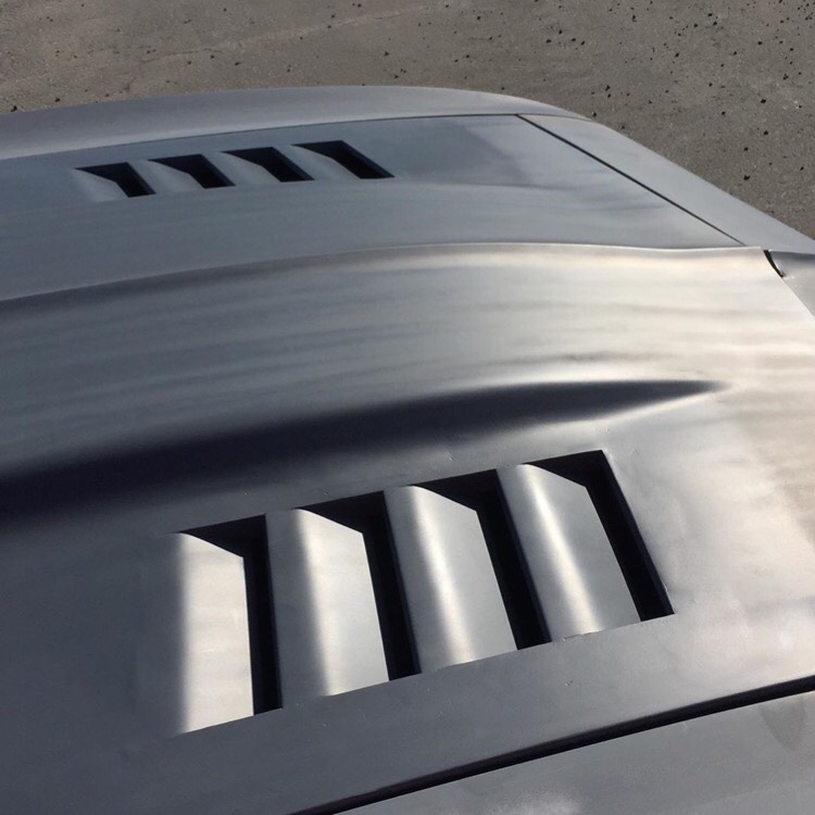

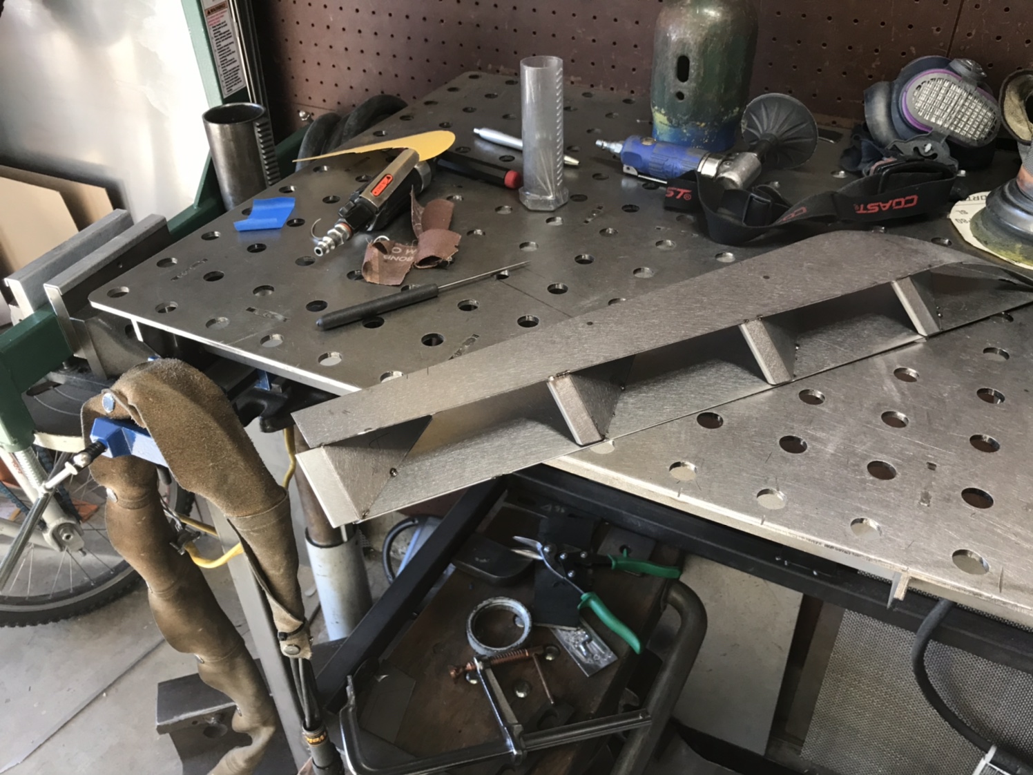

      Hood louvers louvers for 1967 1968 1969 camaros but will fit many makes and models . Clients have used in novas , Chevelles, mopar , etc..
      Attachment 173660Attachment 173661Attachment 173662Attachment 173663Attachment 173664Attachment 173665Attachment 173666

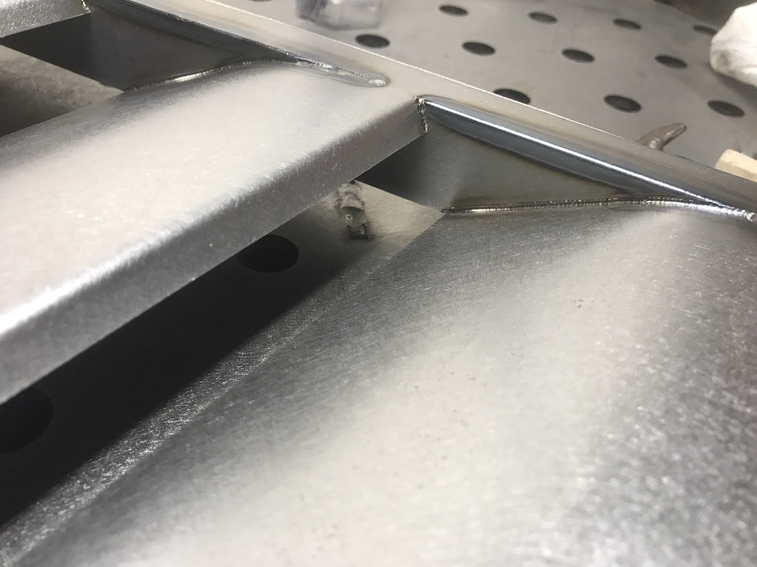

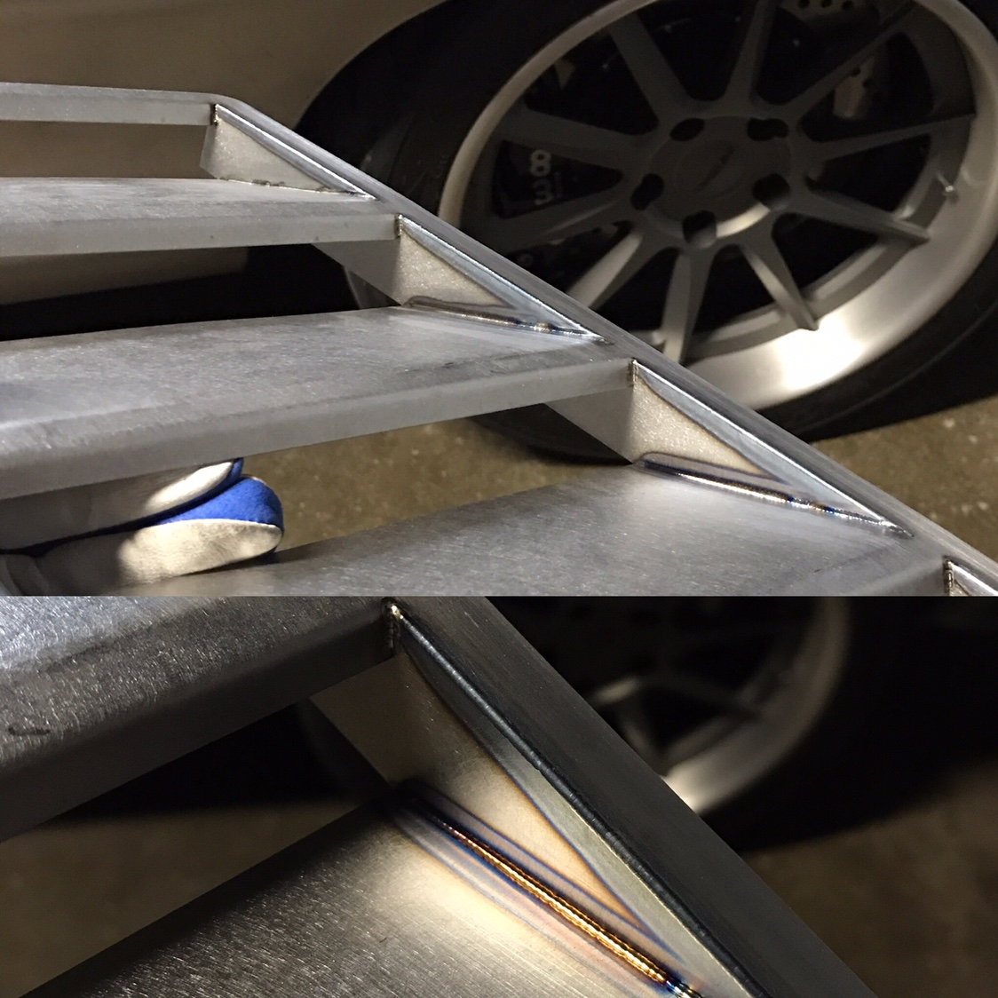

      I will be offering these in two styles both will have 9 degrees slant to match hood to header panel line. 20 gauge body , 16 gauge parallel rails for extra strength and an overall body curvature length wise to match hood Contour .
      1st style ( radii version )will have a radii / curvature on each individual louver . 2nd style (slick ) will have flat surface at each louver
      REMEMBER THESE ARE UNIVERSAL . So they fit many other makes and models. $650/ pair fully tig welded and shipped anywhere in the USA
      These are awesome !!! Love the ones in the side of the scoop

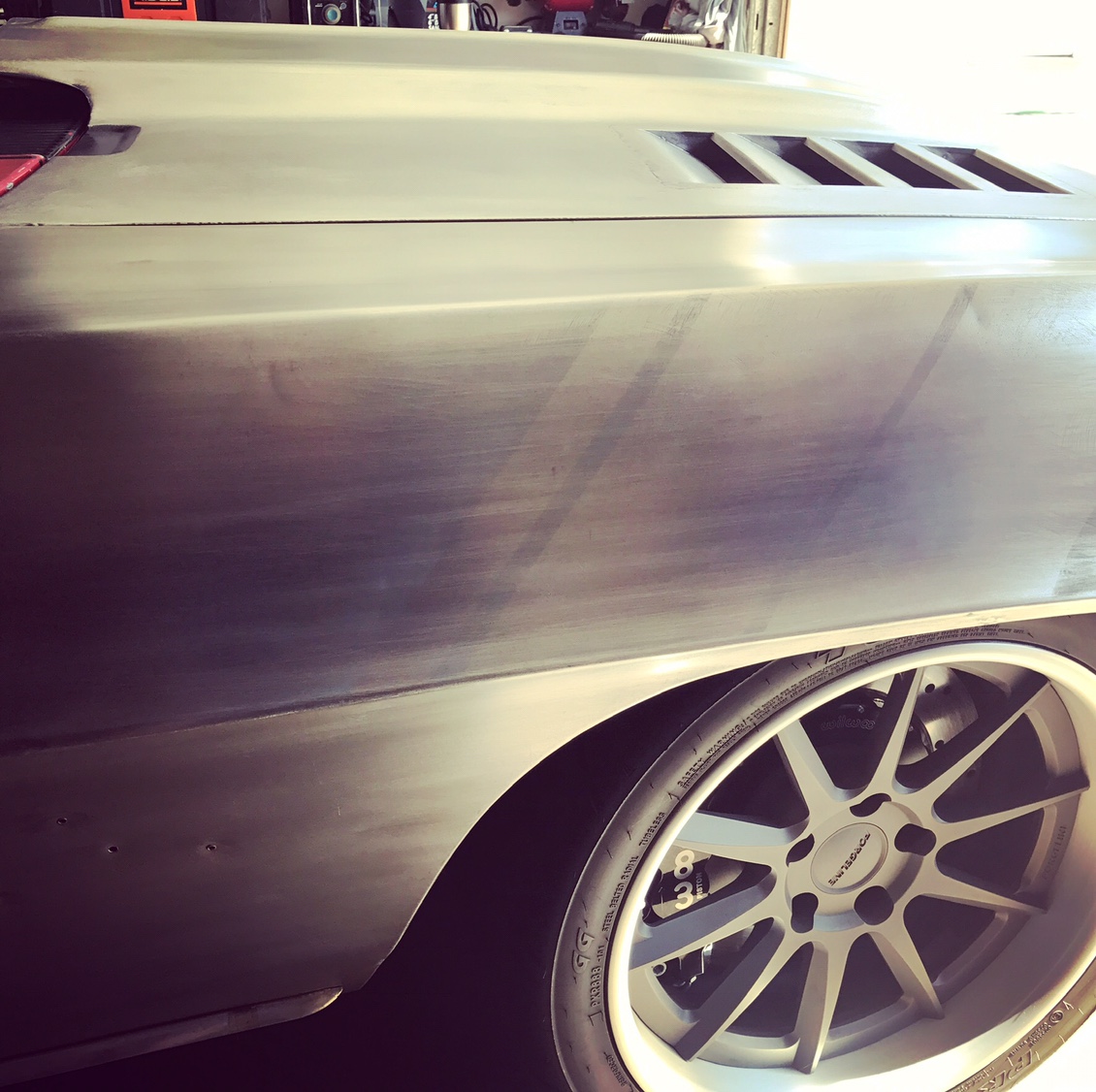

      Any pictures of that setup?

      Here ya goName:  tapatalk_1589855752093.jpeg

      This hood looks amazing - I might have to get those side vents

      Hood louvers
      Very nice job Jason ,
    19. #39
      Jul 2010
      south gate
      208
      Very nice Jason
    20. #40
      Sep 2017
      839
      Thank you sir
