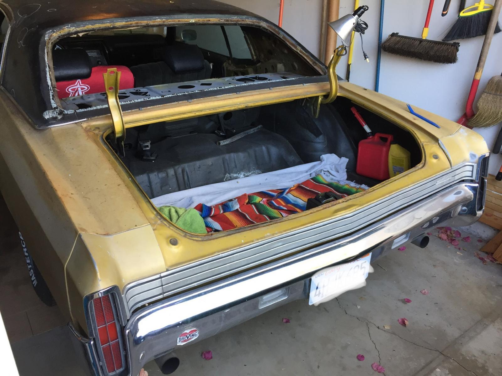

      On that note, time to get the heat gun and glass removal cutter tool and liberate the rear window. with the window glass out, i can address the rear window channel rust.
      Feb 2020
      Irvine, CA
      25
      Aaaaand, we’re off

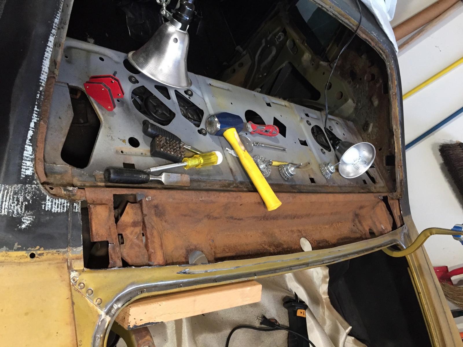

      Oof. Some compassionate amputation needed

      Ewwww, that glass channel is crispy! But it's not so bad it can't be fixed.

      Crispy indeed - The rust was pretty bad in this area. In addition to gearing up with whire wheels and freshly charged drill batteries, I feel like I needed a tetanus shot from just looking at it!
      The next step was to take measurements of the window opening and panel surfaces and cut out the rusty sections on the channel, quarter panels, and center filler panel. To do this, I first center-punched the spot welds and then drilled them w a spot weld cutter. The last bit of coercion came from a few bumps of a pneumatic air chisel. I tried not to get too caveman on this step and distort panels. here's a pic near the end of the fill panel removal

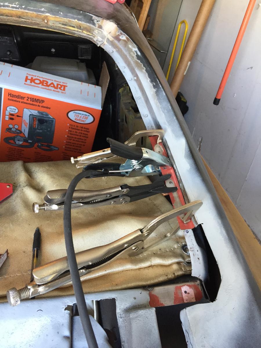

      and the drivers side "shoulder" of the window channel mocked up. This came from a vendor that specializes in patch panels and needed very little shrinker/stretcher work to blend in. it still took me a while though because it s a new process to me

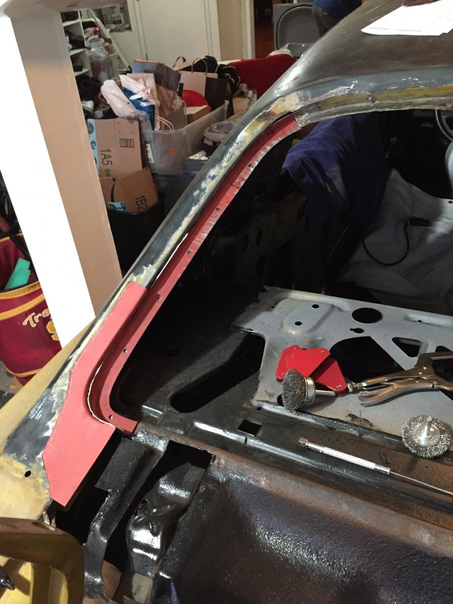

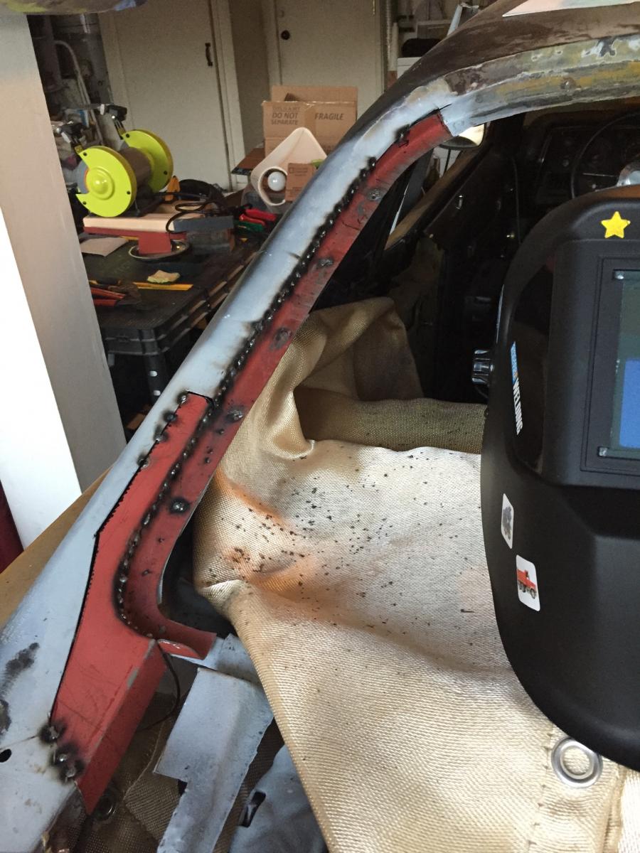

      Tacked in the patch panels after some weld through primer. Realize the weld through primer will have to get sanded off or sealed before paint since the zinc/etc in the weld through primer may not play nice with body filler, seam sealer, or regular primer. Next steps are to tack in the passenger side and weld up both sides and grind down flat being careful not to add so much heat from either welding or grinding to create warpage. After that will come the center fill panel

      Reconstructive surgery on the pass side. Feel kind of like Dr Nick Riviera...
