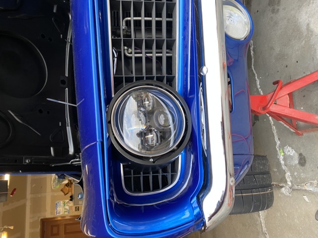

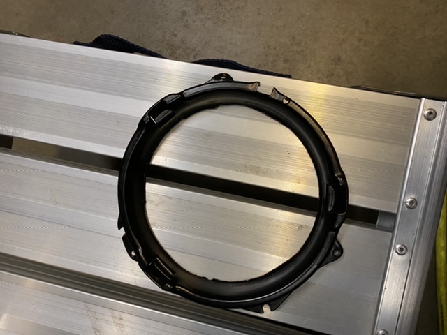

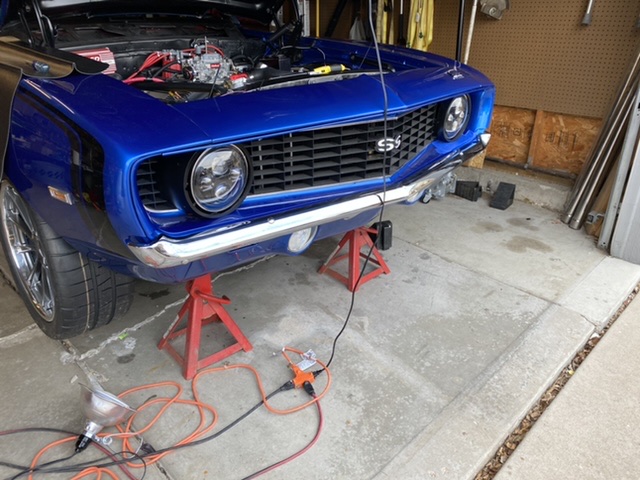

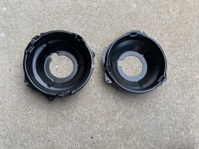

      Installed
      ok. So here are some pics if anyone decides to do this in the future. It was pretty easy, just needed to trim the buckets a bit, but that’s it. I think they look pretty good!
