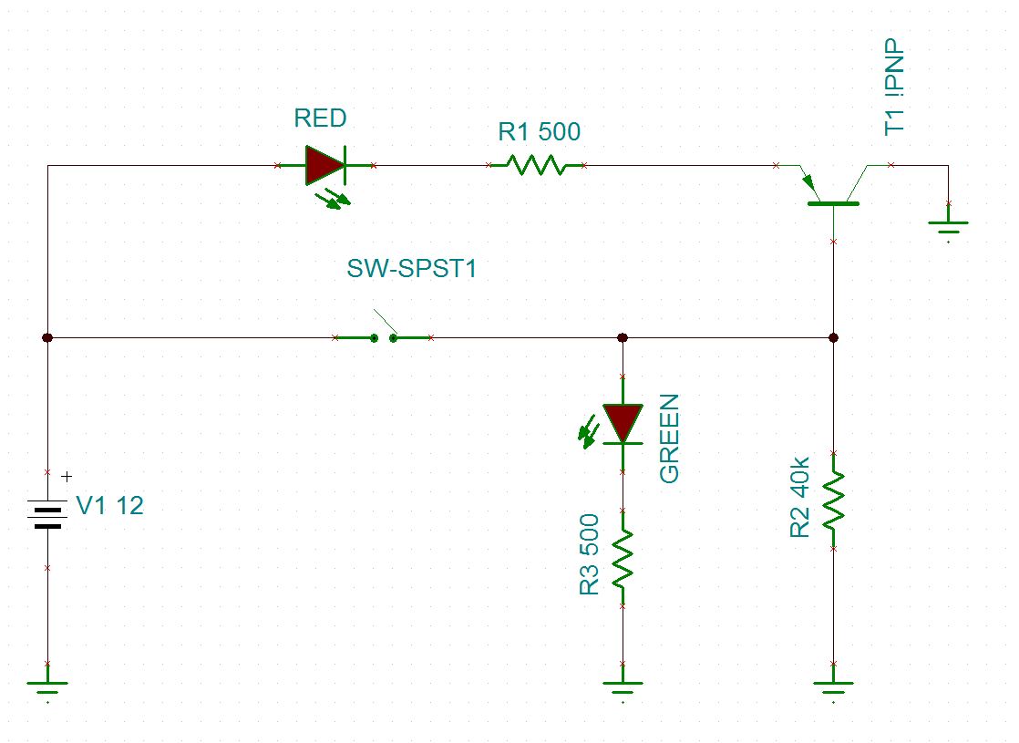

      A LED across the switch is the correct answer but you need to add a transistor as you don't know the equivalent resistance of the load. Something more like this would work. R2 represents the load, in which I used 40k but it could be much less or more depending on your car.

      Quote Originally Posted by blitzer454 View Post
      Way to bring the tech but a SPDT switch as proposed above would be easier. I am guessing it would work with my suggestion and some diddling of the resistor value if needed. Worst case add a tiny load resistor. It just comes down to LED intensity...
      Anyway, I am guessing we have scared the OP off by now... ��
      Don

      The problem with just trying to diddle with the resistor value is that this may cause a significant voltage and 20mA across the load even when the switch is off. But I'm with the guy that suggested eliminating the red LED altogether as it's redundant.
