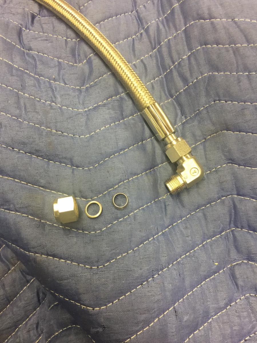

      looks like sweg-loc. Street performance had these in the past, Not sure that they open anymore. The fitting where design for steam presser on control on equipment.
      - - - Updated - - -
      sorry on the spelling, it is swagelok
Size:  79.8 KBName:  IMG_3306.jpg
      Still think it’s swagloc. See attach picture of the one I have.
