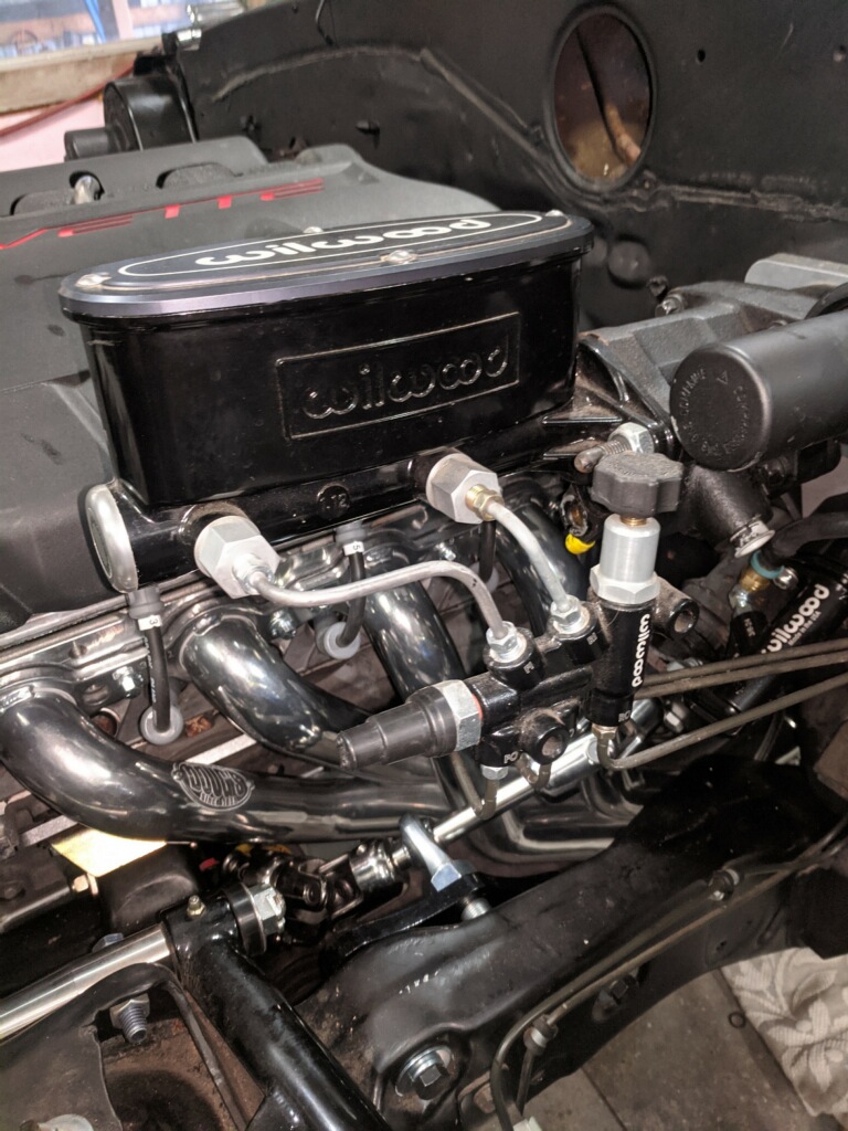

      Wilwood MC and HB, Gen4 ls pump, Unisteer r&p

      Bumping this thread, bc I'm still stuck trying to figure this out. Stepped away for a few weeks and now this whole Covid lockup has me back on it.
      So here's my dilemma...the ls ps pump flows out at a 1.5 gpm, the HB flows at 3gpm, and the R&P I have "likes" around 2gpm. The diagrams that were posted from the C10 forum make sense, BUT, I only have 1 return port on my ls ps pump. This would all hook plumbing wise if I "T" the low pressure return to the ps pump? I've been told not to T a high pressure line, but what about a low pressure return? If not, anyone know where I can get a gen4 ls ps pump that has 2 return ports?
      Also, do I need a reducer valve to cut the flow to the rack since it likes 2 gpm, and the HB flows out at 3gpm? The HD is from a 04-06ish GM HD truck btw.

      I don’t know if you solved this yet but I had the same setup on a 68 Firebird with an LS3. I ended up calling Jones Racing in PA. They built me PS pump with the right volumes and pressures to make and the components happy. I did end up running a remote reservoir for the PS pump but everything works flawlessly. They were fantastic to work with. Great customer service.
      Jan 2020
      Northern VA
      65
      Get an external fluid Reservoir like this: https://www.summitracing.com/parts/pfn-sr146h610sa
      That's just the first one I was able to quickly find doing a search on summit, but it has 3 ports specifically for running HB. So you could use that and do the low pressure return from the rack and the HB to that reservoir and than the main return from the external reservoir back to the power steering pump. Putting a small cooler inline would help everything too.
      What size is your master cylinder? And are you dead set on running HB? I know you're already pretty deep into this, but changing up to manual brakes or if your cam will allow it, just running a regular brake booster could save you additional headaches.
      I'm also worried that the U-joint making that almost 90* bend is going to bind and give you steering trouble down the line. The shop I use to work at put that same unisteer setup on a 69 camaro and we had a binding/clicking issue in the steering that took forever to resolve.
