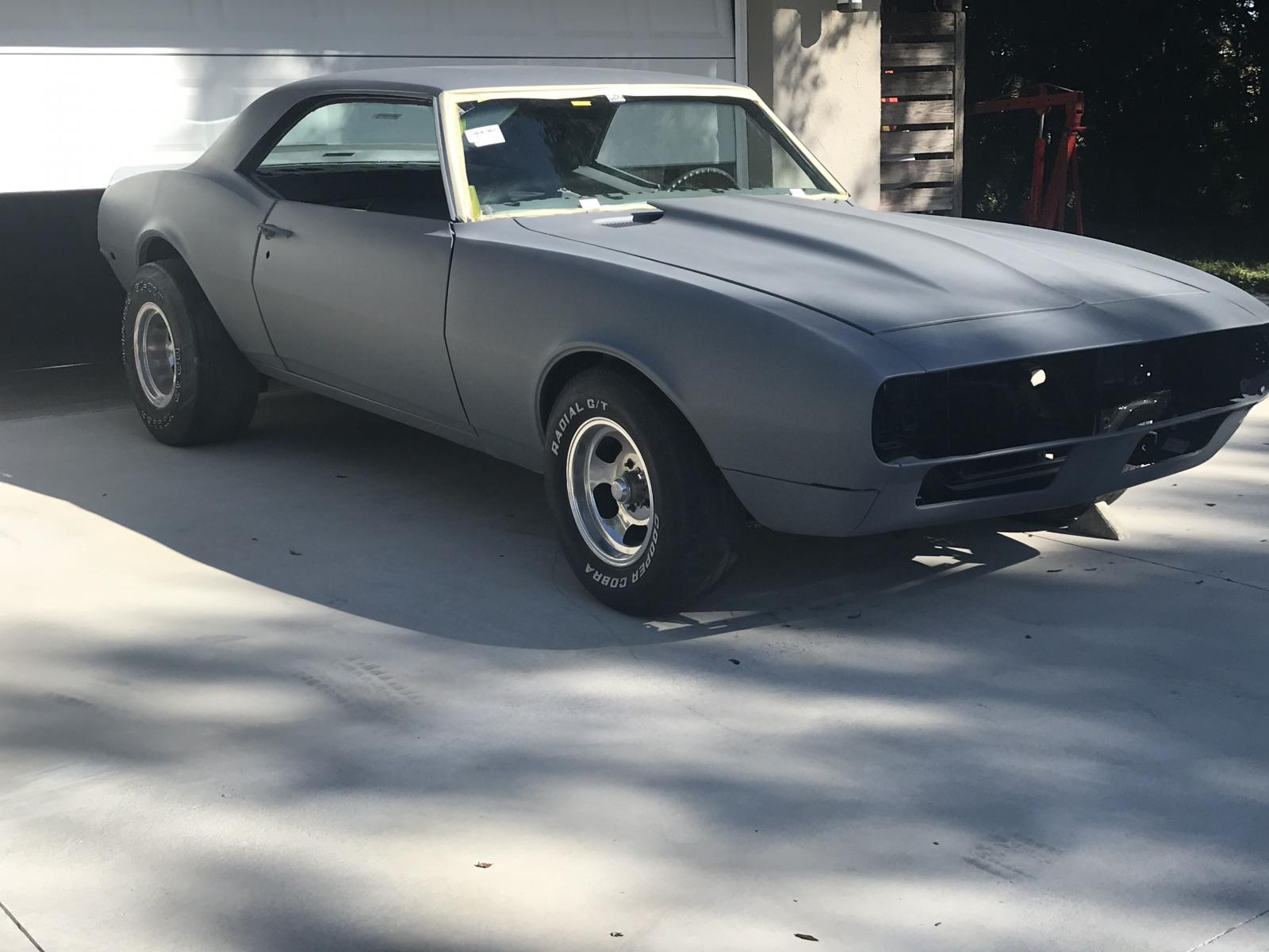

      So after searching I found my perfect foundation. A 68 Camaro with all metal fixed and a speedtech front sub frame.Name:  D2403DCC-1E64-4BA1-9BD0-1FDD60660770.jpg

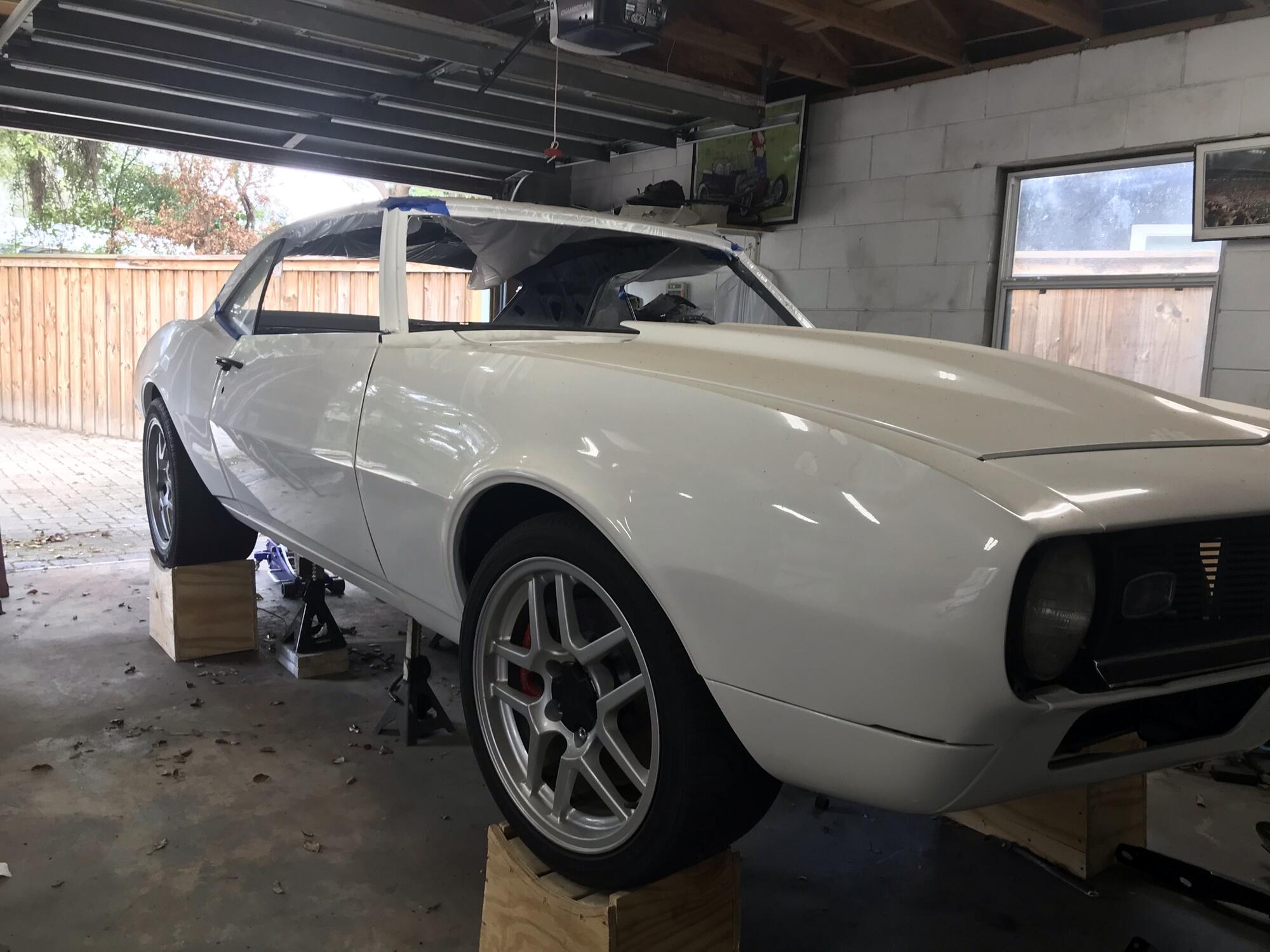

      So I found some new wheels, C5 Zo6 wheels (18x10.5 for the rear with 295's and 18x9.5 front with 275's). I think that I am probably going to change the front out to match the rear and when 295 squared on the car.

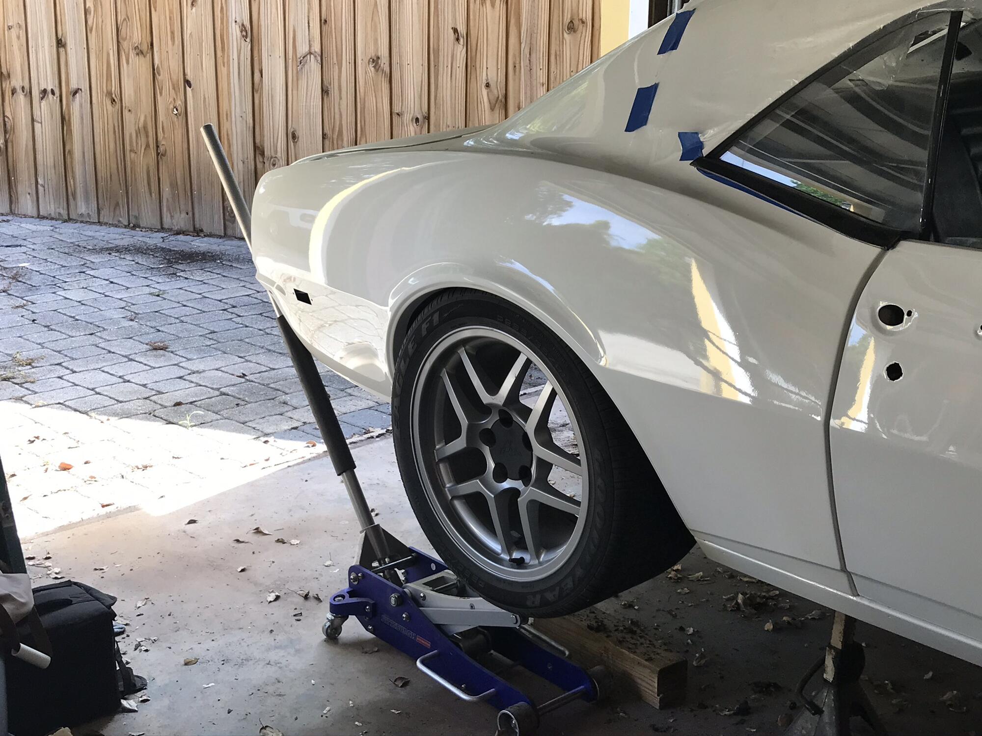

      Then after getting the wheels it was time to take out the rear end for refurbishment. this is the last of the old part to the car everything else was replaced or cleaned up. Also while working on the rearend thought it would be a good idea to mini-tub the car...

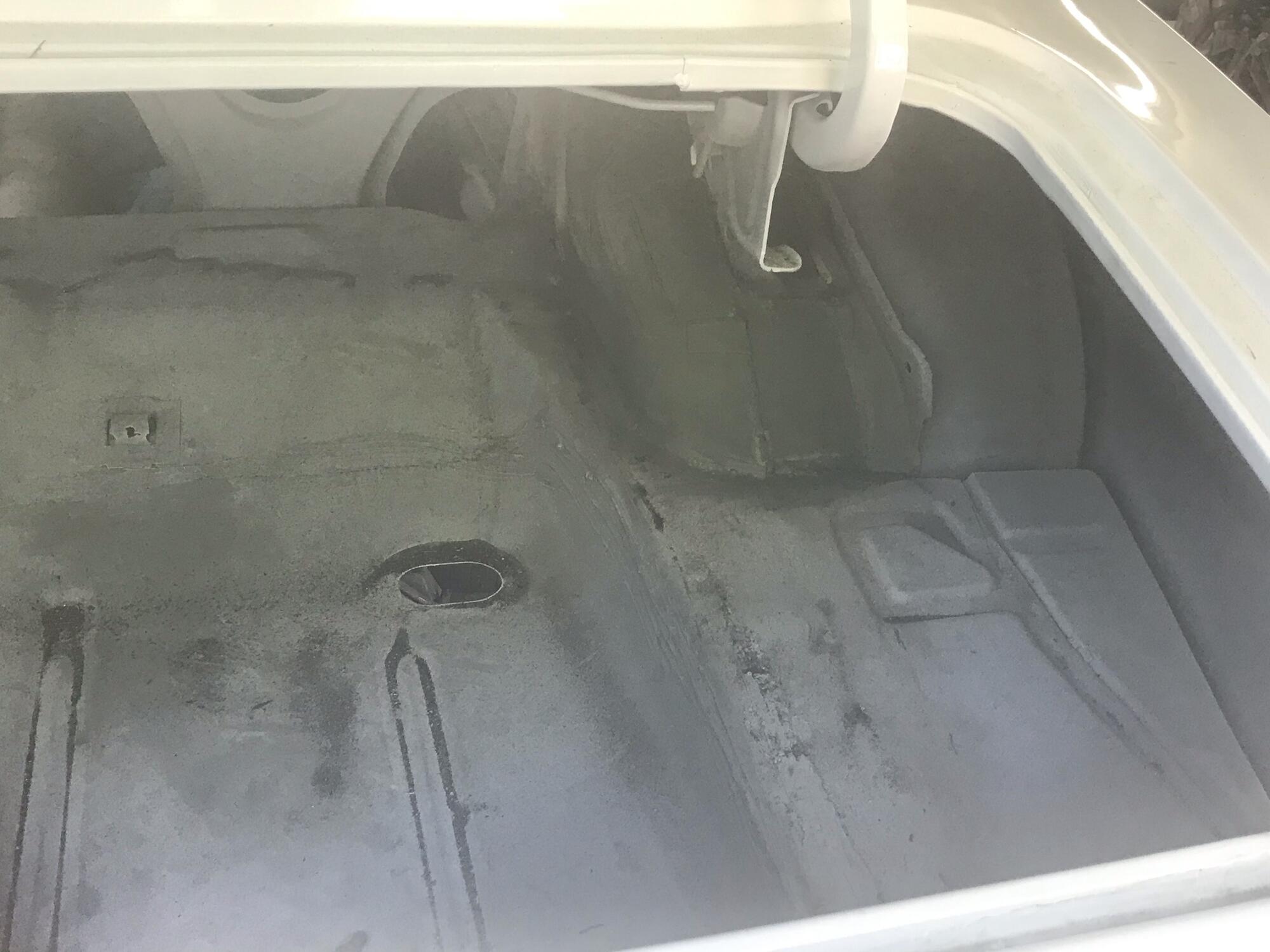

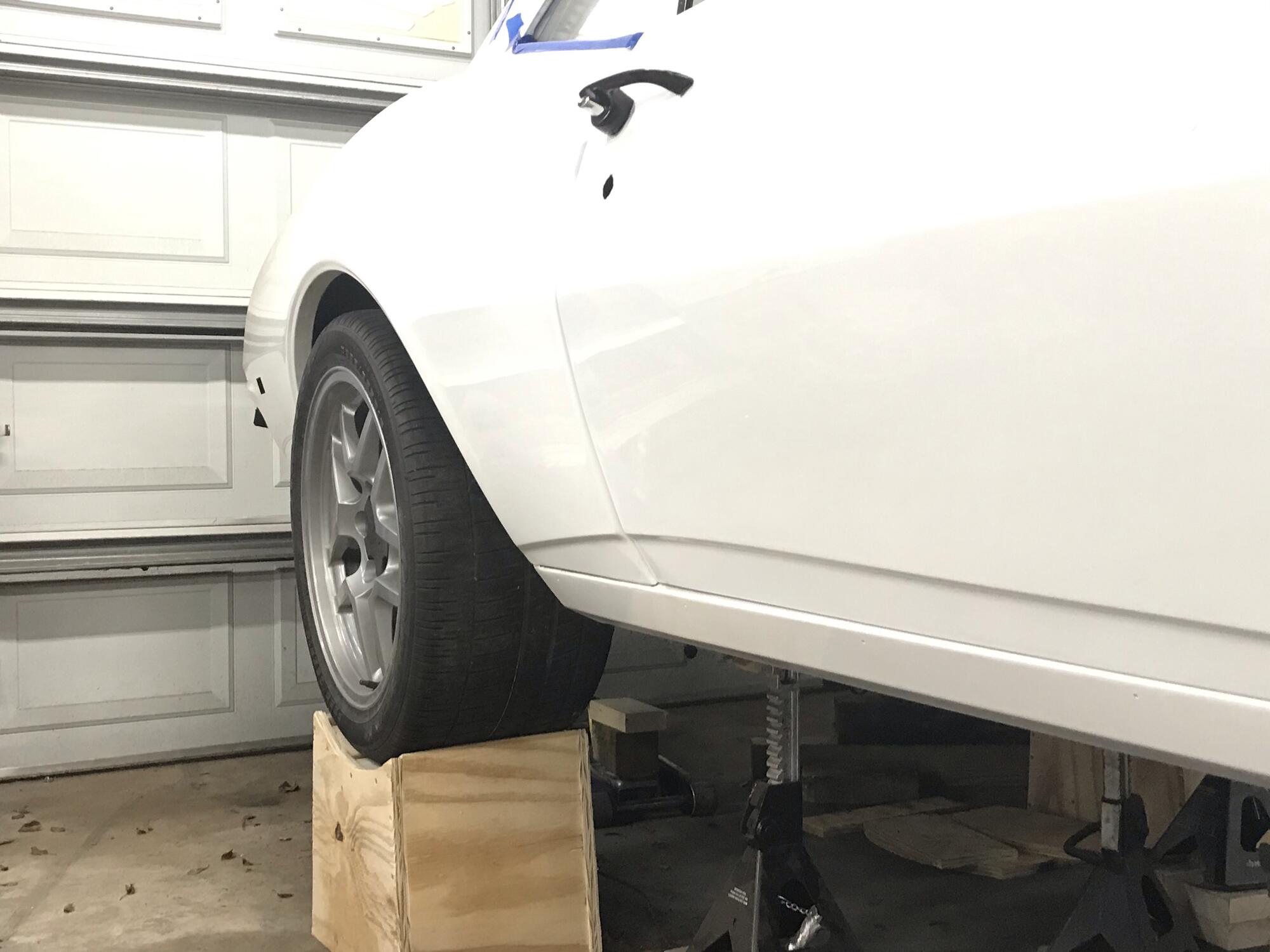

      After I got this all done i thought it would be a good idea to make something safer to hold the car while i worked on it. So i made some wheel boxes. this will allow me to safely get under the car to spray Raptor liner on the entire car. After that is done I will install the new 3" lower rear leaf springs, sub frame connectors and then start running the brake and fuel lines. Name:  IMG_8811.jpg

      I like the look of the Z06 wheels, did you have to use wheel spacers to get them to work?
      Jan 2020
      ORLANDO
      25
      for the wheels I have a wheel spacer in the rear (if I remember correctly it is either 1" or 1-1/2"). Currently on the front I do not have a spacer, I think that this is only possible because of the Speedtech suspension. I still might add another spacer to the front to push the wheel further out to the edge of the fender, but that is more of a "B" priority.

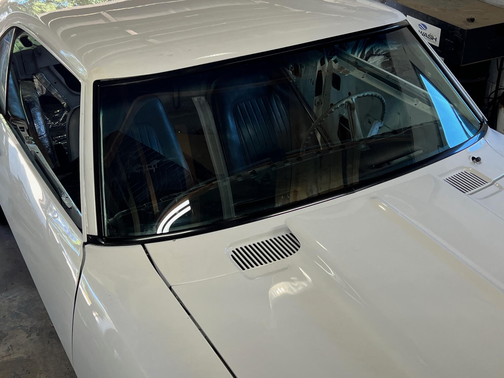

      When I first purchased the car, I came with all of the glass for the car including new windshield and rear window along with all of the trim. My plan was to always have blacked out trim (as I wanted to eliminate most of the chrome on the car), so I started on the trim. Getting it all cleaned upped, prepped and painted black. Then I had to install all of the new studs (or screws to replace the studs) from the new pane installations.
      This weekend we made a big cosmetic step and installed the glass back into the car. This was not that hard of a job, but it makes such a large mental jumpstart on the project.Name:  IMG_0005.jpg

      Great job on the black out of the trim, sure blends nicely. I am considering this myself on my build. Did you scratch the paint on the trim when the windows were installed?
      Jan 2020
      ORLANDO
      25
      The trim held up good during installation. I was originally going to powder coat the trim but I got impatient and decided jut to paint it. If it gets chips in time i will just remove and powder coat them then.
