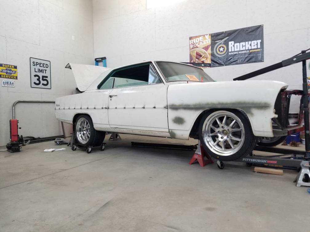

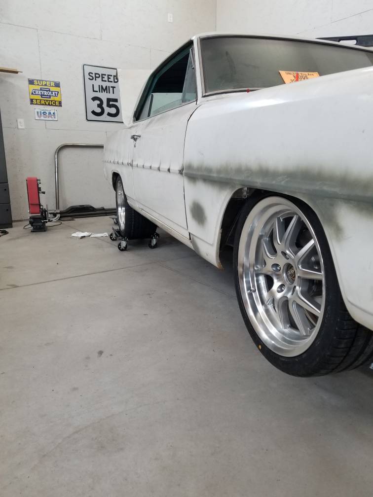

      Couldnt wait....rough mock up just to get a visual. 255/35/18 front, 295/35/18 rear. Not at ride height yet, but close....Name:  20200220_140751.jpeg
Size:  59.3 KBName:  20200220_140900.jpeg
Size:  57.9 KBName:  20200220_140735.jpeg
