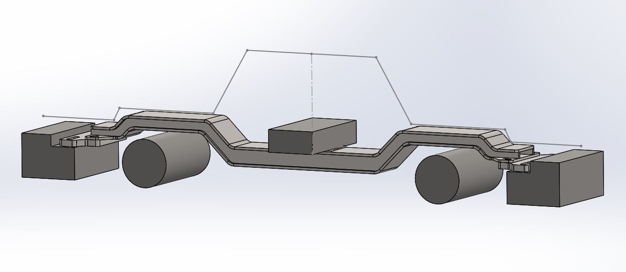

      Made my own
      I made my own, pretty simple design
      Thats a 3" exhaust nearly flush with bottom of chassis rail.
      Pencil line is the floor of my 68'

      Quote Originally Posted by thewgp View Post
      Its all mocked up. The headers are about 1/4" to high to clear the cross member.
