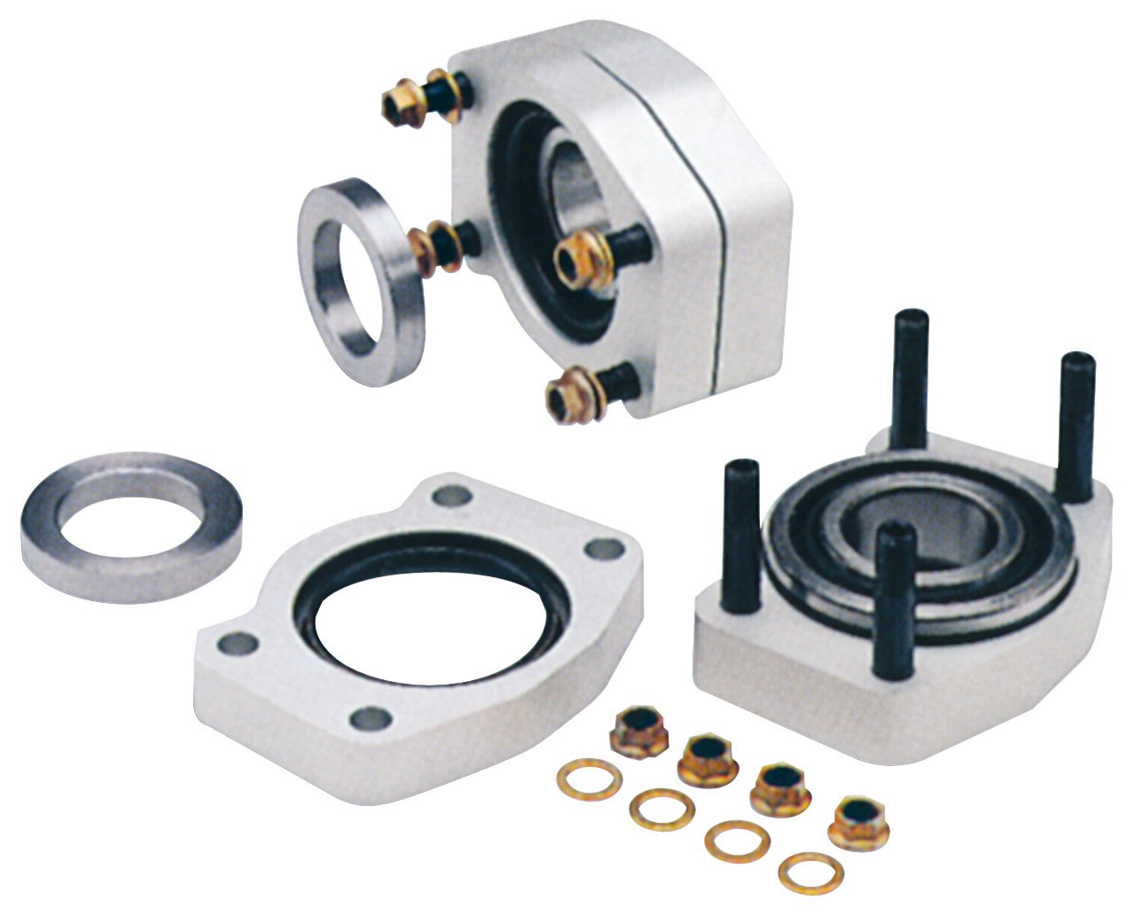

      Is cーclip Eliminator suitable for Auto cross? Is there a risk of the shaft coming off?
      I want to improve my Camaro brake knockback.

      They don't do well with side loads leading to leaking. Will they even help with knock-back?

      A more robust solution is to convert to sliding calipers. I just wish there was an easy way for me to do it with my Wilwoods.

      Moser specifically states no road racing or auto cross with their eliminator kit

      The C-clip eliminator is simply NOT adequate for autocross. A better solution would be to install big ford ends on your housing. They have tapered roller bearings which can take a side load. But by far the best solution would be to install a set of Baer floater hubs on your housing.

      Strange does have a C clip elimin kit that does use the same taper bearings as the Ford 3.150s.

      Here is the Strange kit he was mentioning:
      https://www.strangeengineering.net/p...-7735-pr.html/
