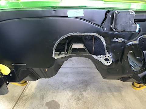

      A little more progress on 69 updates. Getting the rear brake lines bent up for the DSE / GearFX 9 inch housing and Making some room on the firewall for the LT4. Name:  IMG_0449.jpg

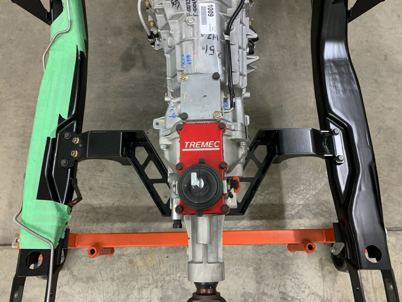

      More updates on the 69 "re-do". With the installation of the DSE sub, LT4 and Holley mounts...I had to make a bit more room in the trans tunnel for the T-56 and shifter. Fabbed up a new "pocket" for the shifter to live in.....almost time to repaint the underside and start some assembly....

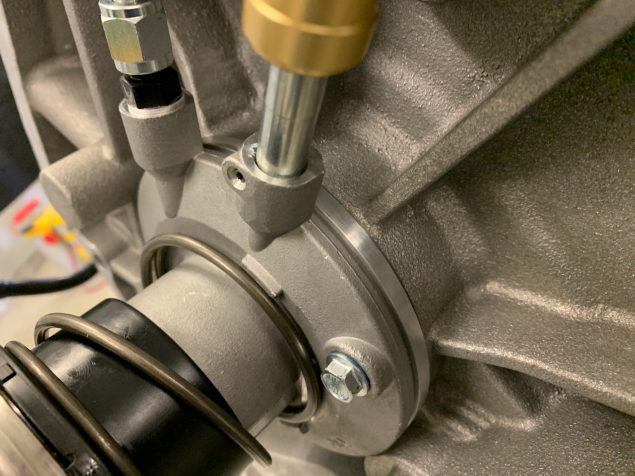

      Setting up the air gap on my throw out bearing, I needed to move the bearing out. The solution was a machined spacer from Mantic Clutch USA. MUCH better than the stacked spacers...... the machined spacer, properly locates the bearing over the input shaft. Getting closer to getting the DSE sub / engine back in the car.

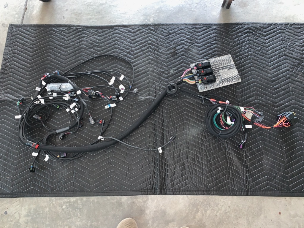

      The reassembly begins on the 69 updates... Received my Speartech wiring harness........ the workmanship is awesome. The rear end and DSE Quadralink gets installed. Name:  <span style='whitespace: nowrap'><a href='https://www.optimabatteries.com/en-us/redtop-starting-battery?utm_source=ProTouring&utm_medium=Display&utm_campaign=FY%2719_Brand_Media&utm_content=RedTop' onclick=battery.jpg Views: 939 Size: 129.4 KB" style="float: CONFIG" />Name:  rear 1.jpg

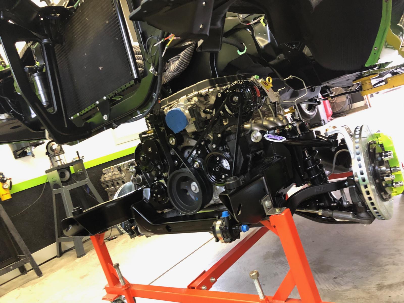

      Turned the corner today....installed the DSE subframe, Speartech harness, Drive Junky Front drive, and the LT4. Also fabbed up a bracket for the inter-cooler pump.
