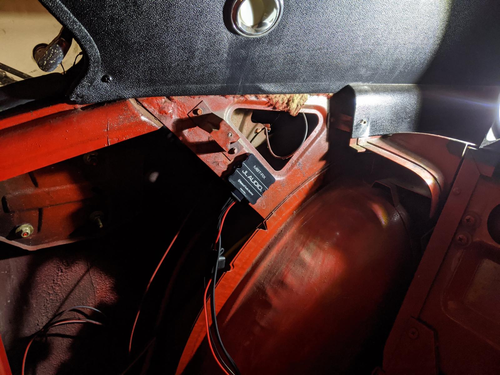

      I was tired of not having a radio to listen to anything, so I started watching ebay and started collecting speakers and an amp. I'm not sure where I'll mount them but I picked up some alpine 6.5 components for the front, and 6x9s for the rear. Bought a JL Audio XD400/4 amp from a friend and started mounting it all up. I removed the radioshack speakers from the rear deck and found the mount holes were really jagged sheet metal. So I busted out the dremel and made some nice smooth holes using the templates that come with the 6x9s. Tweeters mounted with a 2" hole saw, nice and easy. Mounted the amp to the back of the rear seat, when you are standing at the trunk and open it you can't even see it unless you duck down. I picked up a $40 JL audio bluetooth adapter, this has RCA outs and the high definition audio codec to stream high quality audio over bluetooth. I decided to try with no head unit for now, and control everything over bluetooth with my phone. Once I got the rear speakers and amp wired up I sat in the car and listed to some rock songs, and was unhappy with the lack of bass. I tried a few settings but gave up and found a JL audio 10w3v3-4 subwoofer locally. It's in the mail now, not sure where I'll mount it. Possibly the rear deck because I really don't want a large box in the trunk. Trying to keep it all as clean as possible.Name:  IMG_20200115_212522.jpg

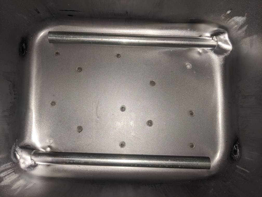

      I ordered a 22gallon EFI tank from tanks inc. Ive read mixed things on their baffles not being good enough for track use at low fuel levels but figured if it gives me issues I'll make a surge tank setup. After I got I I was pretty impressed with the sump actually, it has L shape tubes so that when you turn/accelerate/brake the fuel can't drain. The finish is also very nice on it, for the price I have zero complaints.
      I ordered the 400lph pump assembly from tanks inc. I'm building the fuel system to support 800hp easily which should give me plenty of room for growth. The pump is turbine style and is pwm compatible. I'm going to run it with a solid state relay from a Jeep cooling fan setup which only costs $30ish with a new connector. Part number RY330K for anyone interested, found it on the megasquirt forums. Name:  IMG_20200827_180240.jpg
