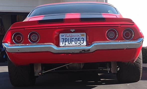

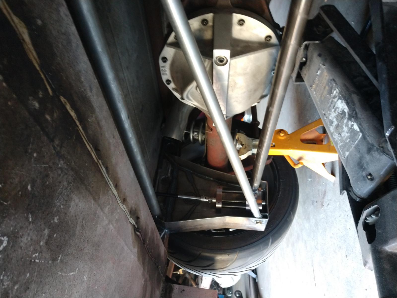

      First project:
      The first big project after my first SCCA event with the car was a panhard rod... the drag race style 4 link that it came with was allowing a massive amount of lateral movement.

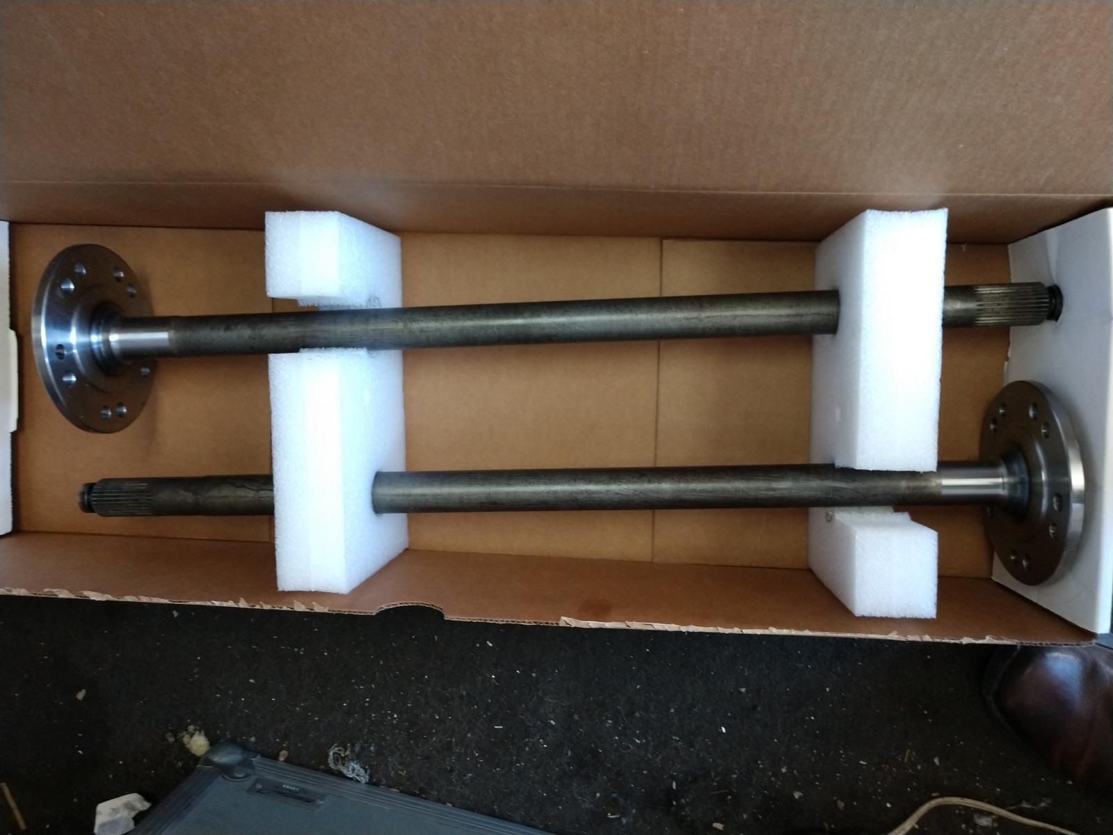

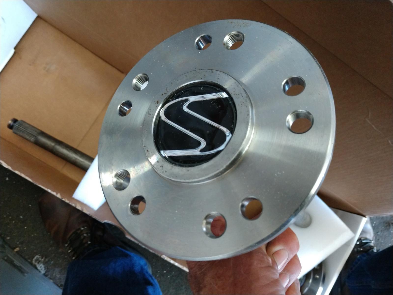

      CHANGES to the 12 BOLT rearend
      replaced 4.88's and clutch style posi with,
      3.90's and a True Trac posi
      replace no name axles with Strange axles
      new, 3 inch long 1/2 inch ARP wheel studs
      new bearings and seals
      drilled "drain back holes" for oil return from the tubes
      new brake pads and new vented/slotted (not drilled) rotors
