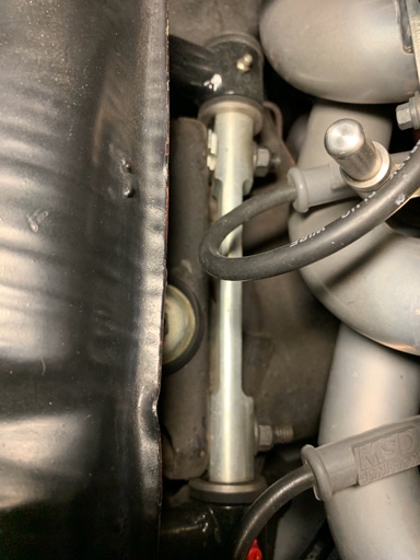

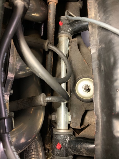

      Feb 2003
      Valencia, CA
      348
      Quote Originally Posted by dhutton View Post
      How many shims on the front and rear bolts?
      Don
      Not a bunch.
Size:  66.3 KBName:  IMG_2127.JPG
      Mountain Springs, Texas
      4,877
      I would try the upper balljoint mount. You could always add some more rear shims but you will gain more negative camber. I like to run -.5 degrees.

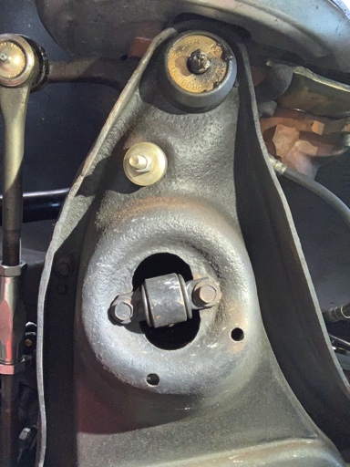

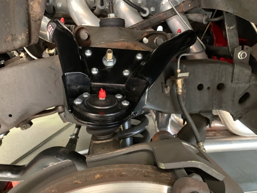

      Feb 2003
      Valencia, CA
      348
      Quote Originally Posted by 79T/Aman View Post
      post a pic of the bottom of the lower A-arm, the rear leg of the arm has a slight bend in it.
      Lower looks good to me and matches the factory chassis manual. Photos of the upper and lower driver’s side:
Size:  83.1 KBName:  IMG_2129.JPG
      4,877
      I would have thought the sway bar would not bolt up if the rears were swapped.

      Are you sure the car was never wrecked or took a severe hit to the suspension in the past? The only time I have had bolt-on parts from a reputable company not be in "spec" was when there was an issue with the mounting structure.
      Sep 2013
      Houston, TX
      274
      I know the QA rep said the sticker goes toward the front, but your upper arms appear to sweep forward, when they should sweep to the rear. Look at the angle of the balljoint stud, it should not point back like that. Try swapping the arms, left to right; I'll bet that fixes your alignment issue. All you have to lose is the time it takes to make the swap.
      4,877
      Quote Originally Posted by cdrod View Post
      Rodney
      X2
      Don
      1957 Buick Estate Wagon
      1959 Apache Fleetside
      IL/TN
      908
      lowers are correct but those uppers sure look wrong, that upper ball joint is too far forward.
      Swap them left to right
      https://www.protouringf-body.com "doing what they say can't be done"

      Feb 2003
      Valencia, CA
      348
      I just got off the phone with them again. Sent them the photos and measurements of the arms (front and back). QA1 tech believes they are installed correctly. For visual reference, they said that the center of the ball joint (red grease zerk cap) should line up slightly forward (towards the front of the car) from the snubber bolt on the gusset. Mine does. If the arms were switched left to right, that visual reference would line up towards the rear of the car.
      I'll take it to another alignment shop, but this one has been really good in the past...independent shop, good equipment, willing to set up to aftermarket specs, etc. They set up my 69 Camaro (full Global West front) and last month did my 57 Chevy (tubular uppers/stock lowers/tall ball joints) with perfect results. Still not sure what's going on here. I guess I could try swapping the a-arms left to right and see what happens. The QA1 cross shaft is "offset", but you only flip it from the "shallow" indentation (stock) side to the "deep" side for added negative camber. It's not a tapered offset cross shaft like others (Detroit Speed, I think) that add positive caster.
