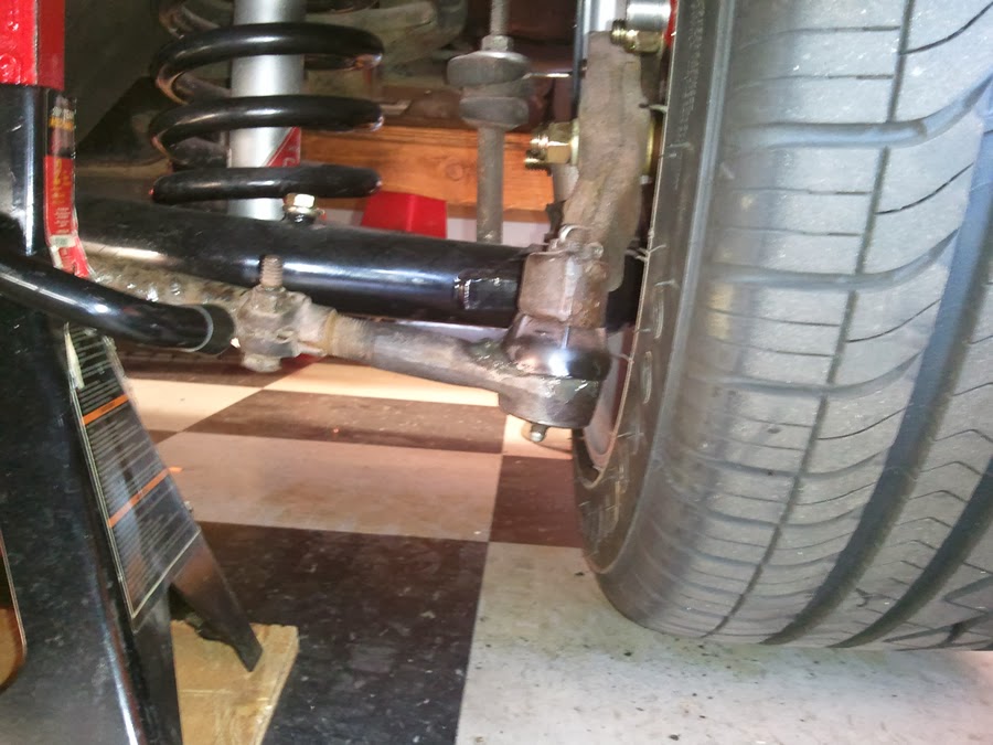

      Just thinking to myself here, I could use the ridetech tall spindle with the 2" drop rather than all the ball joints. It costs about the same.
      Dropping the spindle 2" isn't a problem:

      Modify the Steering Arms? It seems that modifying my steering arms will solve my problem. I only need to pickup about 1/4" to get my tie rod clearance. This could be done by shimming the steering arms out with longer bolts and spacers or by heating and bending the steering arms. Then I could shorten the tie rods by 1/4" (4-5 turns) and we are in business. Time to unbolt the front end and do some work.
      Move the Steering Arm Down and In
      After removing the wheel, caliper and disc I was able to get to the steering arm bolts. I removed the bolts from the upper position on the spindle and installed new 1/2" x 3" grade 8 bolts in the bottom position. Then I added three washers between the steering arm and spindle to give myself the extra 1/4" of clearance. (I also added 1/2" x 2" bolts to the upper position on the spindle. This is basically overkill as it only holds the dust shield on to the spindle.) I test fit the rim by re-installing the disc, caliper and wheel to verify the 5.25" backspacing actually cleared the tire. It's really close but it clears. I've read you should have 1/2 clearance for tire deflection but my tires are low profile and the tie rod is right at the point where the tire meets the rim so deflection wont be an issue.
      I now have the tie rods on the same plane as the lower control arms and have tie rod clearance off the tire.
      This setup is in-fact parallel to the plane of the lower control arm pivot and the ball joint.

      Well it doesn't seem that anyone takes issue with the pictured method of gaining wheel clearance? It looks like a go.

      The washers between the spindle and steering arm will affect your Ackerman steering. Because this is a rear steer chassis, it will increase the Ackerman effect. This is not a bad thing. It may make turn-in a bit better. However, it will affect bump steer because it shortens the total tie rod length.
      It's all about compromise.
      Feb 2008
      Macomb County, Michigan
      34
      Quote Originally Posted by cornfedbill View Post
      Thank you for the reply.
      Is there a correction for the increased bumpsteer, other than the Proforged tall tie rod ends? I'm lost on a correction...

      There are several options to mitigate bump steer. I would suggest searching this site and the internet. You may want to start here: http://www.pozziracing.com/first_gen_suspension.htm.
      One method for changing bump steer that some of us forget is to increase caster. This lowers the outer tie rod end and reduces bump steer.
