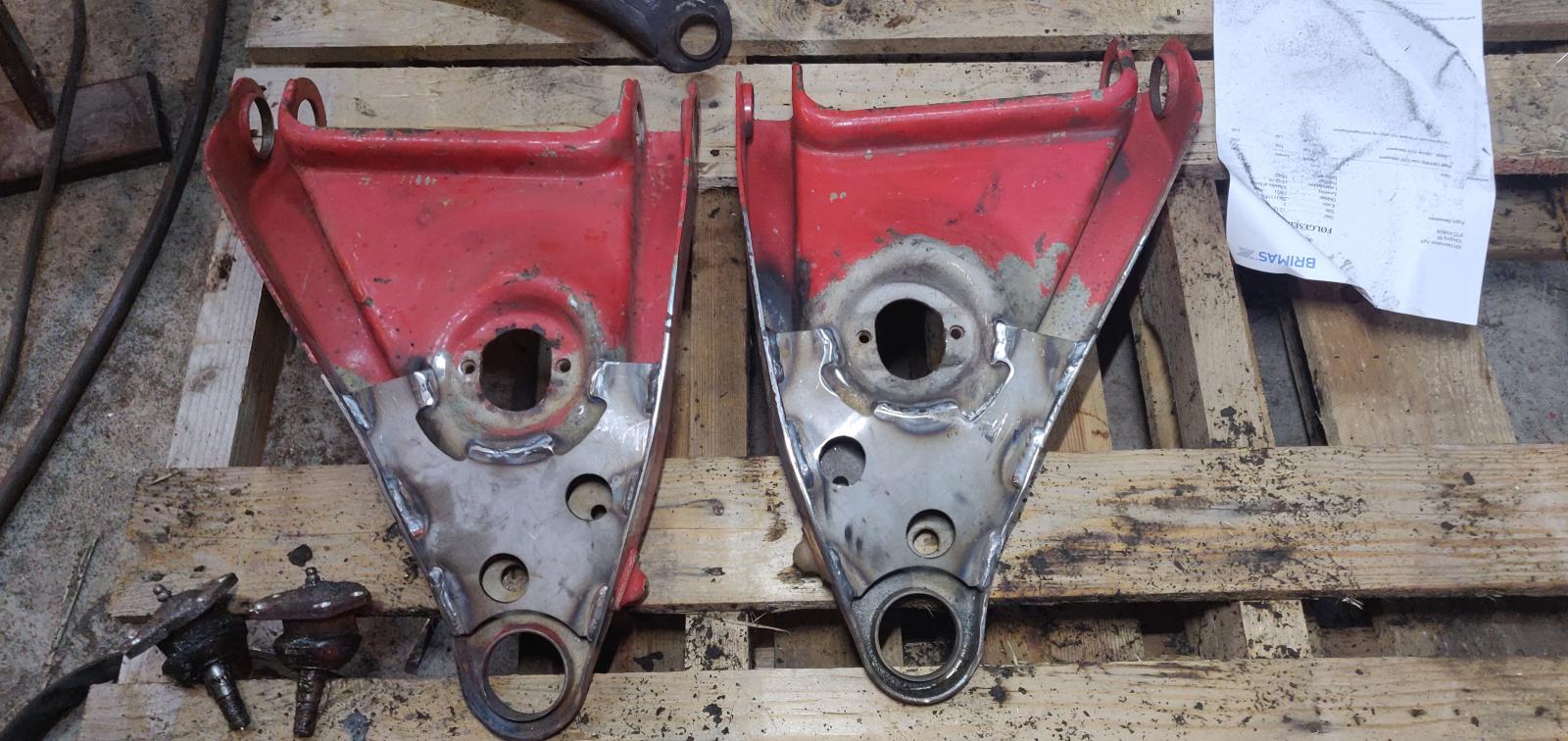

      Hi here is my template just need to get it lader cut and welded on
      Oct 2019
      Denmark
      4
      Country Flag: Denmark

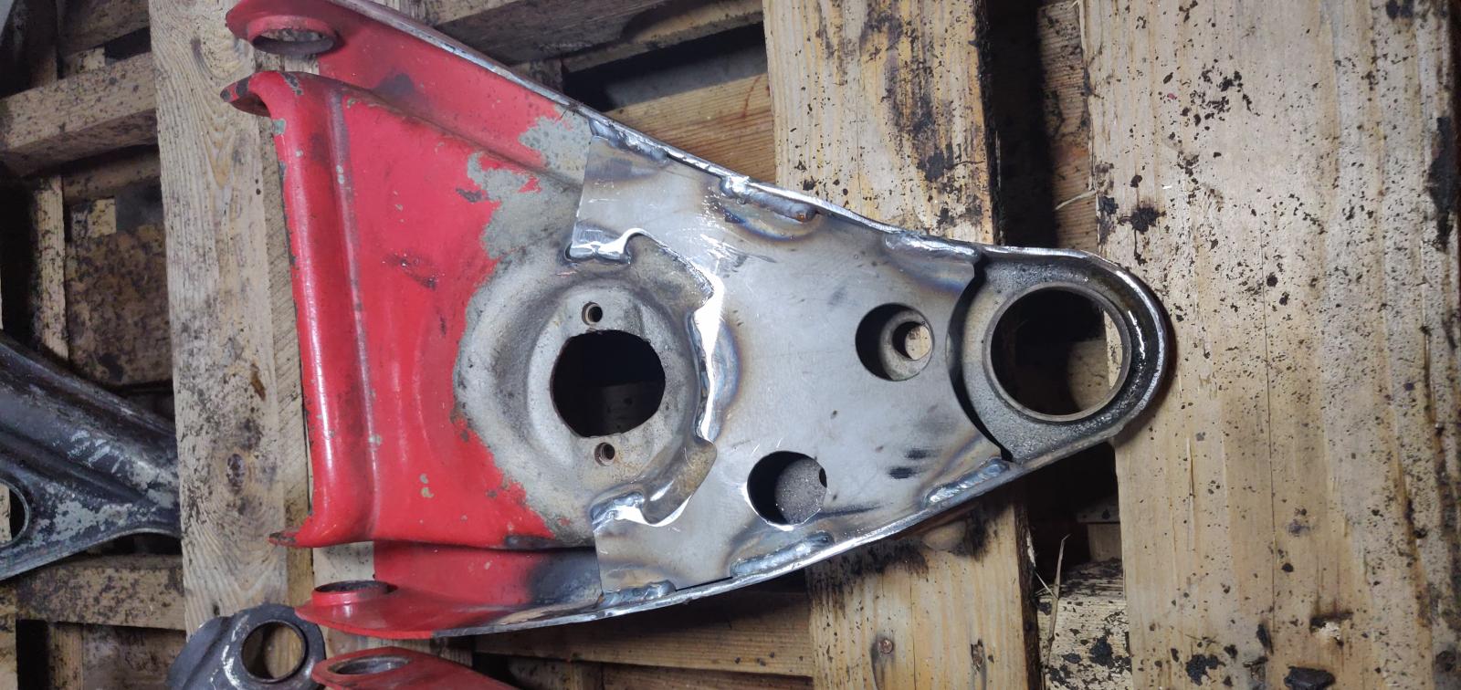

      Here is the result just need to get them powdercoated and put them the carName:  IMG_20200105_164214.jpg
Size:  202.7 KBName:  IMG_20200105_164222.jpg
Size:  201.5 KBName:  IMG_20200105_164218.jpg

      Think that some also strap around the ball joint radius for additional rfeinforcement, but may nit be necessary
      Greg Fast
      1970 Camaro RS Clone
      1984 el Camino
      IL/TN
      908
      Bingo, those arms crack at the ball joint hole.
