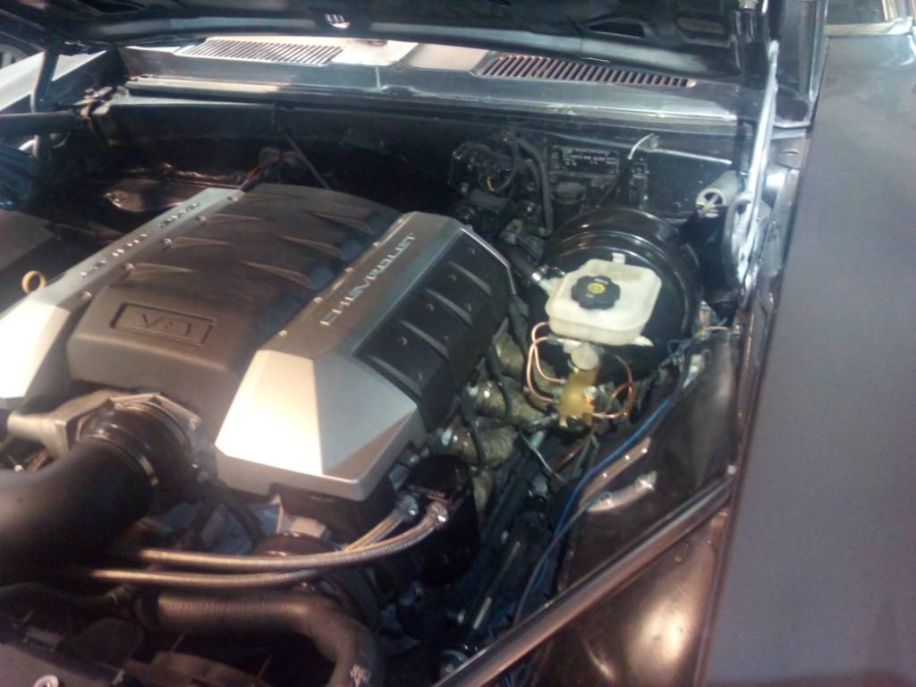

      Booster and brackets almost ready. Tomorrow brackets are ready and try to Bolt everything together and after that bleeding etc. Gonna show pictures after The swap.
      Have to weld new brake pedal brackets also to get adjusting nut etc

      Heres The swap picturesName:  IMG_20190824_172847.jpeg
Size:  69.7 KBName:  IMG_20190824_172852.jpeg

      Well i swapped The lines yesterday and now it Works really good! Front ones locks first as IT should. Stopping Power IS awesome!
