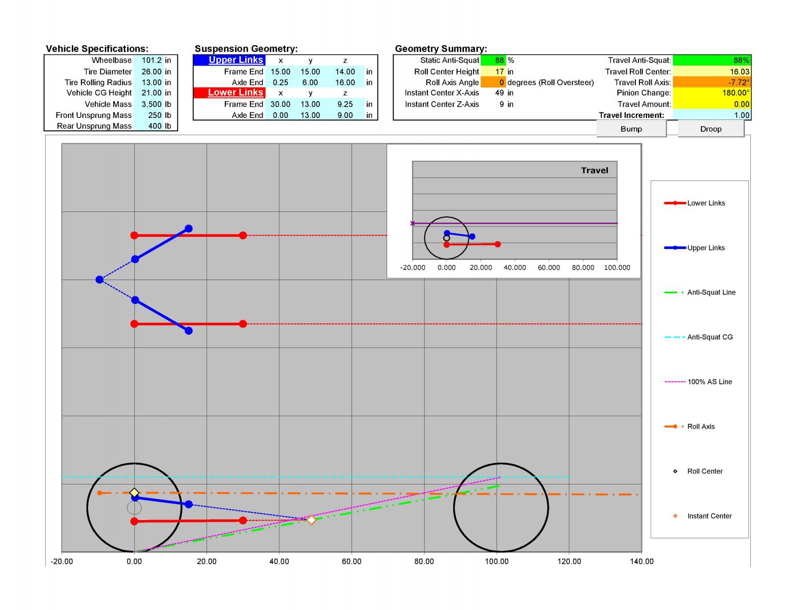

      Currently building a E30 BMW as a Street car with occasional track use. From my understanding im supposed to aim for 60-80% anti squat with 80-90 preferred. i currently made something that gave me 88% anti-squat and 0 degrees oversteer. Now the triage program shows -7 degrees Travel roll axis. what does that mean? Does that refer to as Understeer? Name:  4Bar.jpg
