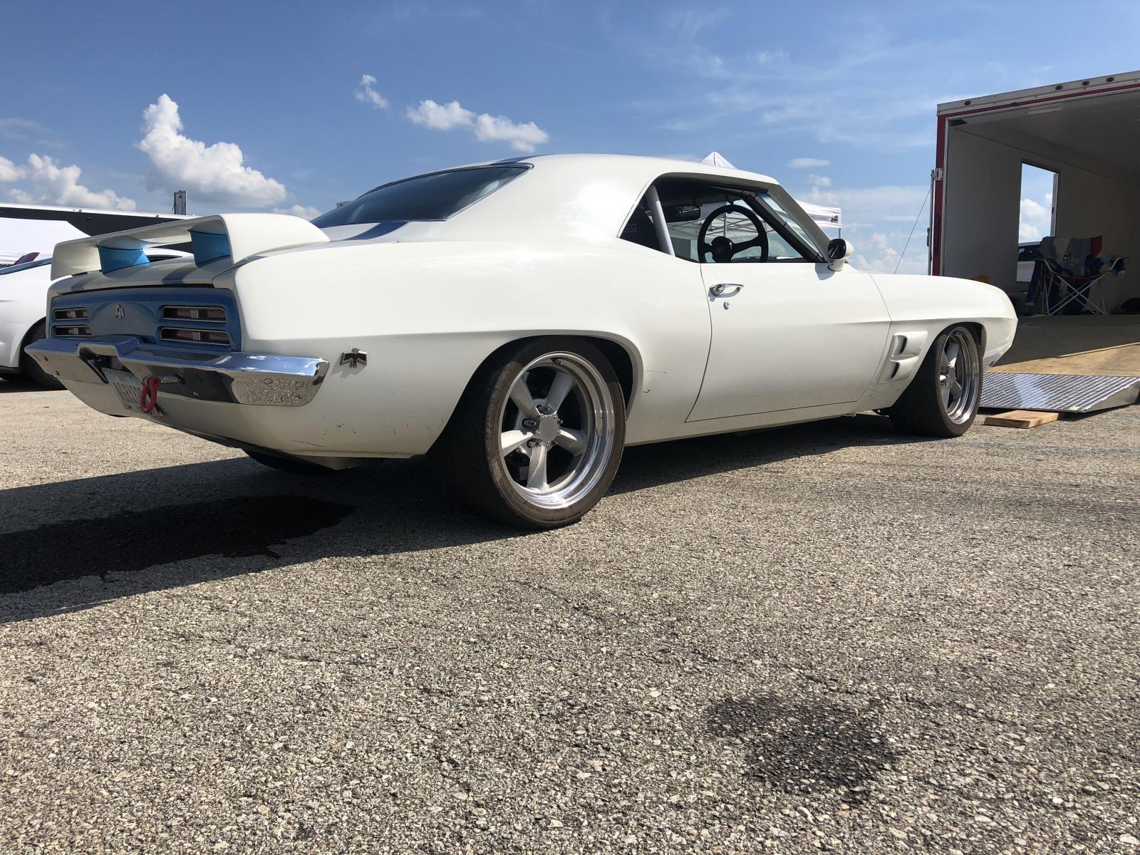

Size:  423.3 KBBrake pads worked great! I think they are actually putting out less dust than the BP10’s that I was previously using. I didn’t notice any fade even at the end of a 20 minute session. Combined with the DSE booster-master combo, the brakes are 1000%better than the last track day, and I also like the feel on the street better too. I am getting moaning/rubbing sound from the rear pads when I am not moving very fast...almost like a vibration induced noise. Ideas? I was also trying to tweet my brake bias throughout the day as well...any pointers on that? I’ll post up a pix of the rear rotors.

      I just went through your build thread-great way to run out the clock on a slow friday! Great build, and your other toys are awseome too! I am trying my best to get to Autobahn for the Sept 8th event, but I am a little worried as my front discs are only 11'' with the BP-20's. I'm curious how big your rotors are since you can make it through a session without any fade and no cooling?

      I believe the turn signal opening helps with air flow to the brake area. I haven't hooked up any hose yet, but it sitting on the shelf waiting. My rotors are 13" Spec-37. I'm also using Motul 600 fluid. I checked some lap times from my Harry's Lap Timer ap and I am running IDENTICAL times to my '15 Z/28...2:57. I know there is more in each car, but I like to load up the cars in one piece at the end of the day!
