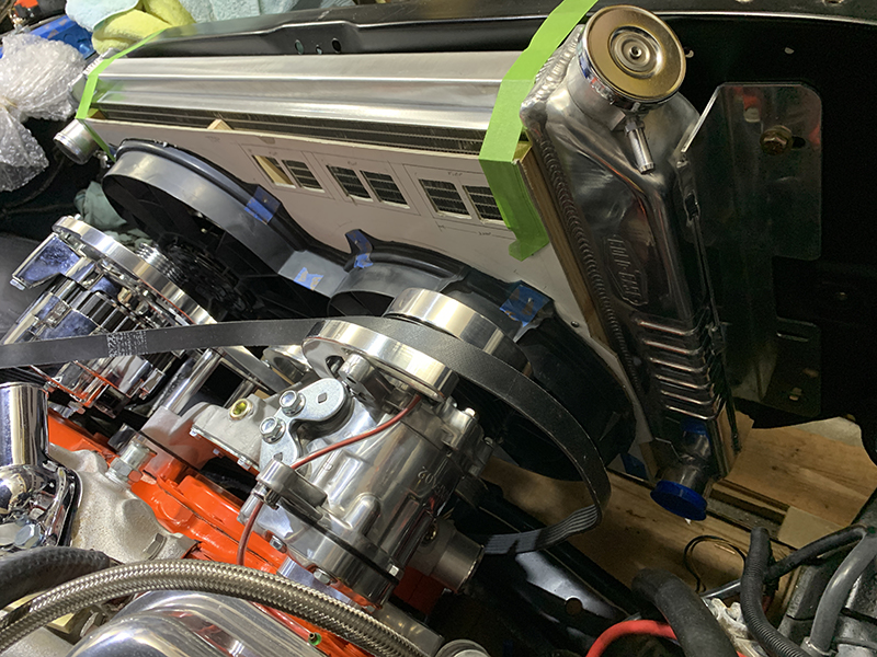

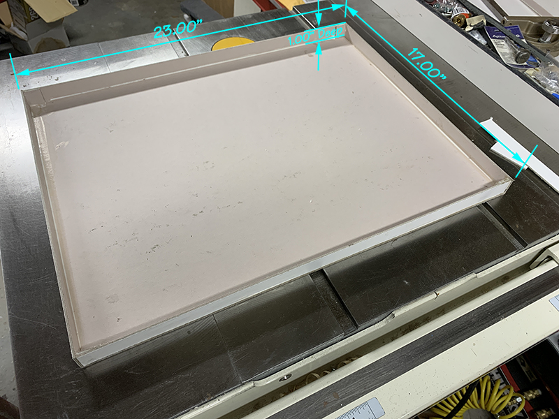

      UPDATE: I bought a Cold Case 2-Tube (1.250" tubes) BBC radiator and I think I'm going to try and fab up my own shroud. I'm laying it out in very stiff illustration board, eventually, probably 16 or 14 gauge aluminum. I also have been doing loads of reading on DIY setups, and discovered the Ford designed Volvo fan which is a kissing cousin of the taurus fan but its built as a bolt in fan without a molded in shroud. Thats supposed to arrive today.

      Unfortunately, I'm not working as fast on this project as I'd like... too many "Honey Do" projects including remodeling two bathrooms. Anyway, I have progressed a bit. I opted to model my shroud in 1/8" thick rigid illustration board. Switched over to a dual 12" fan setup from a Ford Contour/Mercury Mystique. The original molded-in shroud was too big so I decided to think outside the box and cut away the shroud. Still messing with the precise angle, but the fans will be mounted diagonally so as to clear my AC pulley. I'm gonna try to squeeze in more flaps, hopefully wind up with 10 or 12.
      Name:  Test Fit-02.jpg
      Name:  Test Fit-01.jpg
      Name:  Test Fit-00.jpg

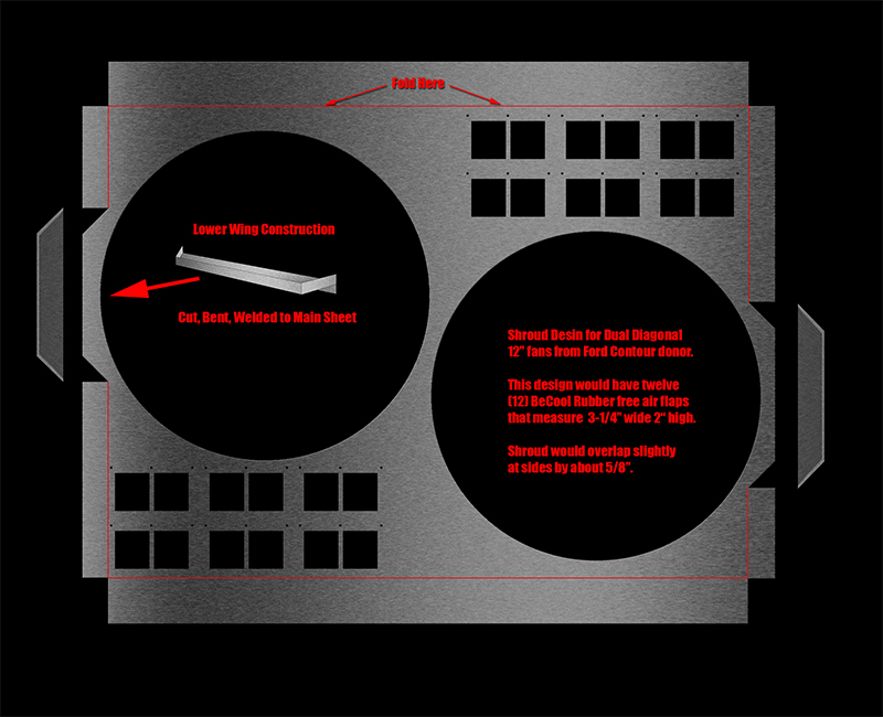

      Ugly, but you have to start somewhere. Fitting looks good so far, actually have 1/4" clearance at the AC pulley, swing the compressor away and the fans mounted to the shroud slide right up easily as an assembly. Making a new main board to see if a little tilt will allow another row so I'll have a dozen rubber flaps. Here's my goal.
